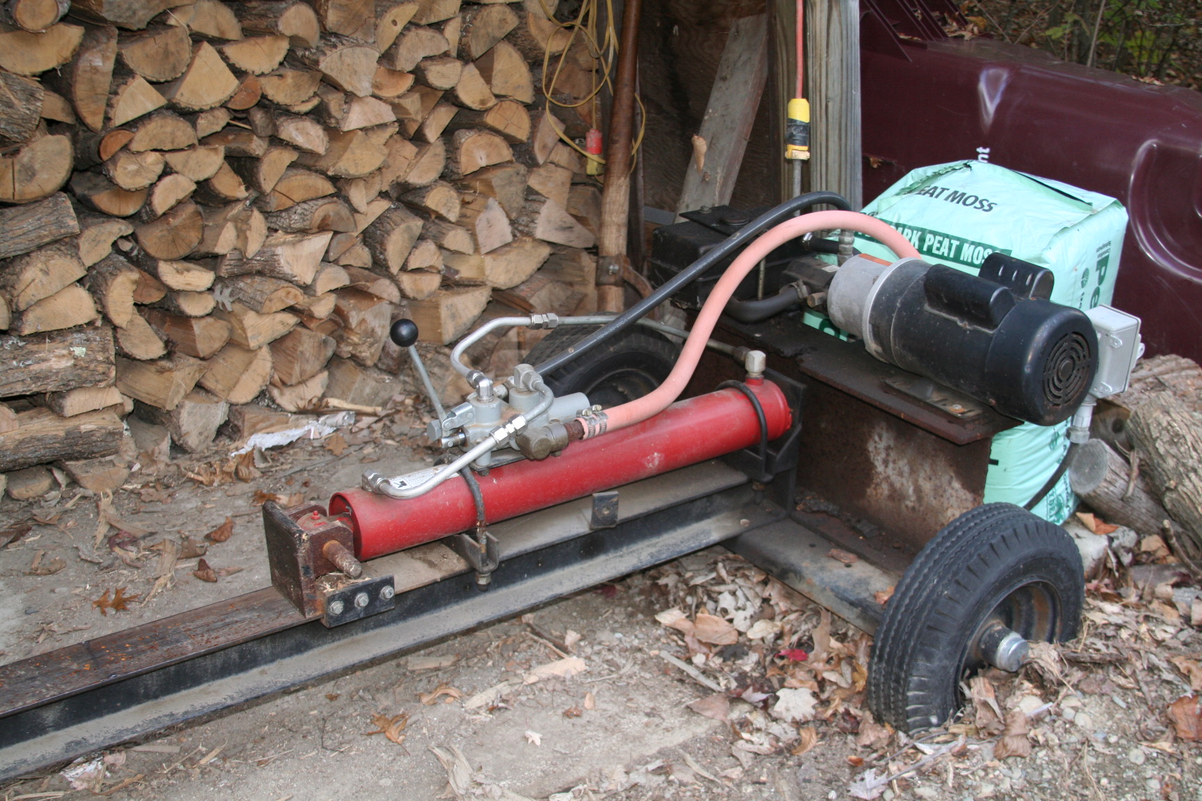

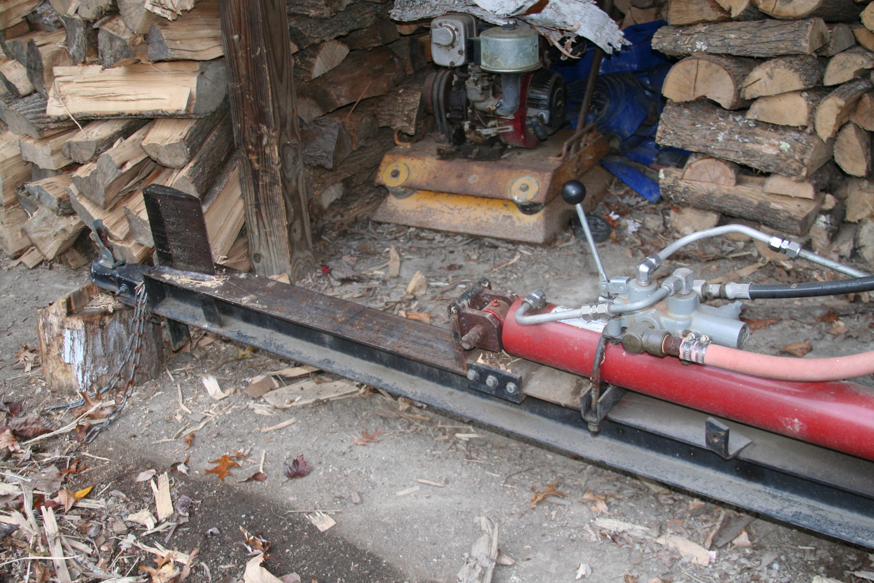

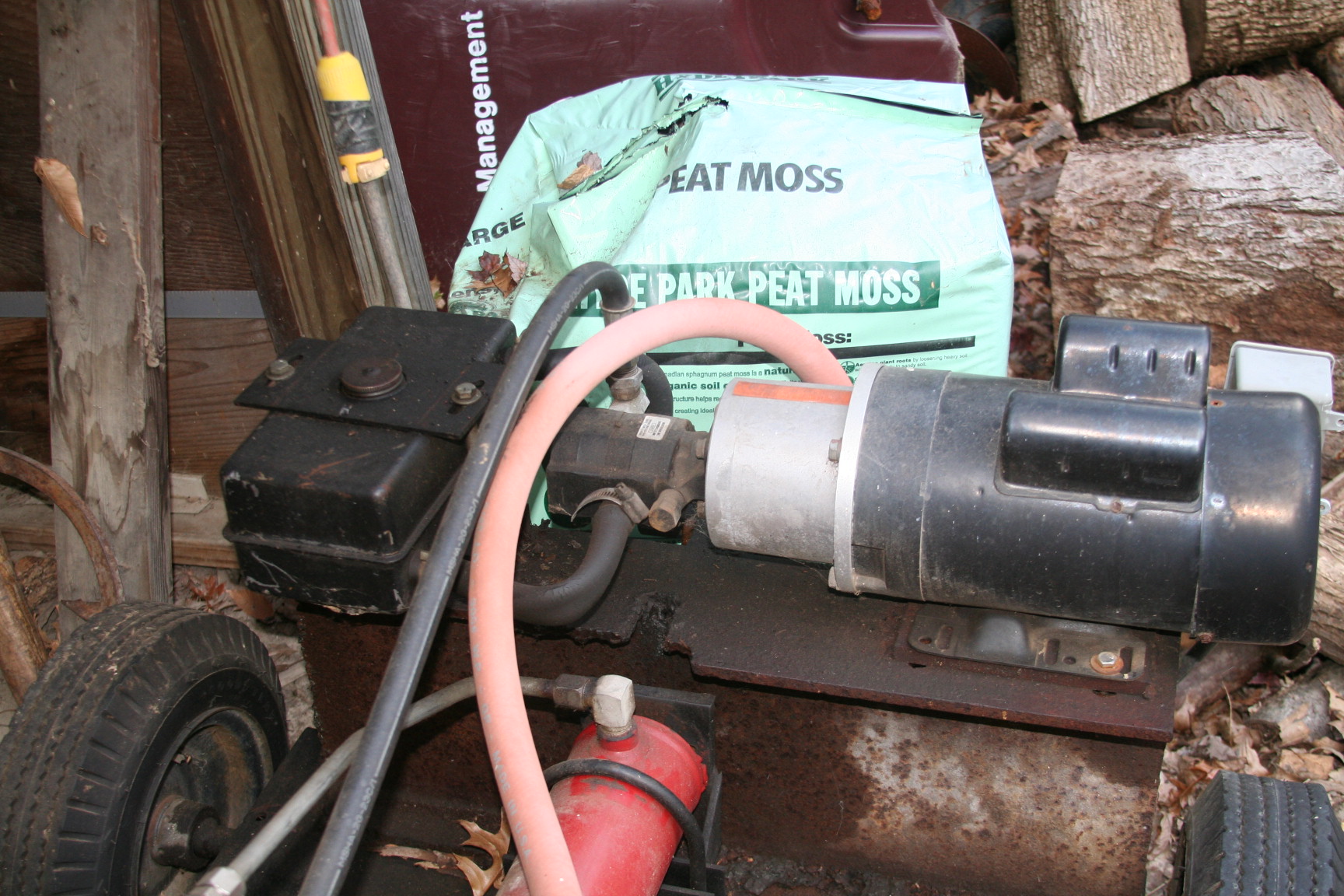

I got really tired of piston maintainence and converted my log spitter from a 5hp B & S to a 2hp electric. It was a commercial unit from Agway I think, I got it used. Added a filter , behind the motor, old cylinder leaked and new seal did not fix it. New cylinder. All the parts are from NH.
Swapped out the valve for a log spitter valve with detented return. I had a pervious one with detent both ways but it made me nervous. Accidents are not planned and they happen faster than you know.
It splits every single thing I have ever put in it up to 2' diameter. Have to be smart around the big ones and work the edges a bit. I put a thumb on my FEL bucket to lift in the big ones but rolling them up works better with a cant hook. What would really make it work is a shelf on each side , easier to get the big ones back for resplit. Also wings 1/2 way back on the wedge really works well. It is the two stage pump that makes this all work.
Motor is 220 . 2hp 3600 rpm.
Trade off is I take it all to the wood shed before I split it. But all my wood is on my property.

Back to this log splitter issue...The lines are steel but have some sort of copper colored paint on them. I guess it did work well for many years. And it does have a filter! Never saw one like this before, as it has a dial indicator on the outside showing when it's cleaning time!! The cylinder base was swapped out to a 2" thick steel plate. It has MANY holes in it! No idea what it was originally used for, but it works well for this application. Much of the plumbing goes to this plate. It's a very heavy beast and VERY well balanced.
I agree with the idea of having wings straddling the cylinder/wedge guide. Also some wing extensions past the wedge is a must. Wish I had an extra cylinder to work a wing lift. Now THAT'S the ticket! Maybe in the future I can fab one up.

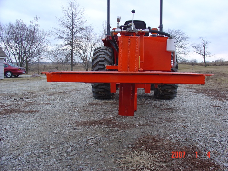

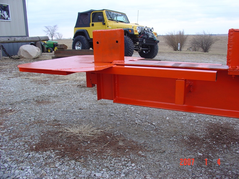

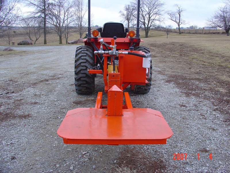

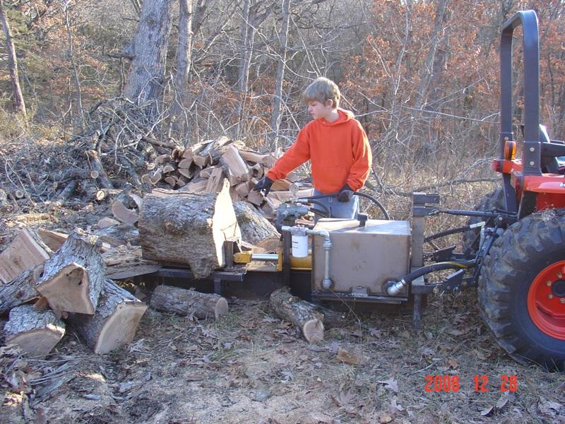

In regards to the wing issue. When I built mine I wanted a platform to catch the split wood. Also wanted some sort of wings along the beam to make it easier to hold a large log on the splitter. I made mine flat with the beam and still catch the table occassionally with a very big log so I'm glad I didn't raise the wings or angle the platform. My platform is removeable and uses square tubing of two different sizes so you simply pick the platform and wings up in one piece and they come off. My platform could be a little larger but I didn't want it to interfere with splitting from either side. Here's a couple pics for ideas. If you look at the last one you can see that if I had angle my platform or built my wings raised above the beam I would have had trouble with this log.
