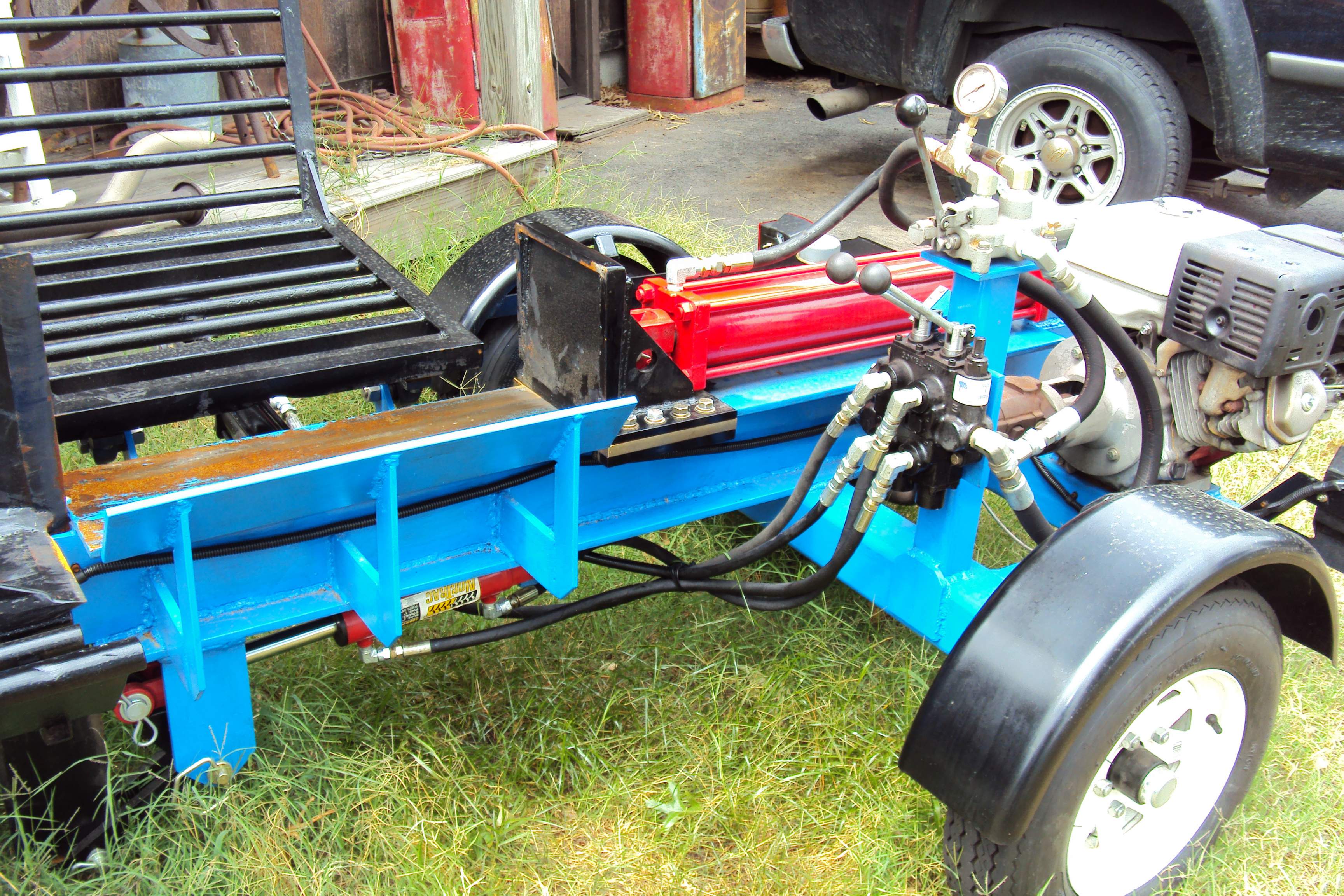

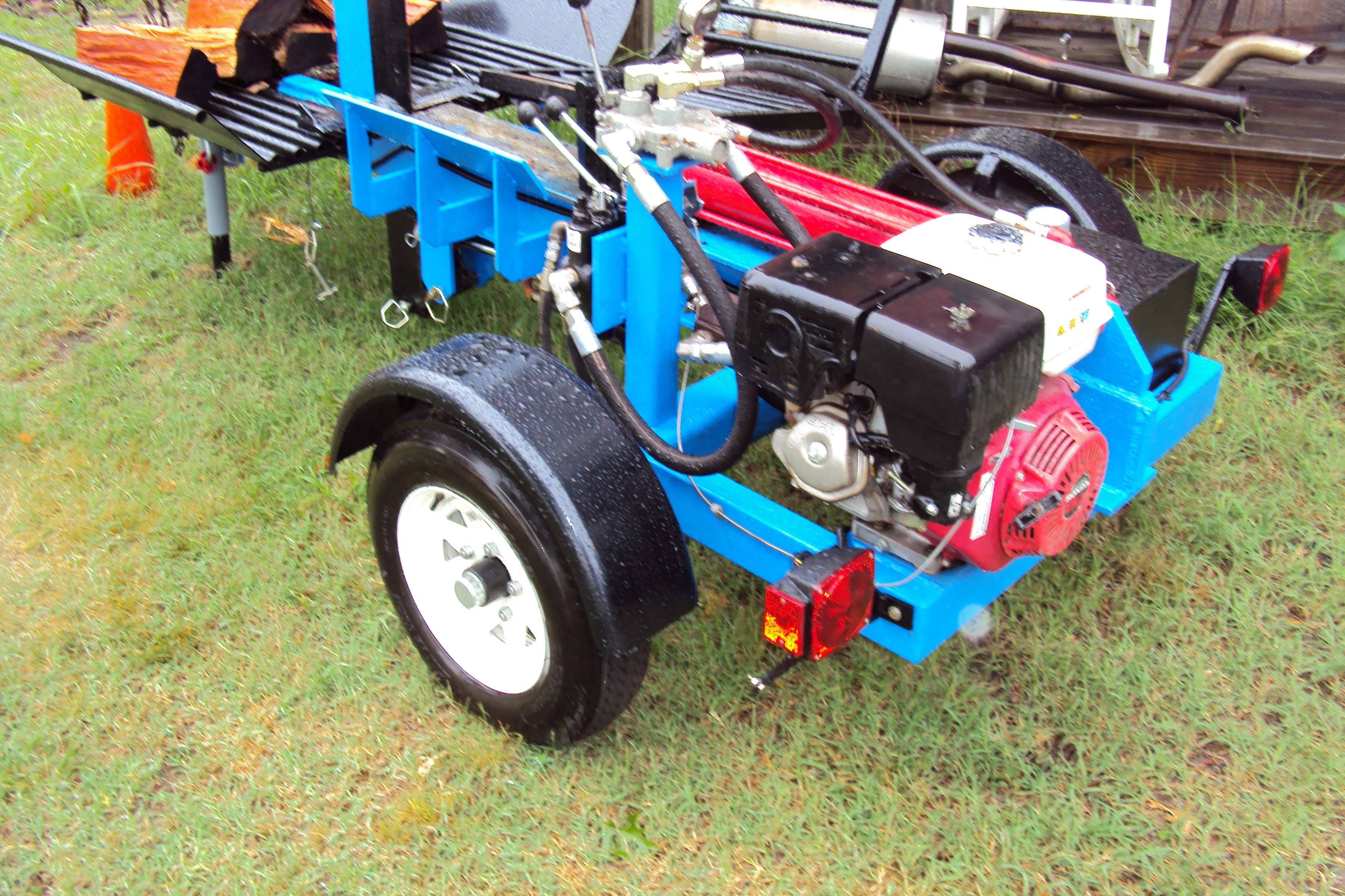

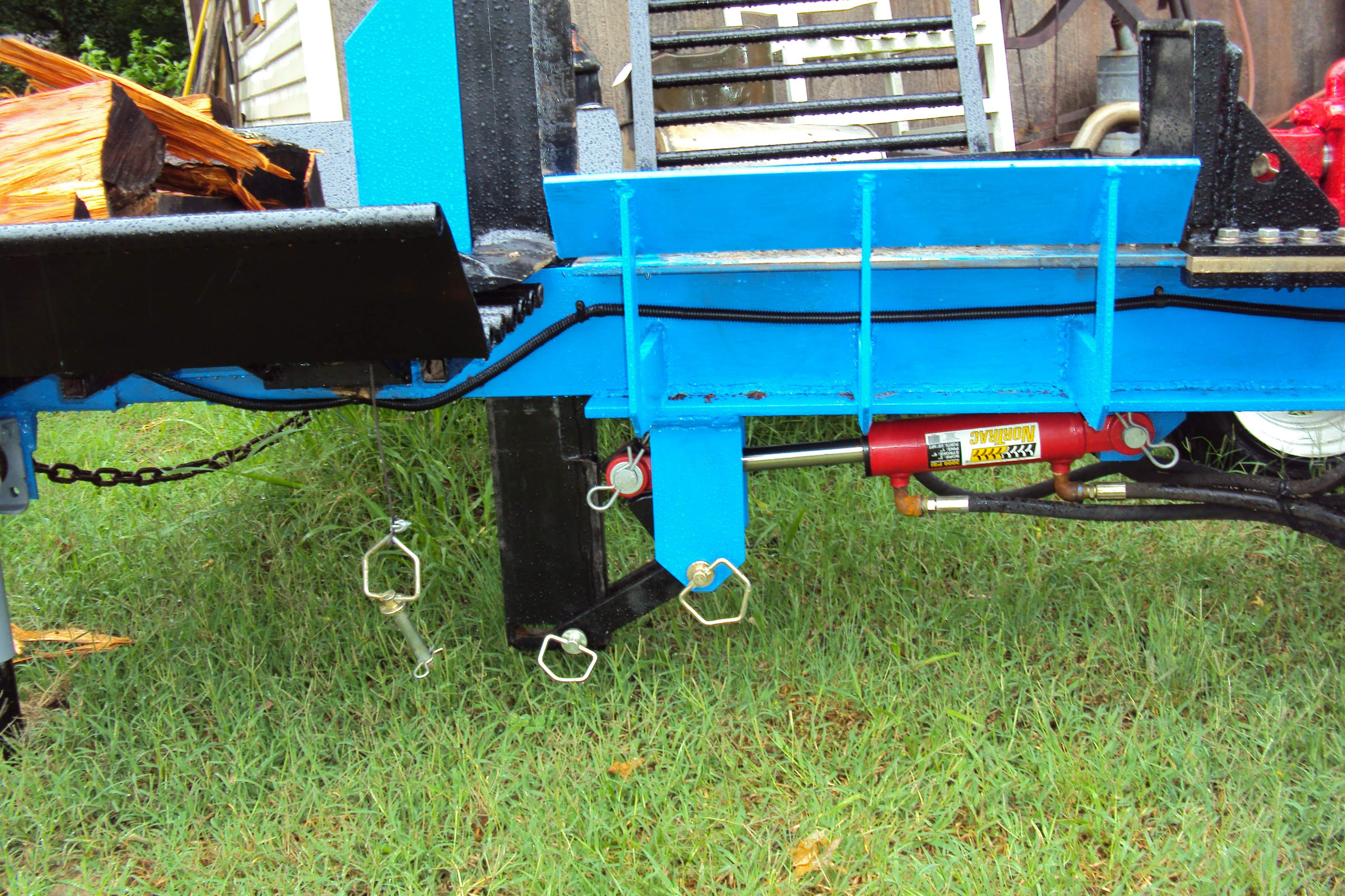

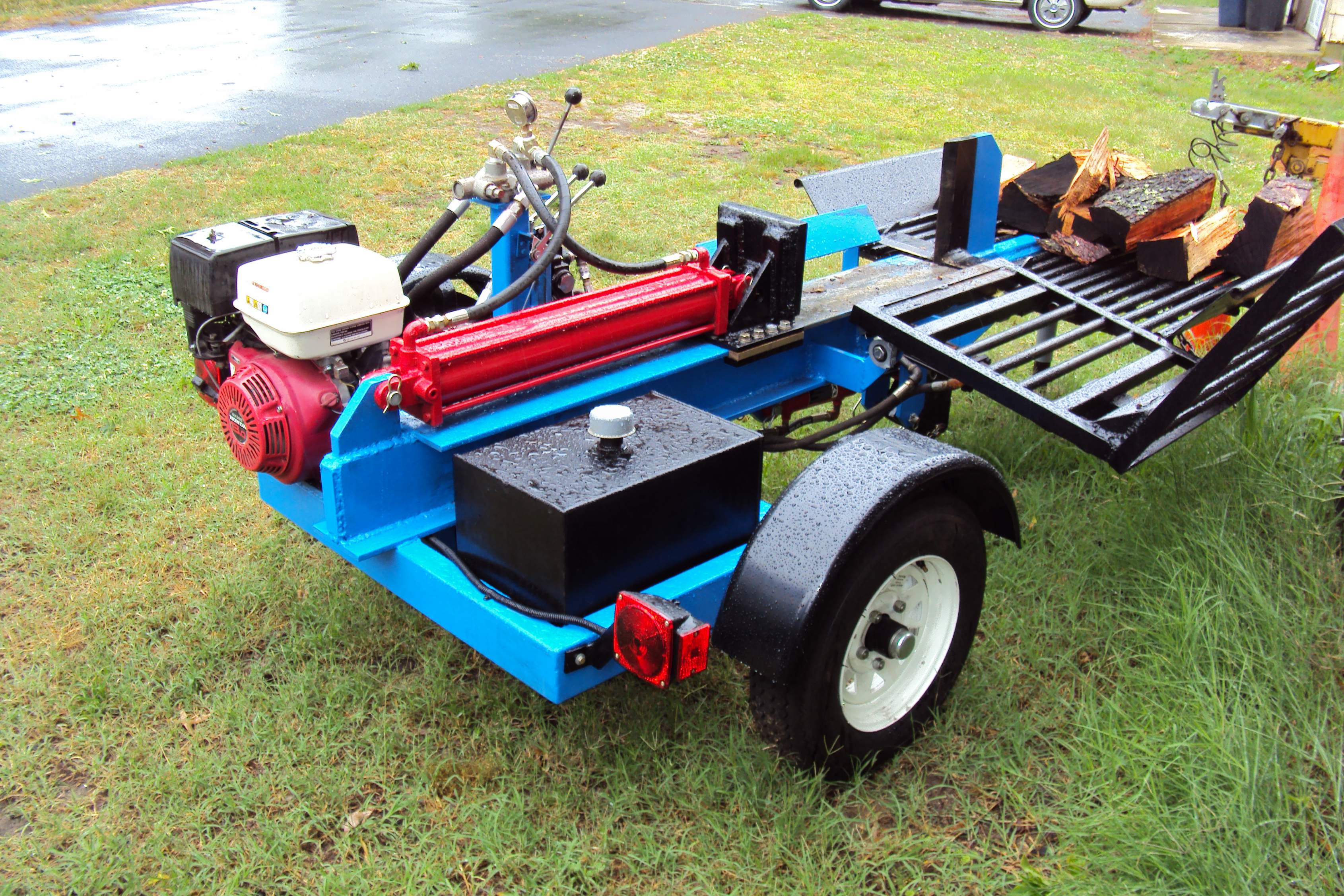

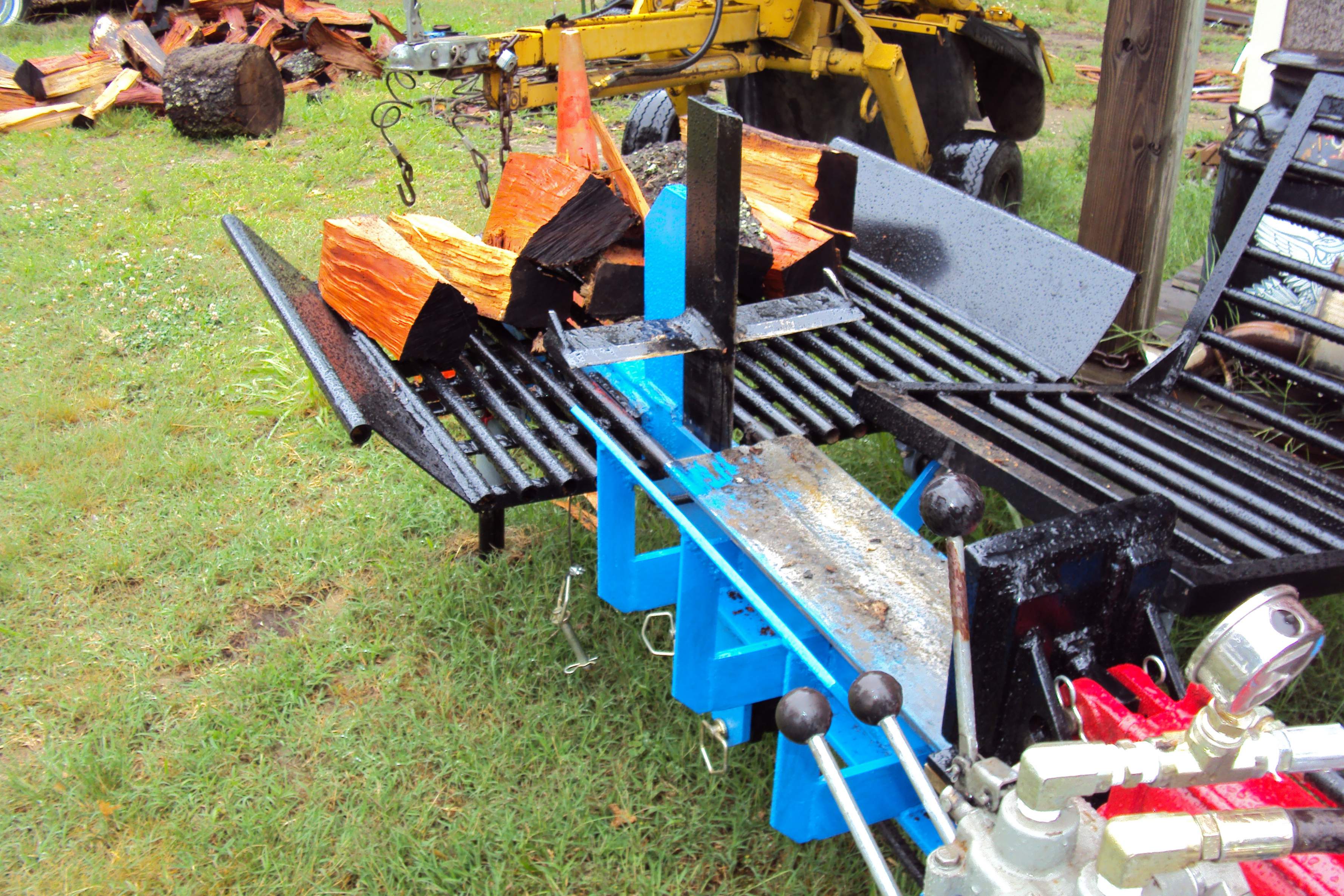

Finally got it painted.
   / Log splitter with lift table and 4 way wedge #14
Just don't understand why you built something nice, and put galvanized water pipe fittings in the hyd circuit.
Recommend you replace them with hyd fittings.
#15
JJ, I just haven't gotten to that yet, but i will getter done. It's hotter up here then it is in Jacksonville now. Have a nice day.
   / Log splitter with lift table and 4 way wedge #16
J_J is never freakin wrong! I swear the man is a plethora of info
and he calls a spade a spade...LISTEN TO HIM, NOW!!!
What is the rating for a 1/4 or 3/8" Mallable Street 90 J_J ? 150 Pounds?
Be VERY careful till you FIX It bro.... I am a plumbing contractor,
I have seen HOLES no less in mallable fittings! BELIEVE IT. You could build
pressure then POP, and you could get a 2500 PSI hydraulic fluid
squirt to the inner thigh and the twins are now quads...BELIEVE IT .
GAWD DO NOT DO IT PEOPLES!
Nice Splitter BTW...
   / Log splitter with lift table and 4 way wedge #17
One pin hole and hydro. fluid is enjected under the skin and you have a trip to the hospital and a while to stay there as well. hydro. oil is very poisionous and you DON'T want that to happen. Dont even crank the engine with those fittings in there!!!
   / Log splitter with lift table and 4 way wedge #18
Sweet build !!!!!!! I would strongly agree with changing those pipe to the proper fittings, there cheap. Wouldnt want you to lose an eye now!!!
   / Log splitter with lift table and 4 way wedge #19
Your splitter looks great...but those pipe fittings are a death trap!
thanks
#20
DSC00093.jpg Just got new hydraulic fittings installed. Video will be coming soon.
