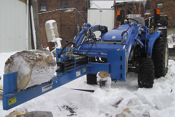

I just bought a unit that attaches to the skid steer type quick attach plate on my FEL. I run it off my exsting FEL hydraulics. The 3pt. variety seemed more limited and would have required an additional hydraulic line. It can be run horizontaly or near vertically. Additionaly it can be stationed at any height - even in the bed of a truck. I can install or remove the splitter in 30 seconds so it isn't inconvenient. Cost me $625 new delivered.
/ Log Splitter #26
What brand is your splitter, where did you get it & do you have any pictures of your setup ?? I'm not familiar with a setup at the FEL using the hydraulics from the FEL.
/ Log Splitter #27
http://ramsplitter.com
I bought it from them through ebay. 15 bucks less than listed on their own site. They come in blue, green and orange to match your ride /forums/images/graemlins/cool.gif
Position the unit where you want it, disconnect the bucket hydro., connect splitter and apply bungee cord.
/ Log Splitter #29
I've never seen a front mount splitter, SWEET!!!!!!
/ Log Splitter #30
That looks like a weapon. Really nifty. I can see some advantages to your set up, but I must say, it's just looks terrific.

Good idea on the FEL that way. I like to use my tractor for doing other jobs around the splitter while splitting, such as bringing the 'large' rounds over to the splitter at the right height to just roll them onto the beam. Also, sometimes have the pallet on the forks to load with split pieces right off the splitter, then move the pallets to the drying space for 2-3 year storage.
I have seen splitters on the front before, but upside down. Then driving to the 'round' to drop the splitter over the top, split from the tractor and move to the next one. For the large 'rounds' that I went through last month, that would have saved some time not having to roll them into the bucket to lift them up. Of course there are the ones that tip up vertical to split the big ones too. Lots of choices, but usually only can have one of several options.
I posted a pic of yours with some reduction in size to reduce them to fit on my screen. Don't have one of those 'big screen' monitors. /forums/images/graemlins/grin.gif
