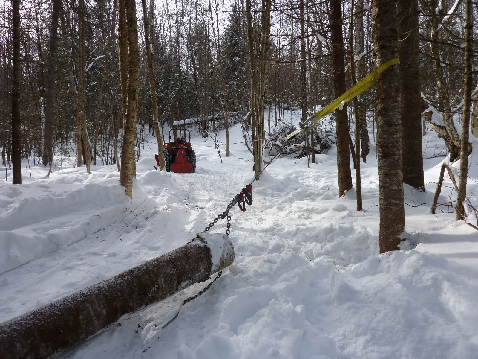

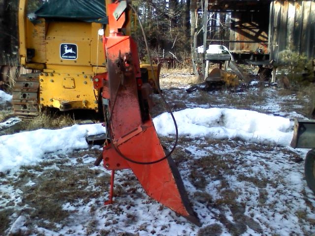

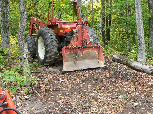

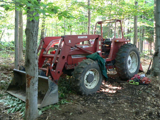

I have a Farmi 601, that was previously owned by at last two members here.
It is a beast and well sized for mounting on my 100 hp Hesston. I bought it used at a fair price which was less than a new one with a 3rd of its capacity.
I did replace all the bearings in it. The result was well worth the time and $. I think I spent a couple hundred on all 4 bearings.
The thing about the dozer blade farmis is that they are a winch AND skidder in one. You winch the log up close, raise the butt off the ground, lock the choker chain into a slot on the skidding frame. Rince and repeat up to half a dozen times. Raise the TPH so the dozer blade is off the ground and skid away.
This thing is an awesome tool. I personally put up 20+ cord a year and couldn't do it with out this unit.:thumbsup:
Moral of story is find a used farmi....... they are bullet proof.
