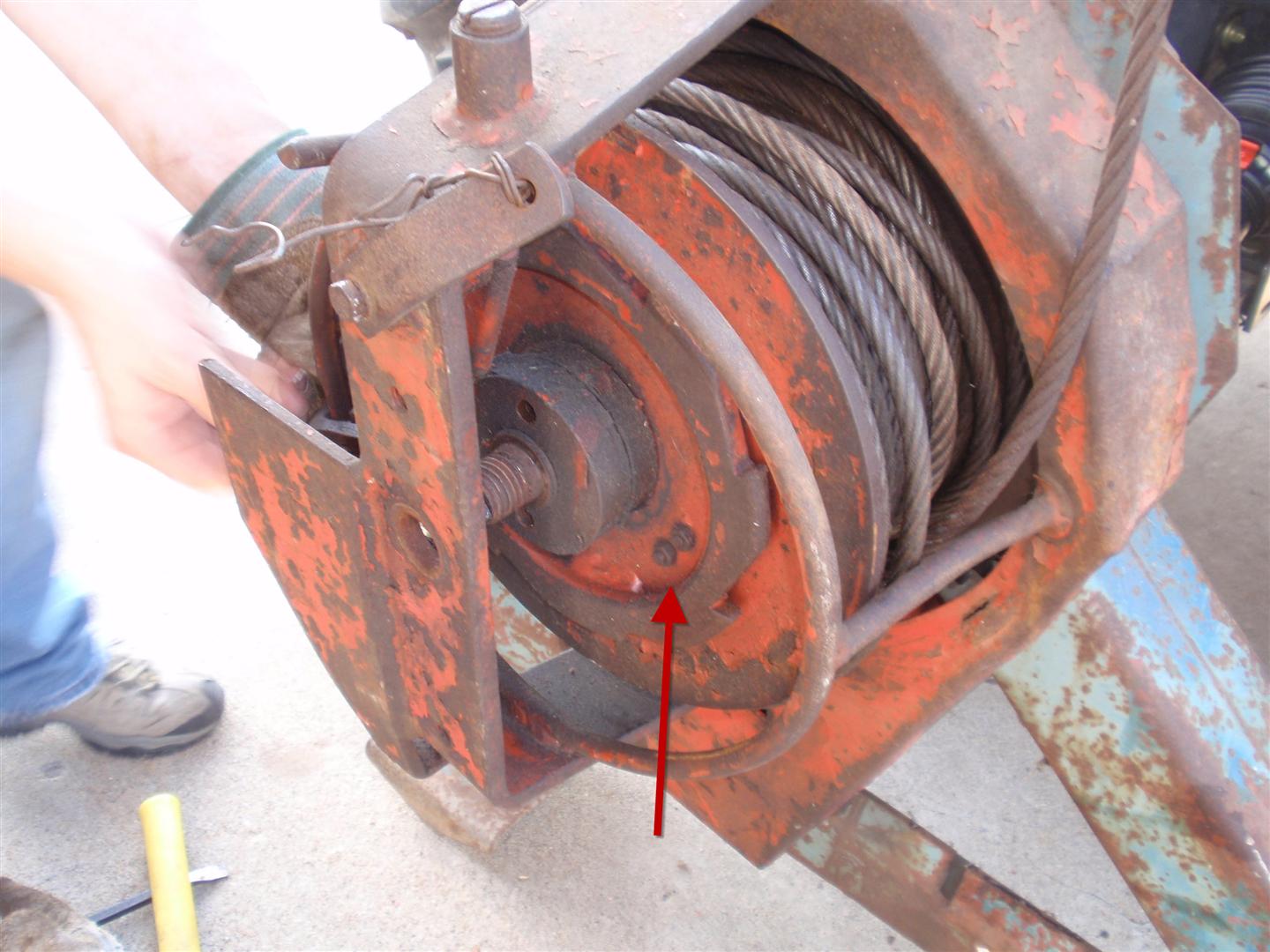

If it is like mine, it uses a U-bolt to secure it through the face of the drum. In this pic you can see where the legs of the U are bolted through the face of the drum. Mine broke and I had to find a new one, which I got from the hardware store. It did not fit well as I am sure the original is metric, but I was able to bend it enough to fit. If you have the time to get the original size, that would be best, IMHO.

Dave--thanks for the helpful picture. My Farmi doesn't have any means of locking down the cable end before starting to spool in the rest of the new line. Yours looks like a possible solution to that. I'll have to see if I can drill through the thick drum plate and get a u-clamp that will fit just one layer of cable.
Use a wire rope clip of the correct size and remove the saddle, just use the u-bolt.

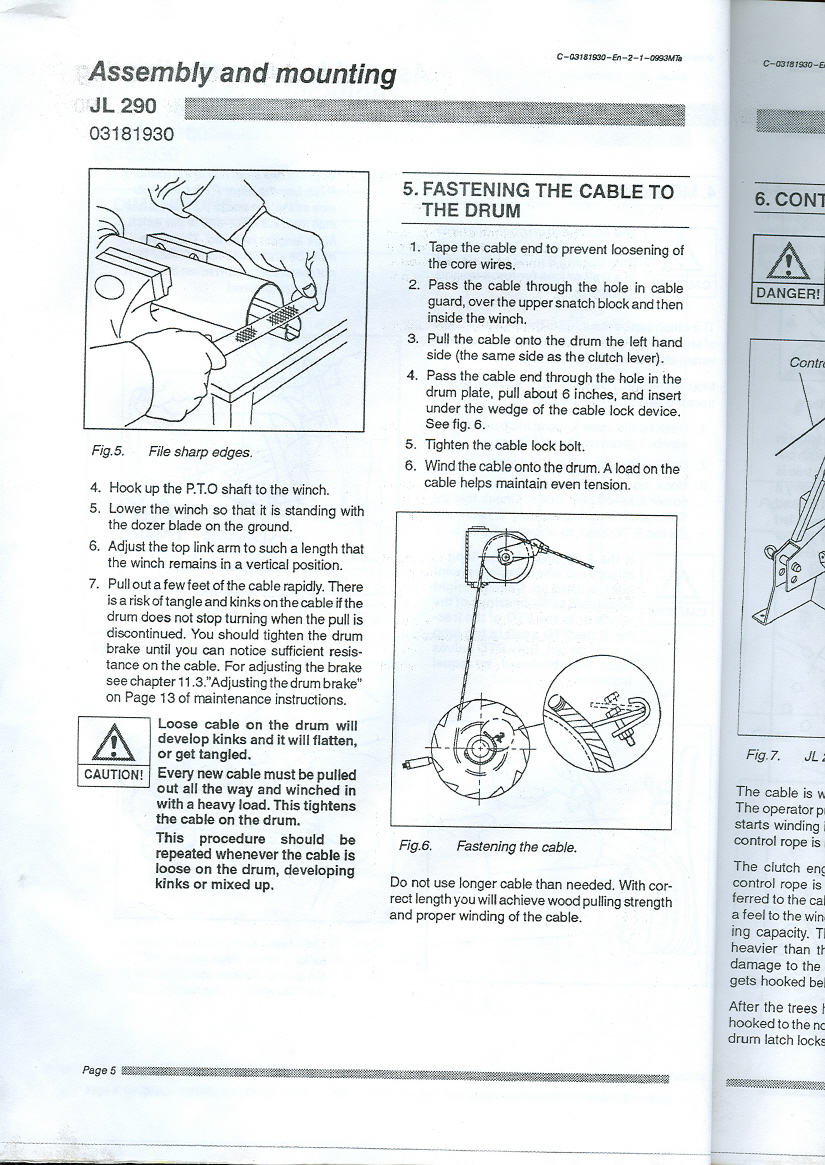

On my Farmi there is a heavy cable clip on the outside of the drum, the surface facing tractor when mounted. There is a hole in the drum. Pass cable thru hole to outside drum, wrap around shaft hub 3/4 of a turn and capture with clip. Here is a picture from manual, Maybe yours is like this also.
You may need to enlarge to see.
That would work well, especially if you have to drill holes for it, as you can drill to fit. The OP should still find out the correct procedure for the unit...

I have an older JL 306 made between '79 and '84 I believe. It doesn't have any mechanism to attach the cable to the drum. There also is no complete manual available from what my local (Northeast Implements) parts source says. They have patched together some pages from manuals but there is no page dealing with attaching the cable. Also no info on servicing the drum and main sprocket bushing/bearings which is a whole other story.
It sounds like my best bet is to do the drilling procedure for the U-clamp bolts and leave the saddle off as suggested. Thanks for the advice everyone. Now for a post on another problem I'm having with rebuilding this ole timer.
