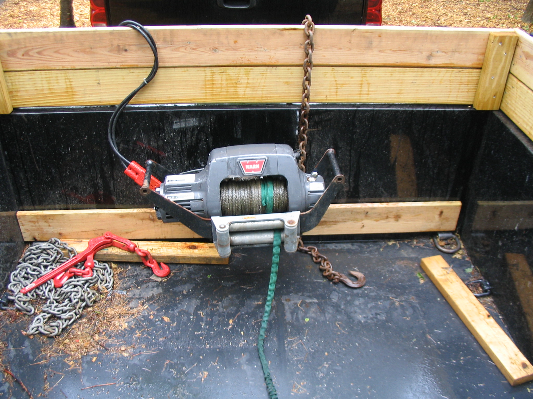

If you have a solid Pick up and able to get remotely close, then buy a portable winch set up for your truck reciever.....I recomend the synthetic winch line too... No meat hooks,(loose strands) doesnt get jambed and no bird nesting...Its also got a hight BS for the same size as steel cable...I use a chain chocker for the log...
I use this warn 9500# winch with synthetic rope and use the steel cable I took off it as an extension for the really long pulls...
