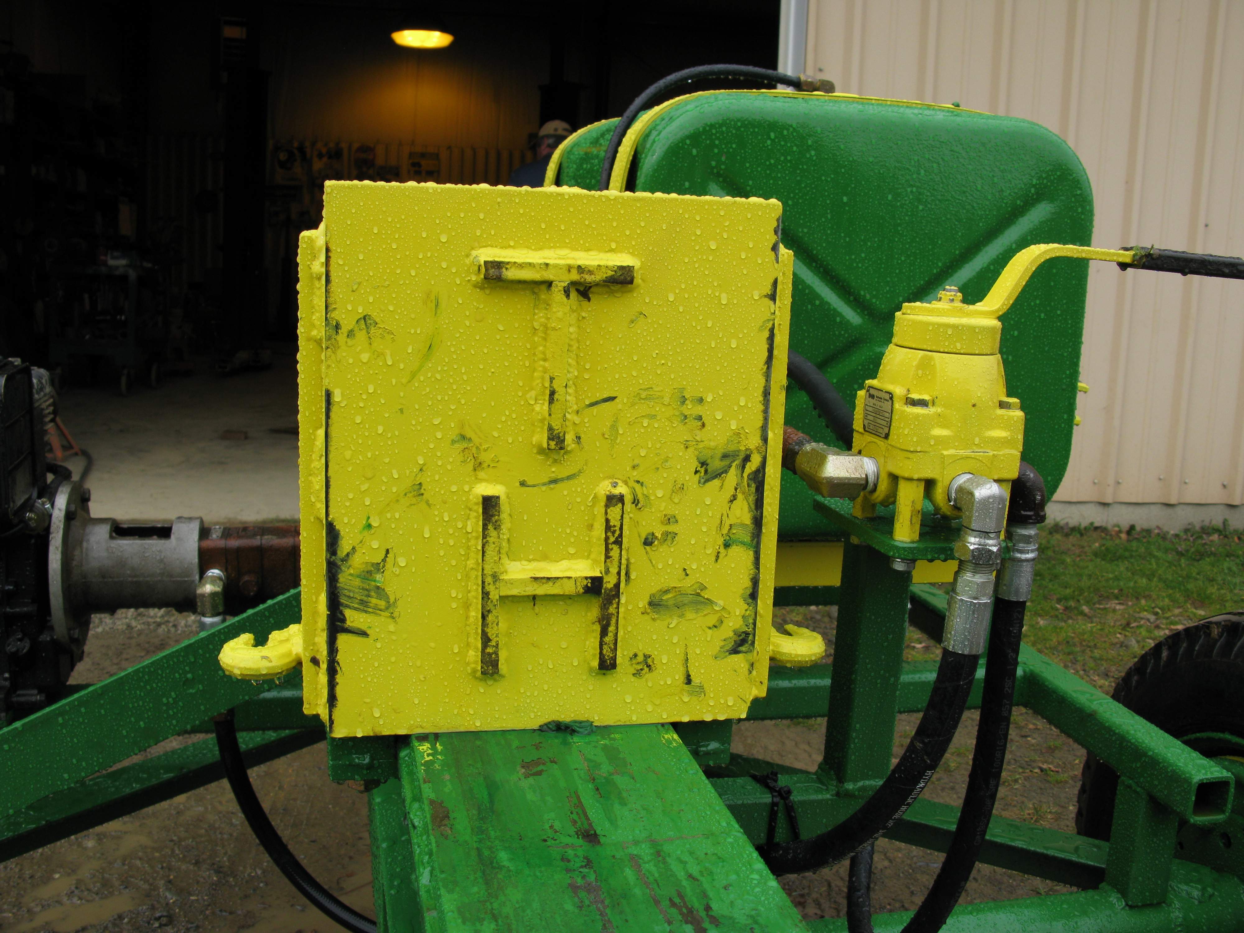

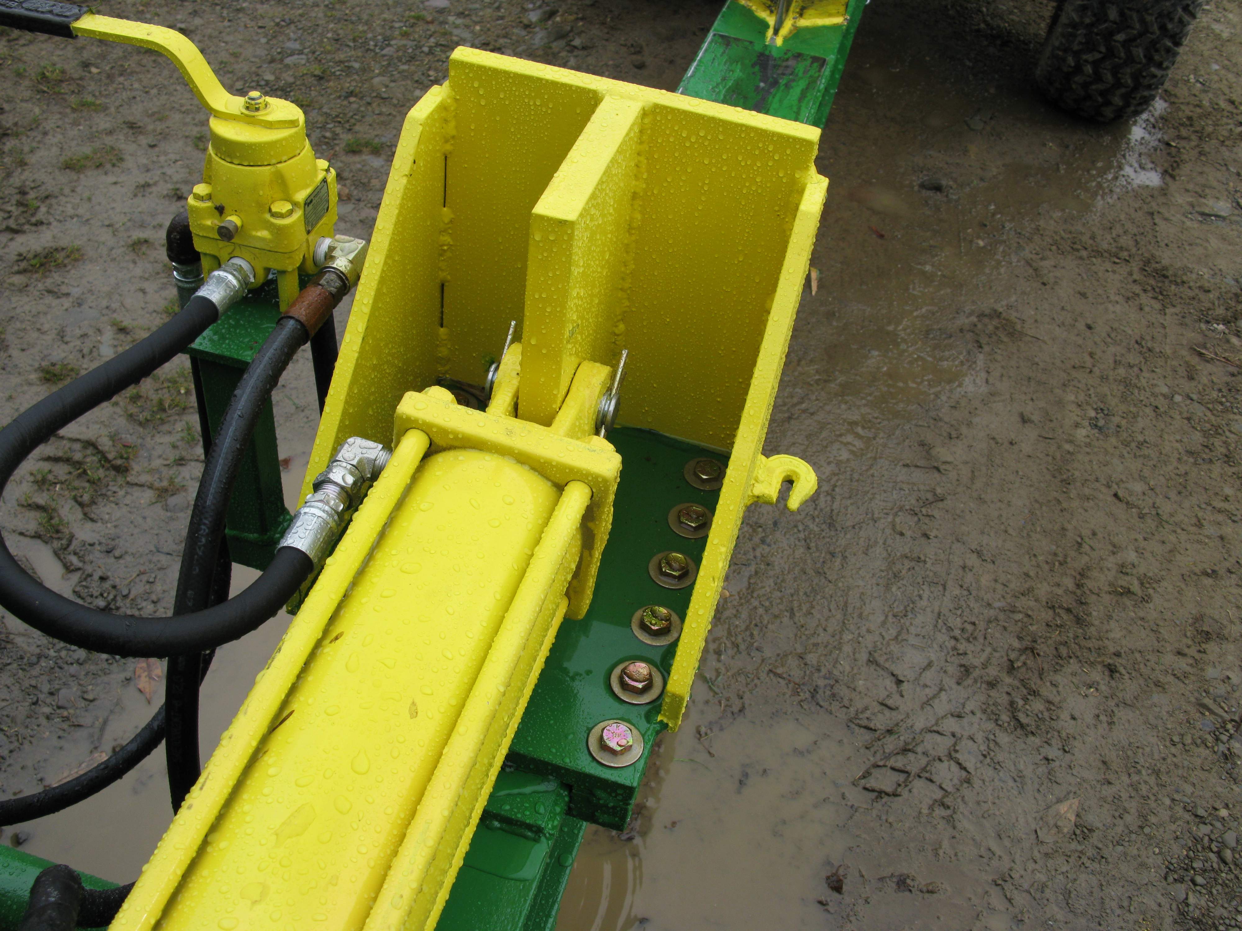

Meant to post these two pics yesterday. They show the plates on the underside of the push block, that capture the push block to the beam. I think the plates are 3/8" thick x 3" wide.
Notice the edge at the very front, where there isn't a bolt and how it's bent down:
The side shown in the first photo seems to be the worst of the two.
I think this was caused by trying to split rounds that wanted to cause the push block to rise up off the beam.
Questions are:
1. How concerned should I be about this ?
2. Should I trim those plates on the bottom back some, closer to the bolts that secure them to the push block ?
3. Do I need to consider using a thicker plate for those pieces ?

/ Logsplitter 2.0 #424
I'd put a bolt in the front and squeeze it back down.
The photos are kind of deceiving as far as the setback of the bolts from the edge ... I don't think there is enough room there to drill a hole and get a bolt with its head (and/or a nut) ... due to interference with the upright portion of the push block.
If memory serves, I think I actually had it drilled for another bolt in the front of the bottom of the push block, but ran into the interference issue and filled the holes in.
In hindsight, I probably just should have ground back the weld a little and went with it.
Or made a better design decision as far as hole placement goes.

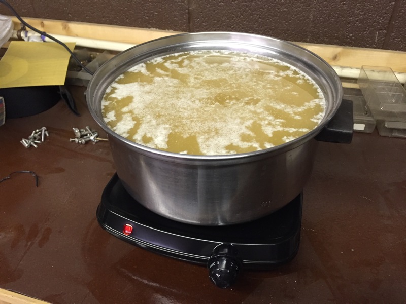

Seems to work:
Required boiling it ... will know more in the morning as far as how effective it was.
This is a pretty dicey operation ... mainly because the bubbling can become pretty violent in short order, as the water turns into steam and expands. Probably need to put a little less fluid in the pan.
Definitely not an unattended operation ...

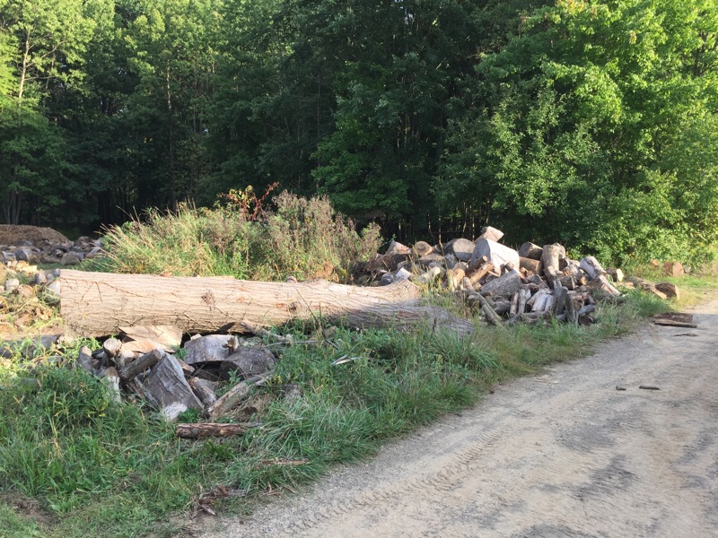

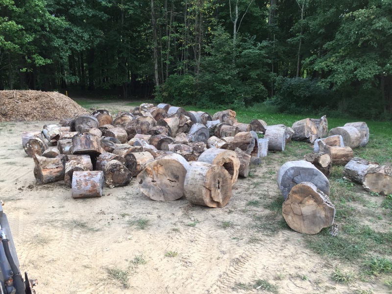

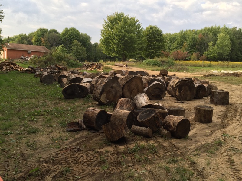

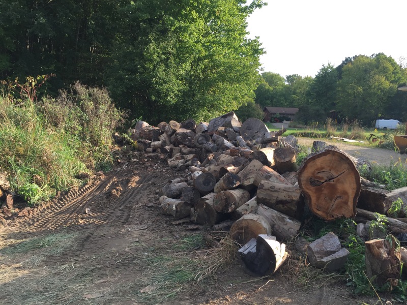

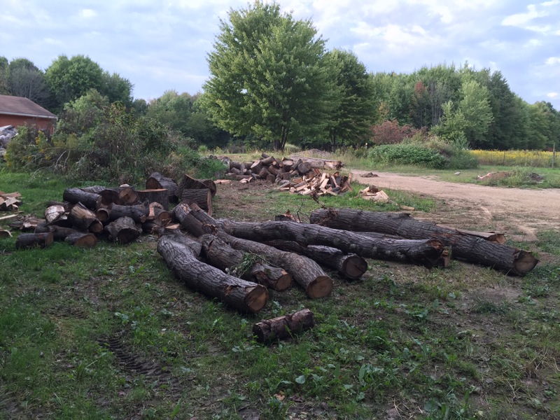

Spent most of the day tearing into the huge pile of rounds:
... and pulling out the bigger stuff and staging it for splitting tomorrow. The two rows on the right are ash, the stuff behind it is sycamore ... there's a few rounds of sycamore that are around 48" in diameter or better. And there's small pile of pine behind the sycamore that isn't visible:
The pine (in the foreground):
Red oak (in the foreground), some of which needs bucked ... and way in the back behind the pile of splits is another pile of smaller ash rounds:

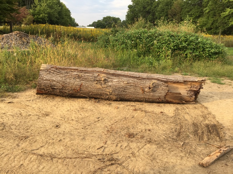

A red oak log ... probably 12' long and 24" diameter. Need it cut in order to move it.
Another red oak log that's still on the pile ... this one is even longer and larger in diameter than the previous one:
