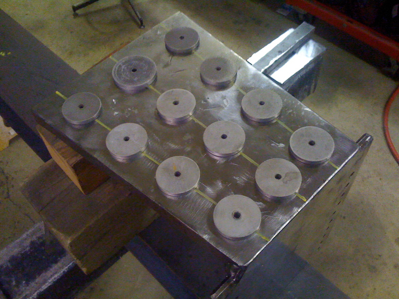

Face of push block with the discs welded on. Still needs a little grinding and clean up ... not the purtiest thing but it should be functional:
Saw one that I think oldtimer posted that used short lengths of pipe on the face ... I really liked that idea ... but had already welded these on.

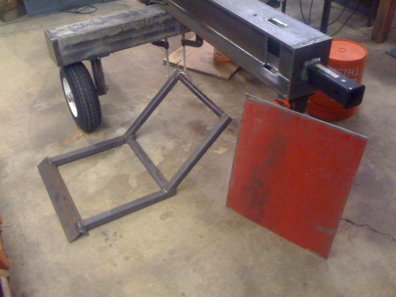

Can't remember if I posted anything on this or not previously. Start of the log lift.
It's made mostly from 1 1/2" x 3/16" square tube ... used some pipe I had for one cross brace. The square tube is attached to the angle on the left at a slight angle ... so that when you roll a round onto it, the round should want to go towards the splitter and not roll off.
The red sheet/plate came from the infeed chute on my chipper (which I'm in the process of widening) and will be used to as part of the "deck" on the lift:
