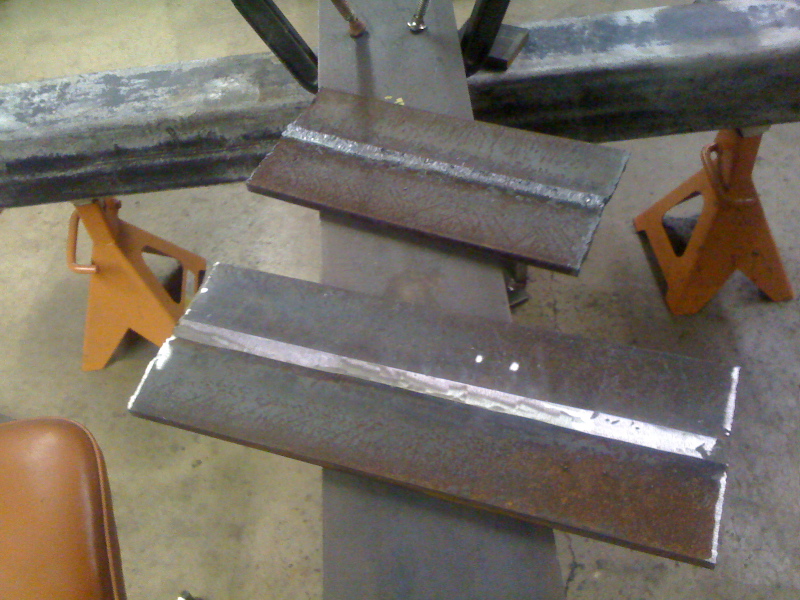

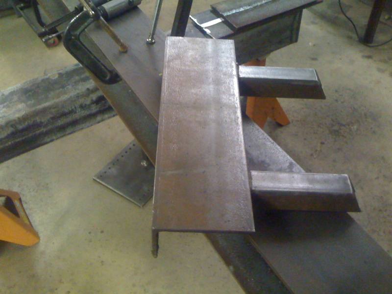

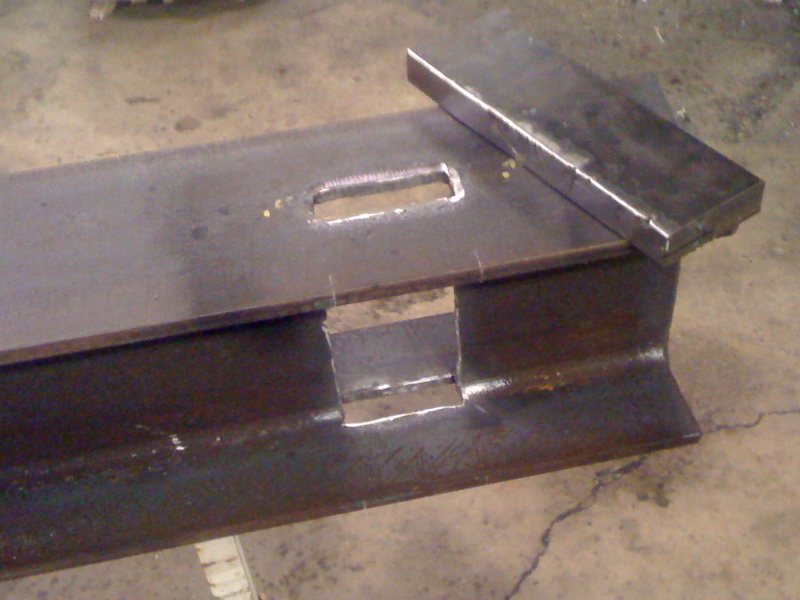

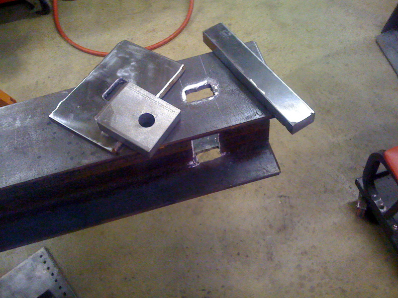

This is a piece of the flange (one of two) from the H-Beam that will be used to "box" the beam in at the splitting wedge. It will also serve as mount for the "table grate" which will catch the the splits after the come off the wedge/beam.
A 5/8" hole was drilled for the bolt in the reinforcing plate and in a piece of 1/2" x 1 1/2" flat stock ... there will a nut welded on the backside of the reinforcing plate for the bolt to screw into.
I then drilled a 1" hole to accomodate a pin which will protrude out from the plate for the flat stock to rest on. The 1" (x 1") pin will be made from a 2" long drop of 1" cold roll solid rod I had lying around.
This will allow the "table grate" to fold up out of the way for transport.

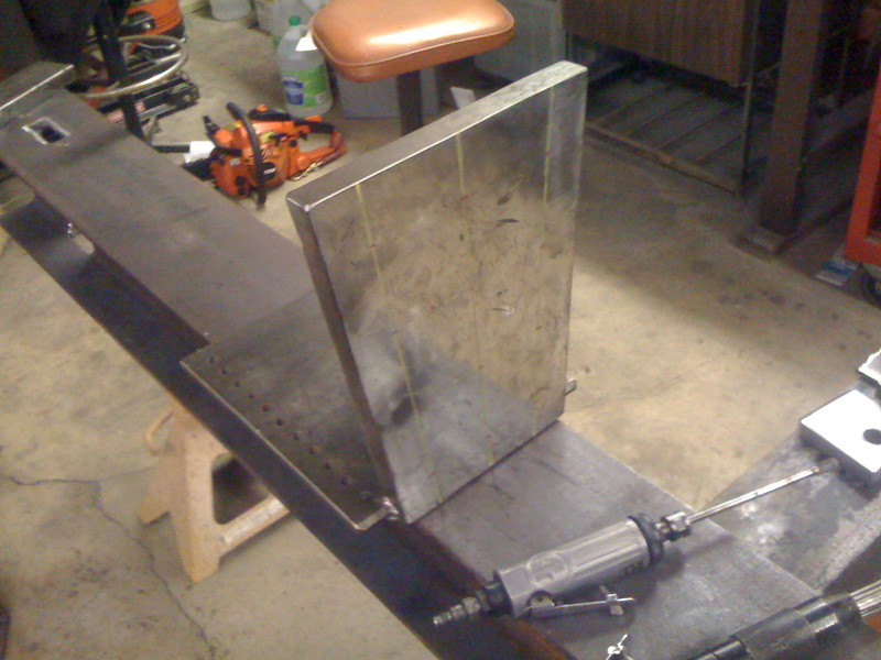

Got the stub axles welded on to the drop legs last night, along with welding the nuts for the table grate mount onto the reinforcing plates. Also did some grinding on the splitting wedge ... still have a ways to go on that.

RSWYAN, some where in this post I thought a table was mentioned, to be mounted beyond the wedge. I added a table Timberwolf to a friends splitter. Then I made the same later because he did not want to shuttle the table between locations. The Timberwolf design has those .38 thick wings that the table slides under and it clips as shown. My friend said that any wild wood heading down mainly using the 4 way wedge will be re-directed onto the table with out damaging the table. And you cannot just paint it you need to "Decal it Up" Just some info. Later.0203101246a.jpg0218101727.jpg0223101533.jpg0223101532.jpg
Very nice work ... :thumbsup:
Interesting ... I'll have to see how my design for a flip-up table works out in practice ...
Not sure exactly how I would incorporate wings like that ... hafta go have a look and think about it some.
I was initially planning to use 3/4 Schedule 80 pipe for the table grate ... but my supplier was out of it ... so I decided to use 3/4 Schedule 40 ... but I haven't picked it up yet so I can go either way on it.
