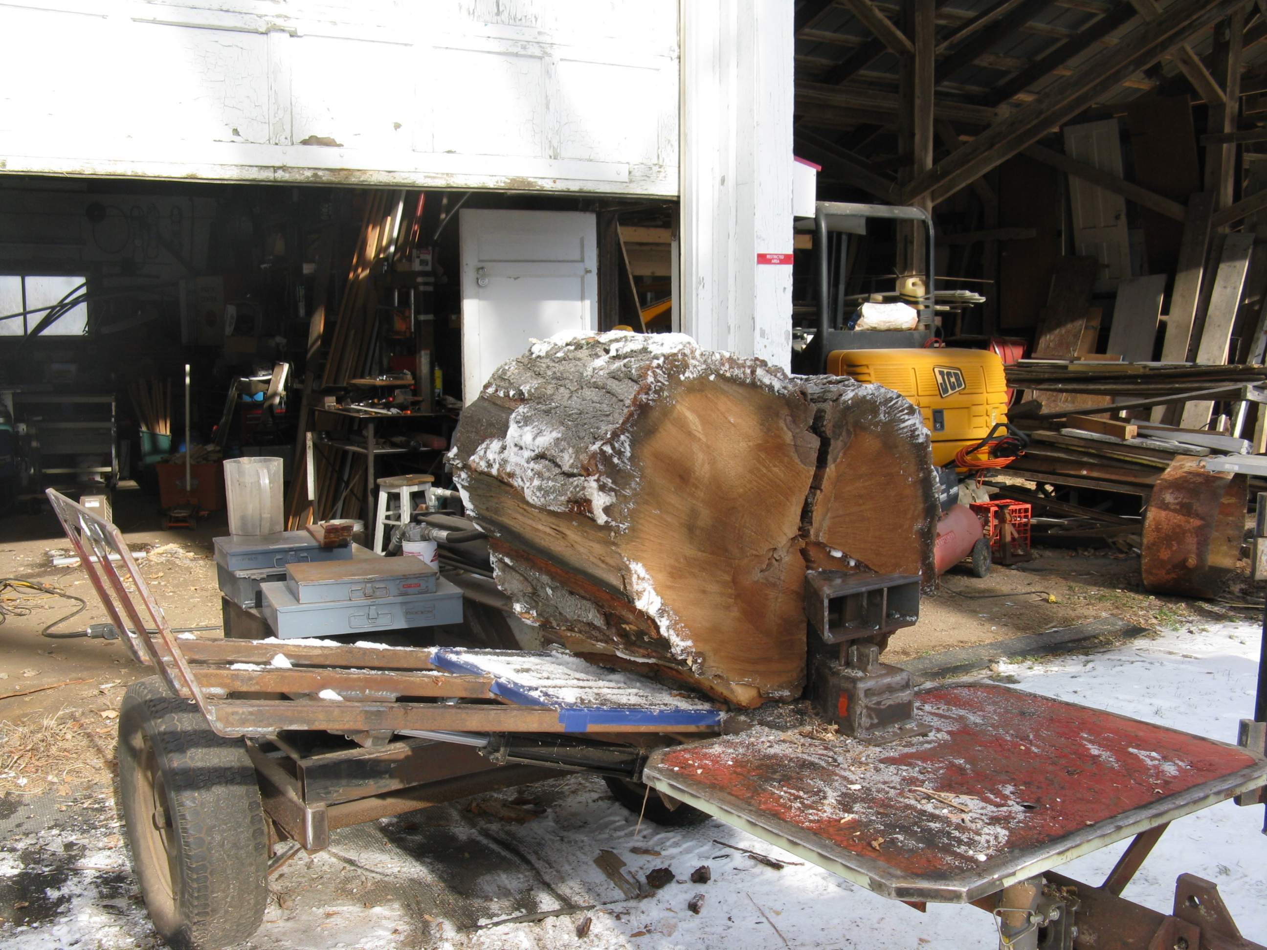

/ logsplitter lift #2
Check out the Log Mule on you tube. It might work for you. I have the hydraulic log lift on my wood splitter and it works very well.
A 32 inch oak round on the wood splitter. The log lift makes a good infeed table for small rounds to be split.

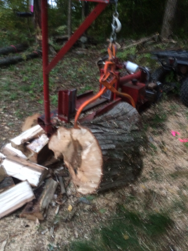

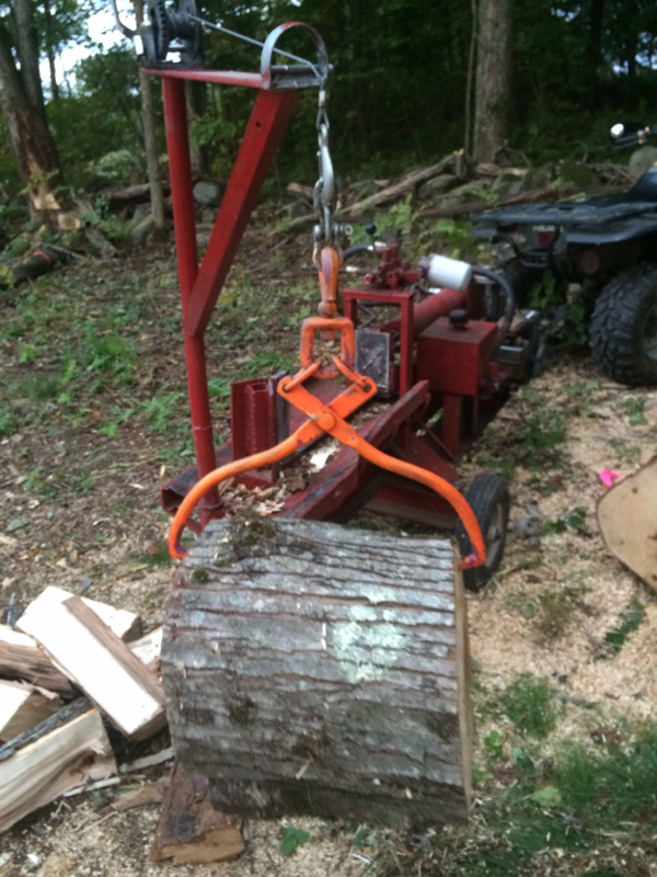

/ logsplitter lift #4
Heres mine works great and removable .a steel shaft behind the wedge out of the way,and the hoist mount is a peice of pipe,just lift round with winch,swing around and un hook my 150 lb wife does it.the best part is just lift whole thing off if you dont need it on there.
/ logsplitter lift #5
I'd like to see some close up pictures of the boom lift pivots, etc. Very nice work!

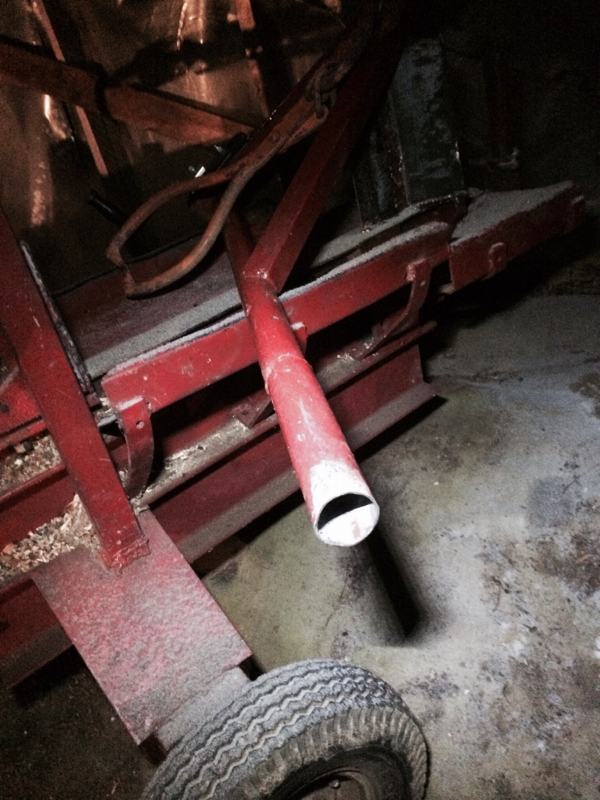

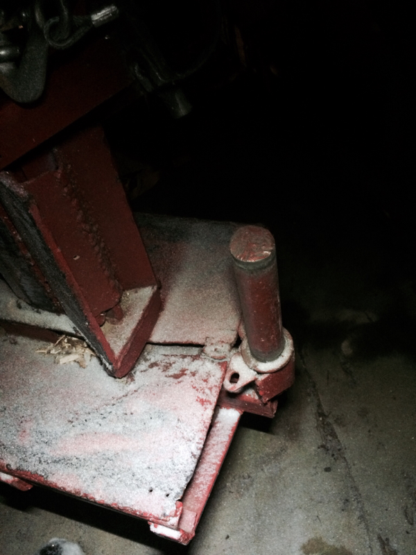

/ logsplitter lift #10
The pics i promised pretty simple
/ logsplitter lift #11
Thanks for the pictures. I'm surprised you can spin the tower with a log in the air, since the upright shaft is short. Seems like a lot of friction/stress at the top end of that solid rod, dragging on the pipe. I'm not doubting it works well, and I'm impressed with the solution. Do you grease it? I'll take a look at mine to see if it's feasible.
/ logsplitter lift #12
No grease and nothing touches the top of the solid rod . A big washer on bottom moves effortlessly actually
