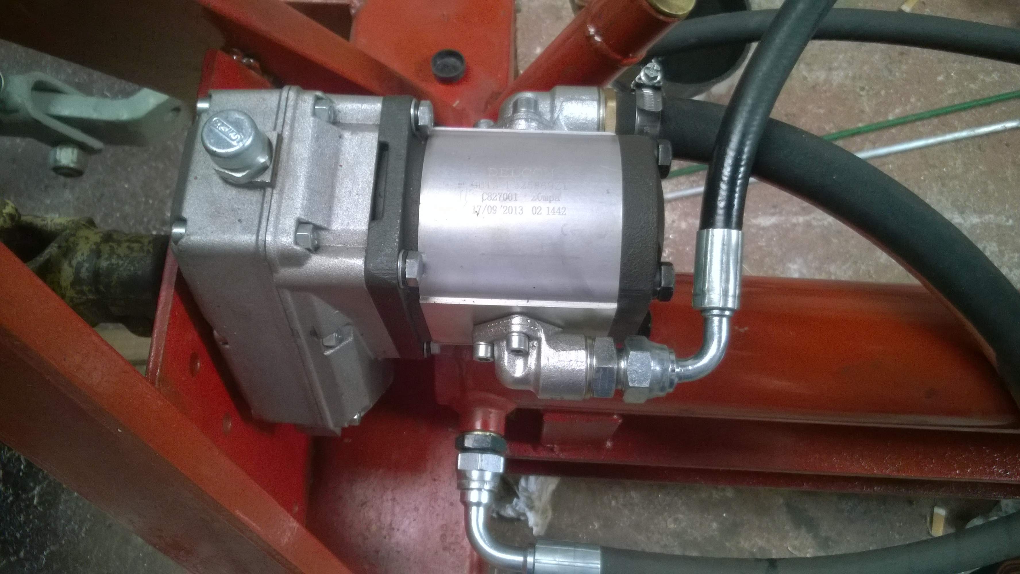

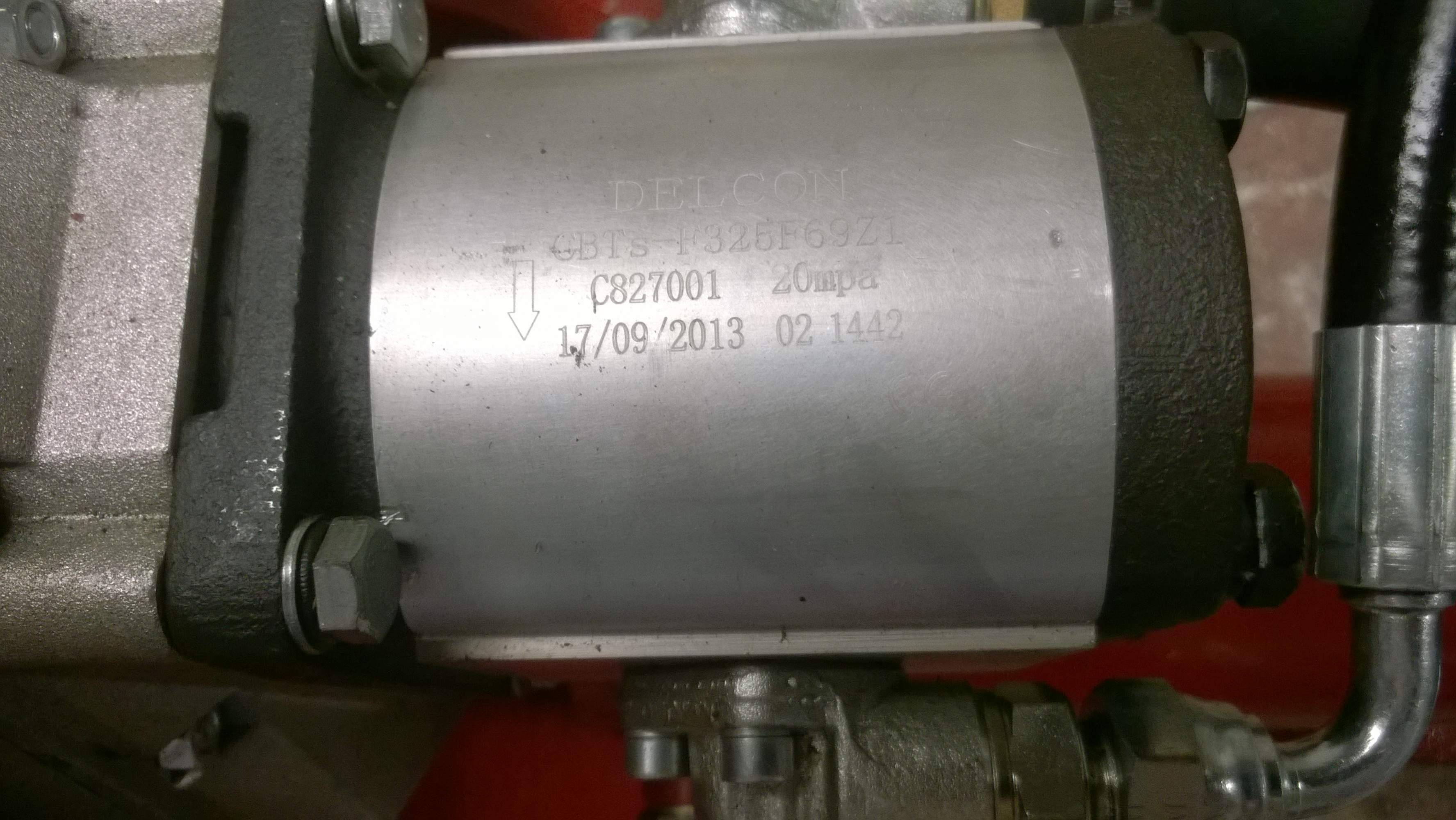

I have 2 speeds on the pto, 545 and 760, I was told the pump data at the shop as they have the speck sheet in the cataloge which we consulted looking for the most appropriate pump, working pressure is 200bar(2900psi) with max at 250bar(3625psi) from 1600rpm up over the flow doesn't increase much, no idea about 66% but i don't believe running anything at 100%

As far as the pump, what is the cid?
You said it is rated to 2800 rpm.
If the pump is a gear pump, the flow should be about linear.

3.5:1 similar to the ones here PTO Gearboxes 20KW You can get them to 3.8:1

I dont have a meter as yet to test the pressures, without sled connected its still the same, the pump is brand new, obviously some restriction on the return somewhere.
On tickover using the slowest pto speed the pump is probably doing about 500rpm and pumping only 2G/m at most, forward, engine doesn't change but on the return the engine governer cuts in to stop the engine stalling, at that flow rate the 1/2" hoses should be more than enough. If i speed the engine up to about 1200 rpm the engine doesn't slow much but you can still hear it comming under load but only on the return.
Could the pump have a stall speed or minimum speed,? ie too slow or would it just slow to nothing?
Hoses here are not cheap here($30 for a 1/2" 2 foot hose) so i don't particularly want to go change them all again and spend another $150 unless i was sure its the cause.
Again, thanks all for your help and patience.
