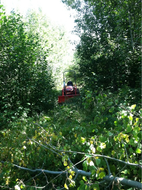

My B2320 w. 48" LP cutter. I take it places you can hardly see into. Go slow & be safe.
