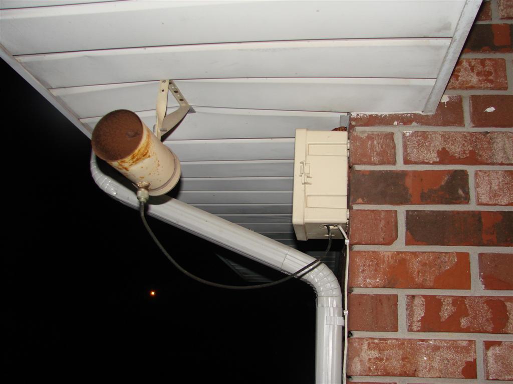

I have hi speed cable and my son who is a computer expert and lives in a house on my property 650' away from my house rigged a very cheap setup to connect to my internet.
He used a couple of old cans for the antennas that are in line of sight. I am not completely familiar with exactly how he set it up but he said it was very inexpensive and it works perfect. He said this system could easily go another 1000' if necessary.
It is connected to my router and I have 3 other computers in my house on the router and we get fast connections even with all 4 computers on at once.
I do not know the legalities of this setup, however, I own both homes and they are on the same property so I do not see any difference from doing this or using my computer in the other room or my laptop wireless outside on the front porch.

Those rusty tin cans, even in the state they are in, probably provide at least 10dbd of gain on each end. for a path gain of 20dbd or 100 times the signal strength of a dipole antenna. Noticed he kept the coax to the radio pretty short, and put it under the eve also and ran cat5e to inside the house. Pretty smart guy.
