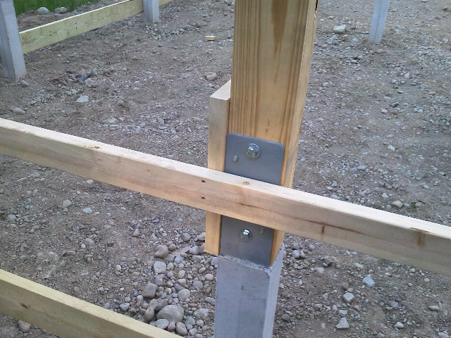

A few of you have asked for my thoughts and observations regarding the Perma-Column poles I used. Well....
The added about 10% to the cost of materials. They are very heavy. There's no wood in the ground to rot.
I went with the factory assembled poles. This meant the 2x6's were glued into three ply posts for the PC6300 and four ply for the PC6400 models in a controled environment. Also this allowed the butt joints to be finger jointed and glue. The posts where then milled to be square and uniform dimensions. This created a very straight pole.
Attaching treated lumber to the lower concrete section was no big deal. I used a Milwaukee corded 1/2" hammer drill with the recommended 3/16" masonry bit. The split drive nails were fairly easy to drive with a 20oz. hammer.

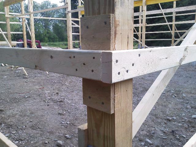

Attaching girts to the wood portion was quick work for the nail gun. However, the wood portion is smaller then the concrete section on two opposite sides. So because I installed the poles all in same direction to accommodate the headers the two sidewalls required a couple extra steps. To avoid nailing through the 3/8" brackets you need to place a 2x6 nail on the post. Your first grit, at 24" o.c., is then nailed to the added 2x6.
All remaining girts and headers will need a piece of 3/4" plywood between them and the poles. This will maintain the proper plain, creating a vertically straight wall. Remember this is was because of the header layout. I probably could have oriented the poles so to minimize this step, just didn't think of it till after poles where in.
Overall I would say I am quite pleased with the Perma-Column product. Would I use them again, definitely (no I am not building another barn).
Hope this answers everyone's curiosity

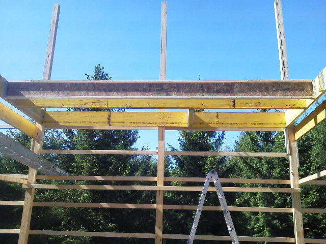

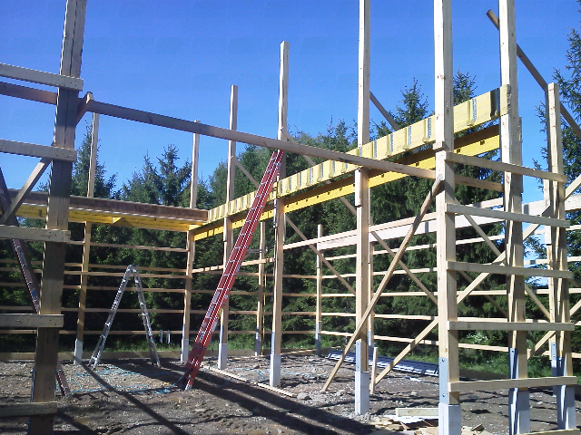

The weather has improved, been cold and raining last two days. It was actually snowing yesterday morning. I did manage to be a little productive though. The mower is back up and running thanks to my wife's uncle. Also got some mud put on the bathroom walls. That made my wife happy.
Barn update.
Today I put up the LVL'S that frame out the stairway and the first floor Joist. That took most of the morning as I was alone today. After lunch I set up a pic and put up all the joist hangers for tomorrow. Thank God my cousin let me borrow his hanger gun. Way easier to just pull the trigger then use a palm nailer, or worse, a hammer.
