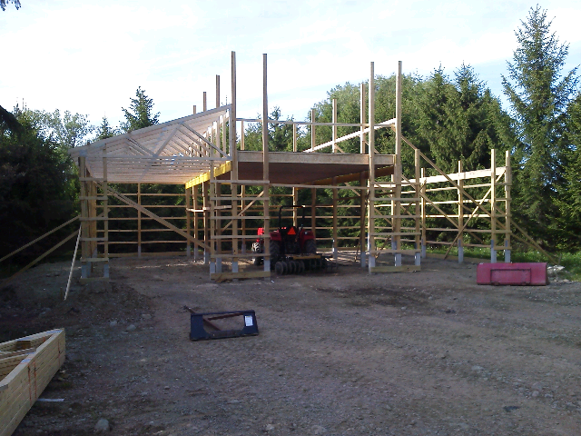

Here are two videos from Day 5. On this day I was by myself and managed to get the splash boards up all the way around and grits on the two sides.
Day 5 - Youtube
Day 5b - Youtube
I hope these links are working for everyone.
   / Long road to home.
#183
Days seven and eight. These two are the last of the videos for now. At least until I get out there next week to do more work. I hope you all are enjoying.
Day 7 - Youtube
Day 8 - Youtube
That should bring everyone up to date with the barn being left as seen here:

It sure takes time to do these things working alone. Nice progress, keep pluggin away!

That stinks. I am sure shipping would be out of the question. The 29 poles I ordered where 9000 lbs according to supply house and boy that wouldn't be cheap to move across the country. Bummer.

Thanks, some days it has been just me and a couple days I had a helper. Of, course having to come back and work a real job put a halt to the barn. Although tomorrow a friend of mine is supposed to stop by the house with his Porter Cable stair jig. He uses it to router the stringers to accept the treads and risers. If he is ok with it I am going to try and get some pictures of the jig and assembly process.
