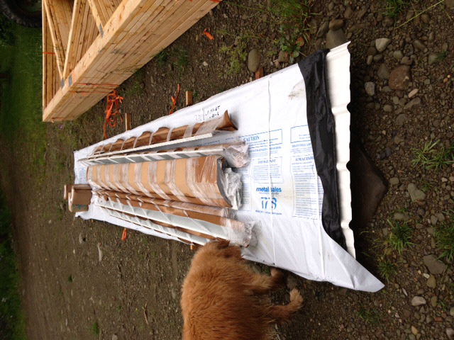

Metal has arrived, thanks to my wife for the pictures.

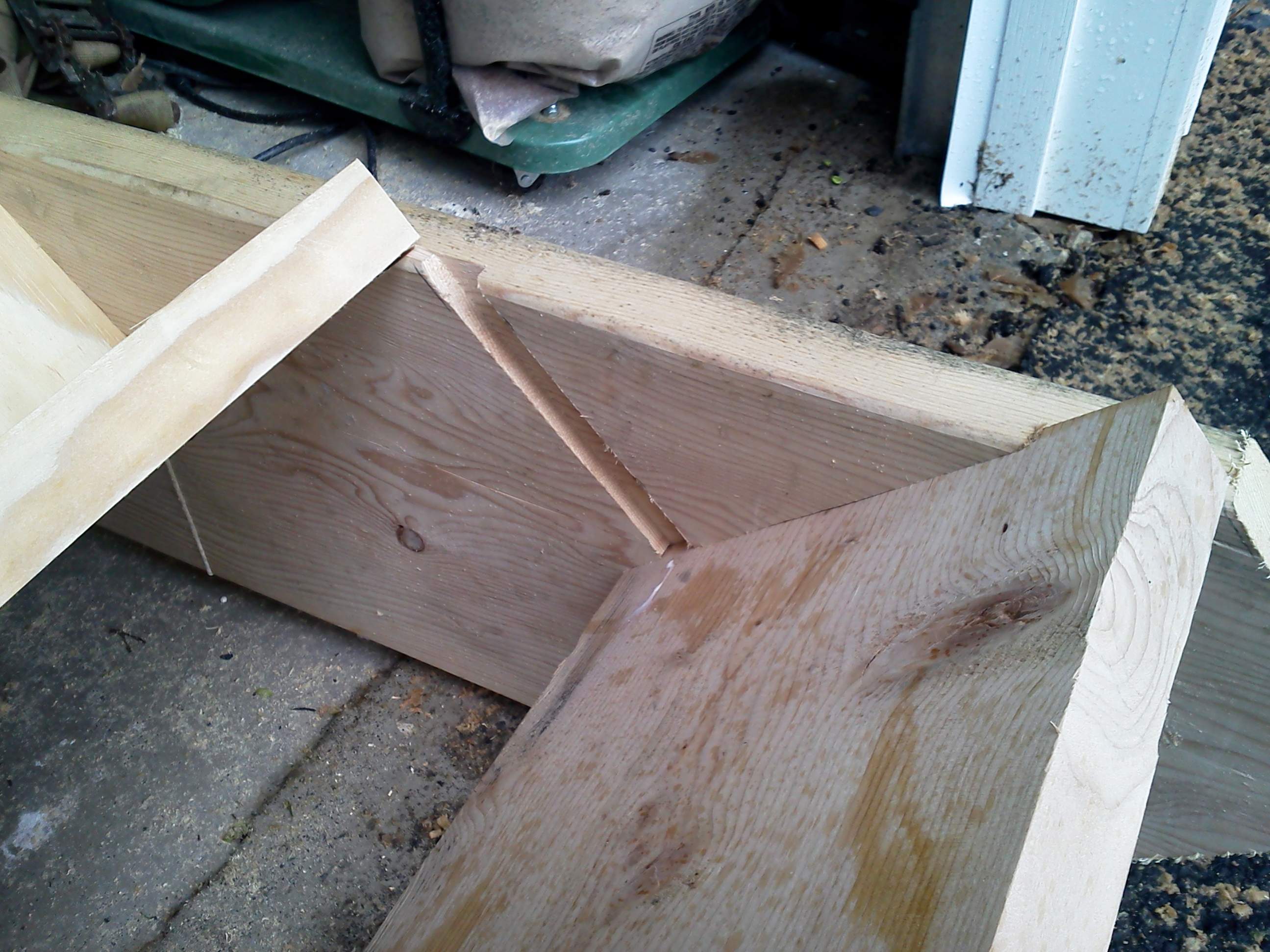

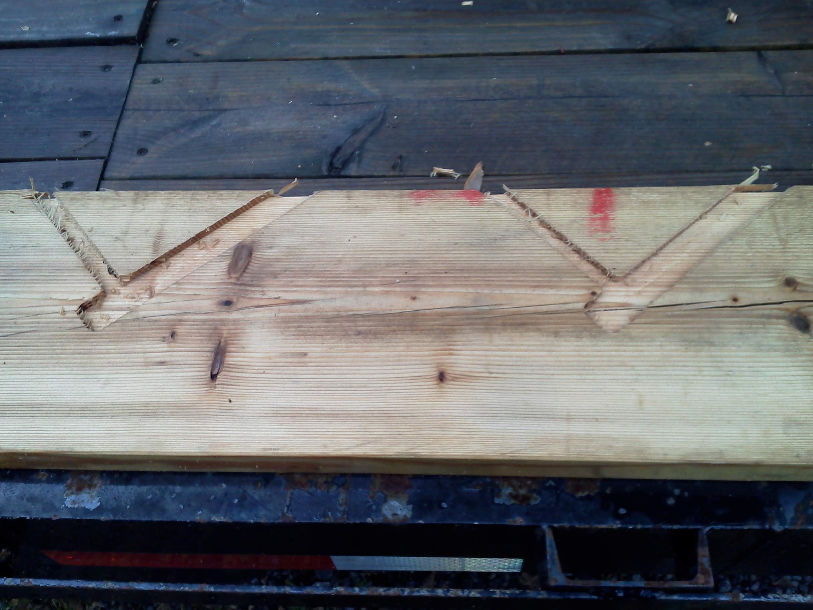

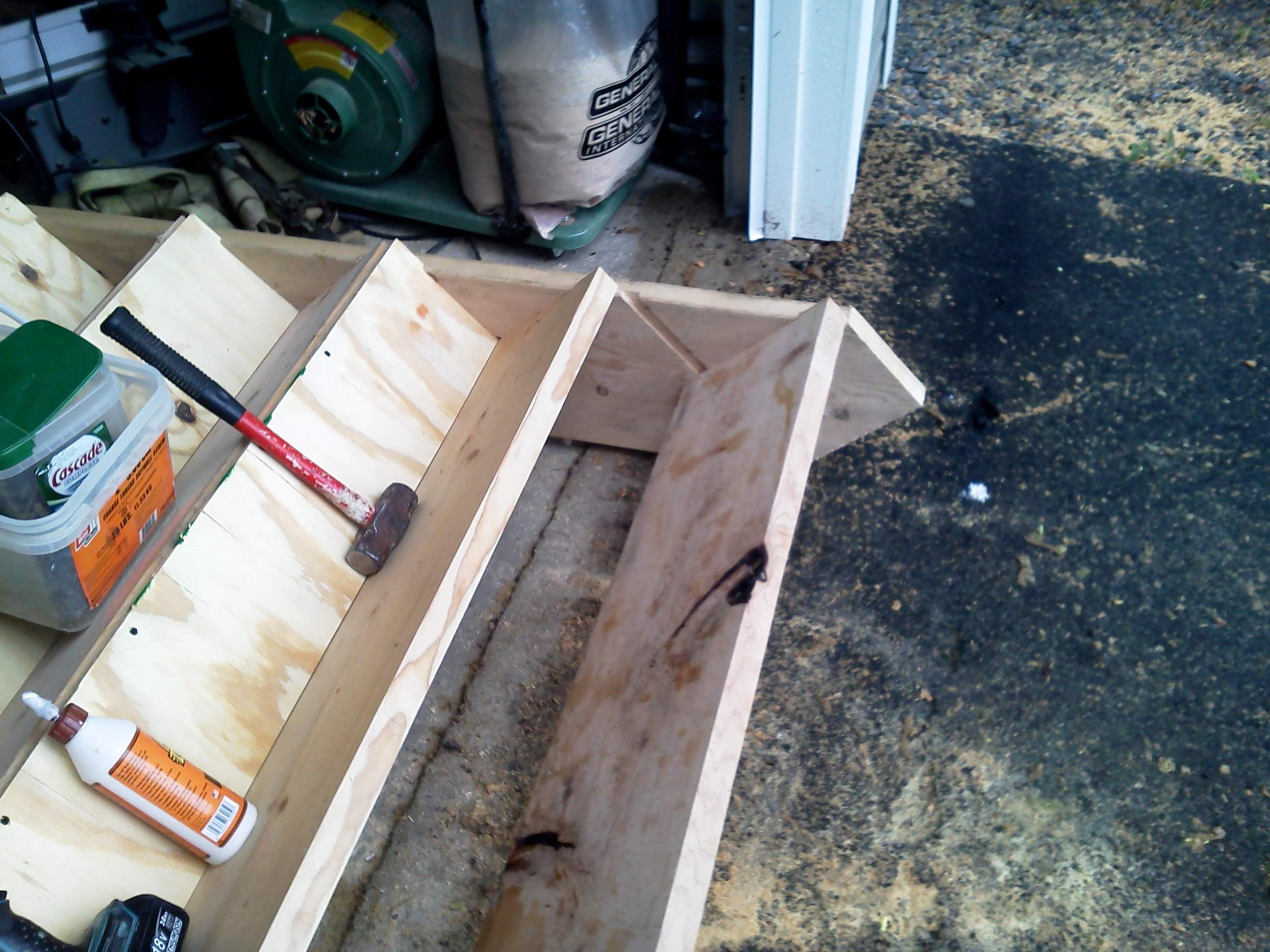

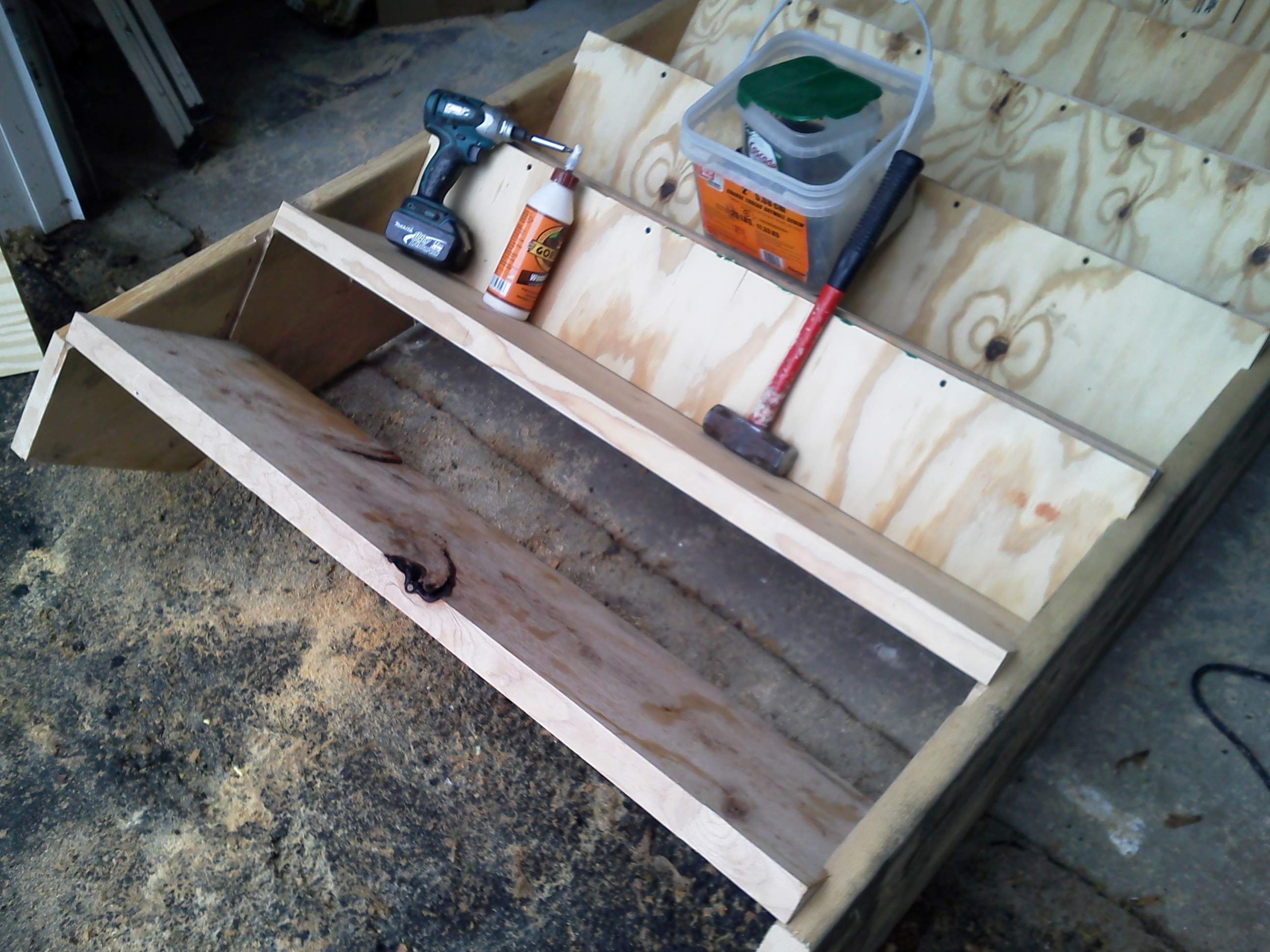

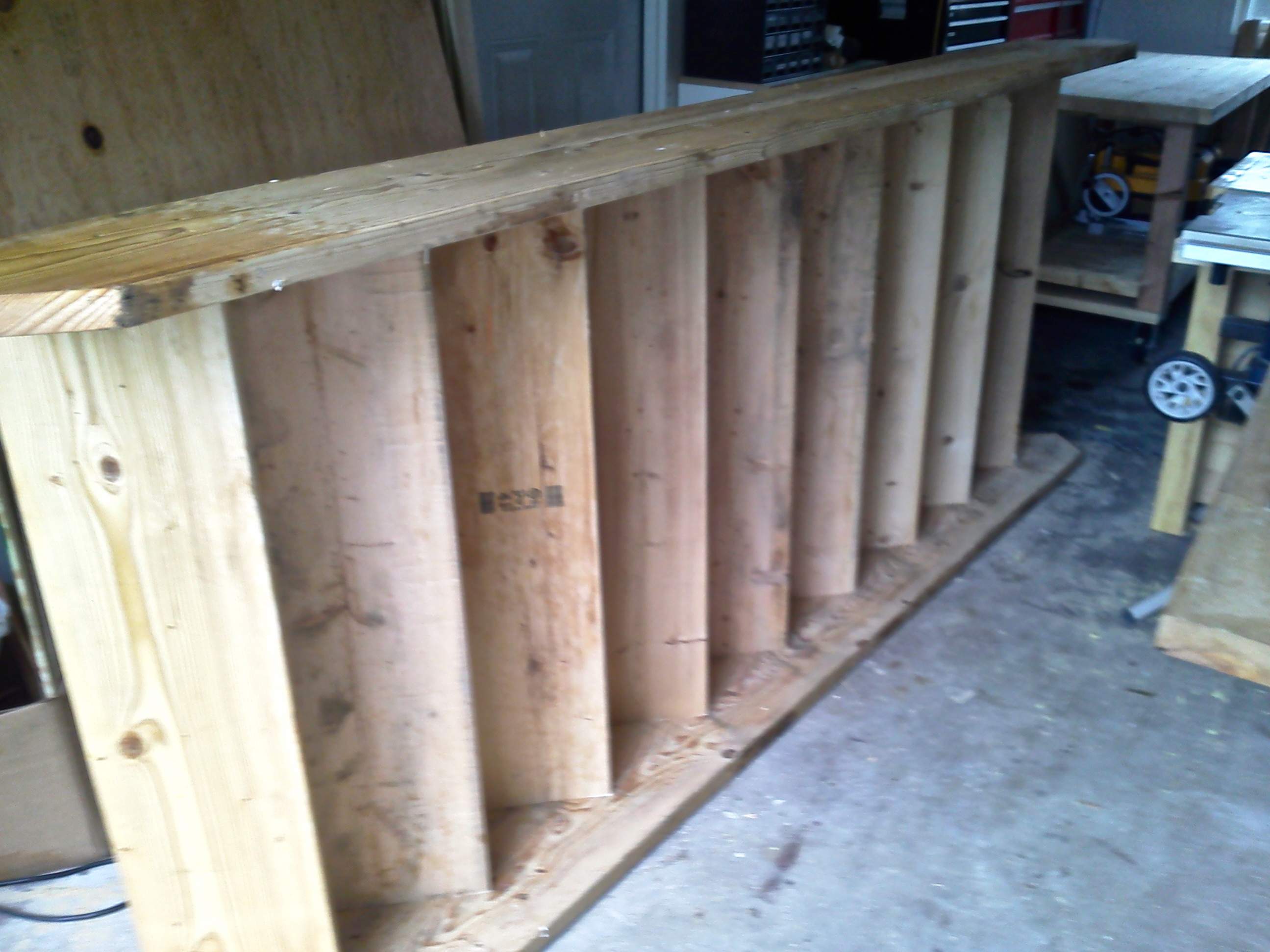

Ok, I promised some pictures of the stairs being built. My buddy didn't want his picture taken so I don't have any of the router jig he used. However I can tell you that it is a Porter-Cable STAIRS-EASE. They don't make them anymore from what he has told me. I did take some pictures of the assembly process today.
Here is what the stringers look like after we ran the router and jig. They are 2x12 Fir. This is a scrap piece that he wanted to test the jig's riser height on, as it is adjustable. That is why the risers and treads don't appear to meet, on the actual stringers they do.
The treads are 2x12 ripped down to 10 1/4" then slid into the appropriate slot. The next three pictures are of the back side of the stairs, as they are assembled face down.
The risers are made from 3/4" B/C plywood, again slid into appropriate slot.
Finished stair case.
The risers and treads are glued into place and screwed from the sides, three each end of the treads. The risers have two screws in each end and four along bottom edge to secure them to the tread below.
Feel free to ask if you have any questions.

Nice job on your stairs, that should make for much stronger stairs, than cutting triangles out for the treds to set on.
Dave
   / Long road to home.
#209
Thanks Dave. They are the strongest stairs I have ever made/seen. We have been doing them this way for 20yrs. Have yet to find a better set of utility stairs out there.

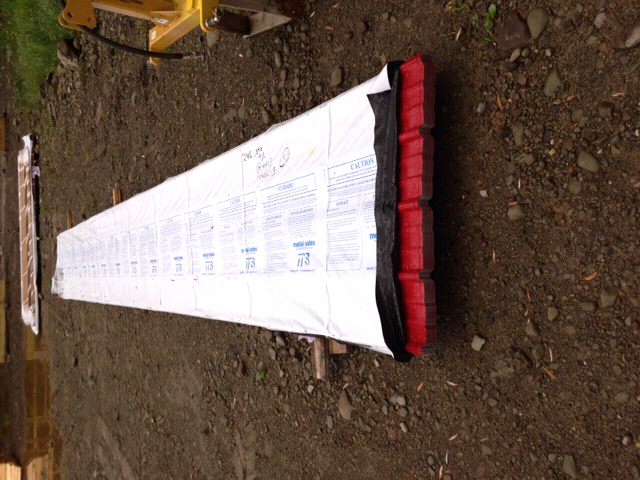

I got out here on Wednesday, checked the metal. Half the roof was shipped red, not white. All the J-channel is white, not red. All added up about 1/3 the metal is wrong.
