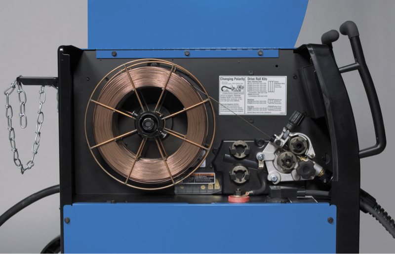

I realize this is about Longevity, but it is interesting to note the new Millermatics feature a new angle drive system that makes feeding better and prob increases liner life. Terry

Perhaps the angled drive roll mechanism is to counteract the the effect of welding carts that mount the feeder with the front panel tipped upwards ....?

I studied that today ... the wire on the longevity feeds clockwise under the bottom in perfect line with the drive system ... the wire has a straight shot into the mechanism.

Sorry, blueriver I guess I didn't explain clearly. The advantage of the angle drive is achieved where the wire enters the mig gun's whip, aiming it at the ground instead of level to the ground.
Pic from Miller website.
Terry

Sorry, blueriver I guess I didn't explain clearly. The advantage of the angle drive is achieved where the wire enters the mig gun's whip, aiming it at the ground instead of level to the ground. <img src="http://www.tractorbynet.com/forums/files/welding/408359-longevity-migweld-140-awesome-machine-image-2220212444-jpg"/> Pic from Miller website. Terry
That's is a pretty good idea
