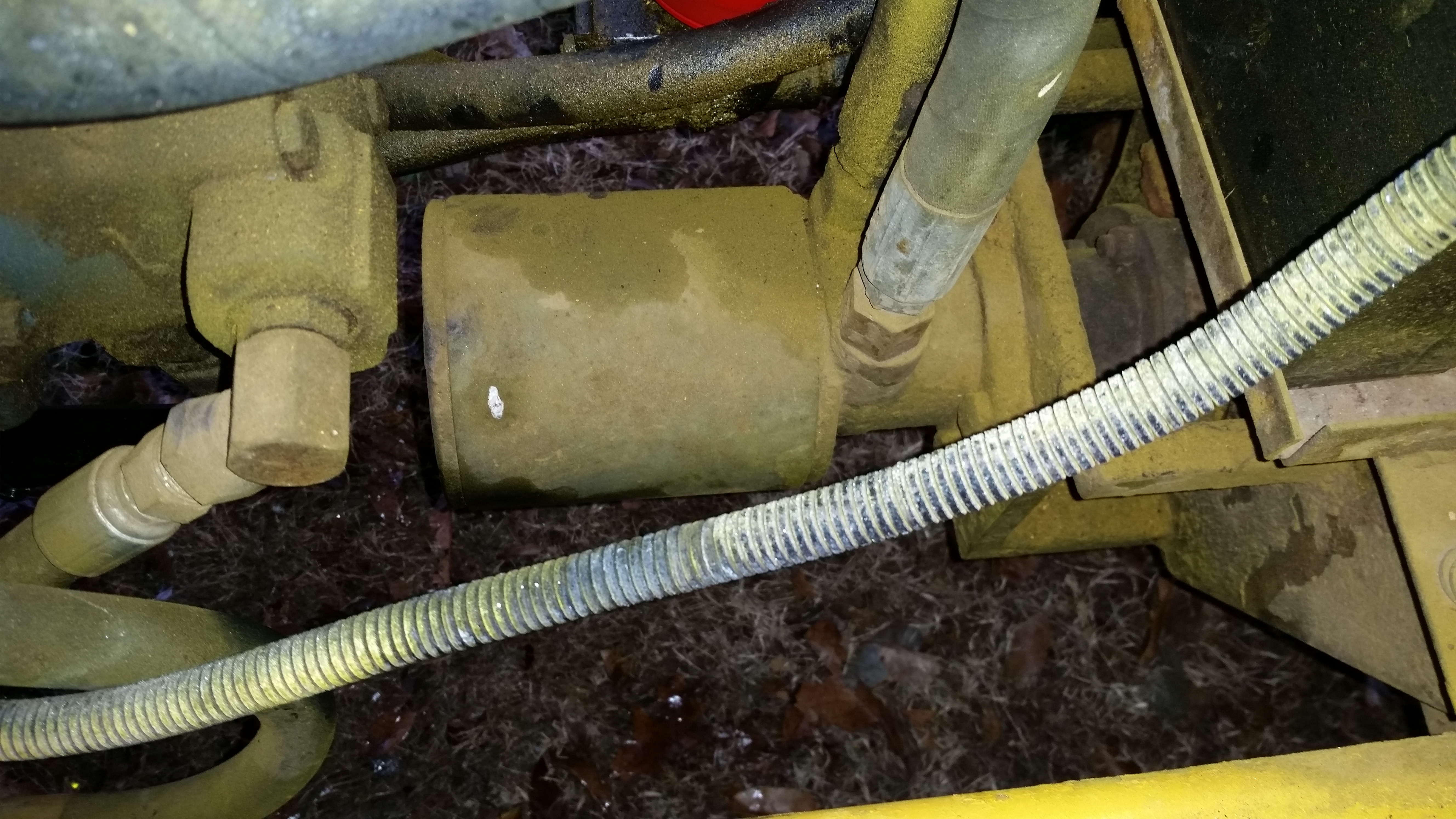

You are correct..the STP did not screw on.....So I still have to find a proper replacement for the BALDWIN BT111 on it now...or just hope the BT111 is the proper filter and buy another one.
My metal screen for the hydraulic fluid was still in tact and screwed into the outlet of the hydraulic tank. The screen was full of plastic/nylon pieces from all the piston seals that inside the hydraulic cylinders that had come apart into tiny pieces.
Does the hydrostat transmission have a completely separate hydraulic filter or does it just rely on the filtering done by the metal screen in the bottom of the hydraulic tank and the screw on replaceable hydraulic filter under the seat area ?

Does this canister that is attached to the hydro pump have some type of screen filter inside it that needs to be periodically cleaned/replaced ?
It looks like there is about 6-8 bolts on the front side of it that hold the housing to the face of the transmission ? . filter.jpg
