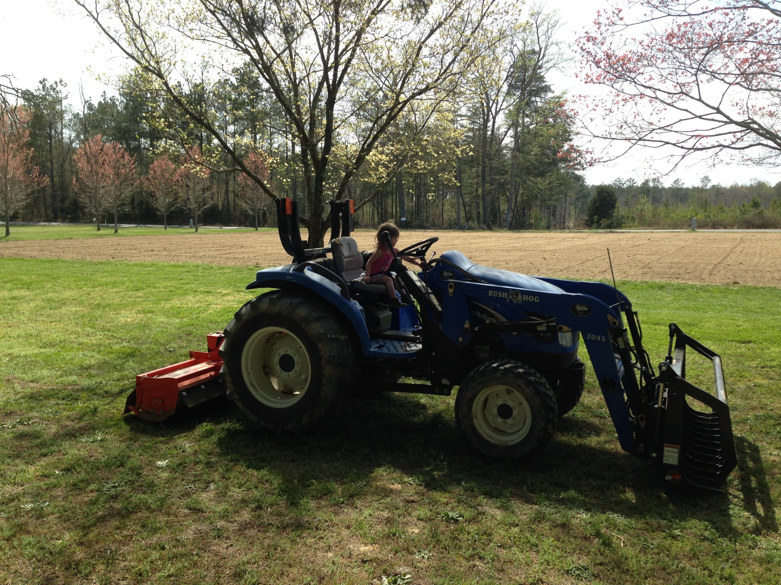

Or this would be good and put a koyker loader on it .

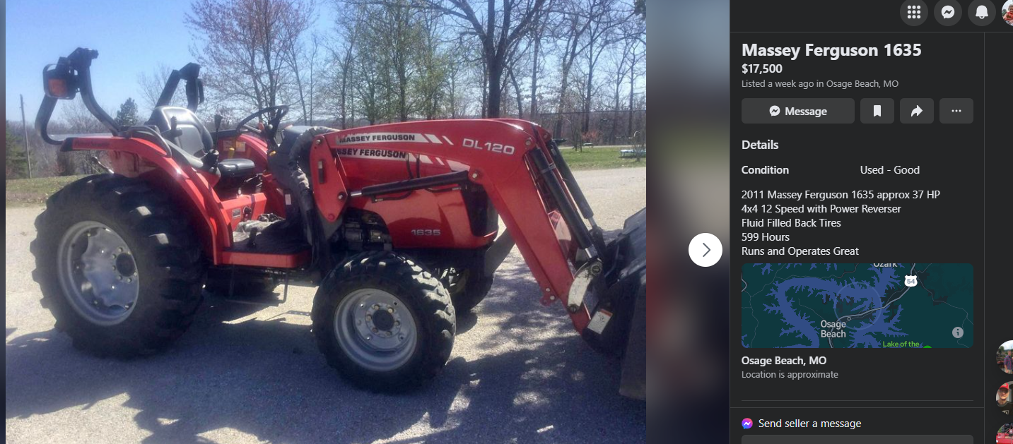

Thanks all for the heads up on scams. Unfortunately, they are pretty common but easy to identify. Does anyone else have some input on the different options available for 5k to 20k? Older, newer, 2wd, MFWD, I'm not sure exactly what I will need to get the jobs done. For example, will a 3000-4000 lbs 30-40 horse tractor clean up a rough steep road with a box blade or drag a 2000-3000- lbs log out of the woods? From everything that I have read on this forum people say get the biggest tractor you can afford. I can get a 4020 for 15K but I think that is too big, cool to have though.

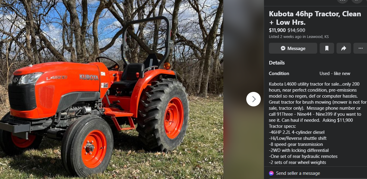

if you happen across a yanmar they are great tractors . as well as a nice condition kubota , ford , newholland …. if you have a hilly terrain i would recommend a 4wd . my farm is hilly and i use 4wd often . it is also a force multiplier when plowing or dragging heavy .. a loader is extremely helpful. on older tractors watch tire and rim condition, some can be pricey if not a common size . although don’t let this be a deal breaker just allow in purchase price. i find the yanmar ym336d a handy small tractor w decent horsepower (36) . i have 2 and run them daily . my big gun is a kubota m5700 , at 62 hp does all i ask of it . but it is big and heavy which can be a disadvantage at times , but usually the weight is helpful. best to have one of each ….watch for grey market tractors they can bs sketchy…
