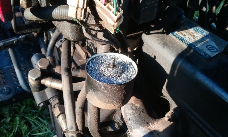

I checked the fluids, oil is low (of course) , Coolant is fine, Hydraulic is low? I filled it with 3 gals yesterday and thought I over filled it since it twice over the dip stick. I removed about gallon and the level was ok. I'm wondering if the hyrdaulic fluid settled overnight or it could be the pump seal.
This did start to happen after I connected a finish mower.

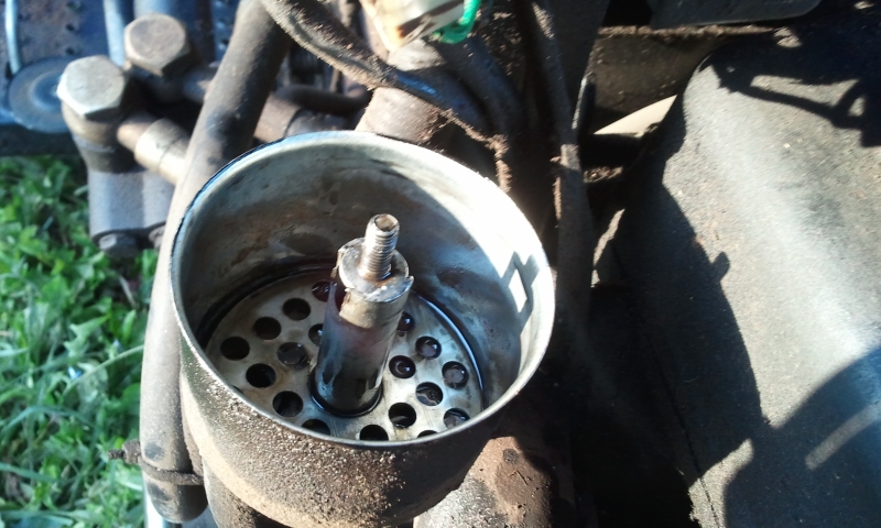

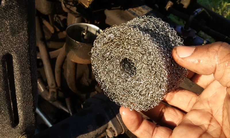

I removed the brillo pad from the oil overflow. It didn't look too bad (pictures below). I put it in some diesel and the dirt is coming off.
Mosquitos started biting so I called it a night.
The tractor didn't smoke, lose power or anything, I just saw the pressure drop when I was mowing and pulled it over to check it out.
The chinglish manuals are confusing, I didn't see how to service the pump in there. How big a job is it if that's the case?
Fun times, but I'm not giving up. This things gonna get fixed.
pull that screen out from the bottom of the breather, I see raw oil down there that should be cleaned out too. You might have to remove the breather assembly from the side of the block to get it clean throughout. It's easy to get off, but there's a good chance you'll have to cut a replacement gasket before putting it back on.
