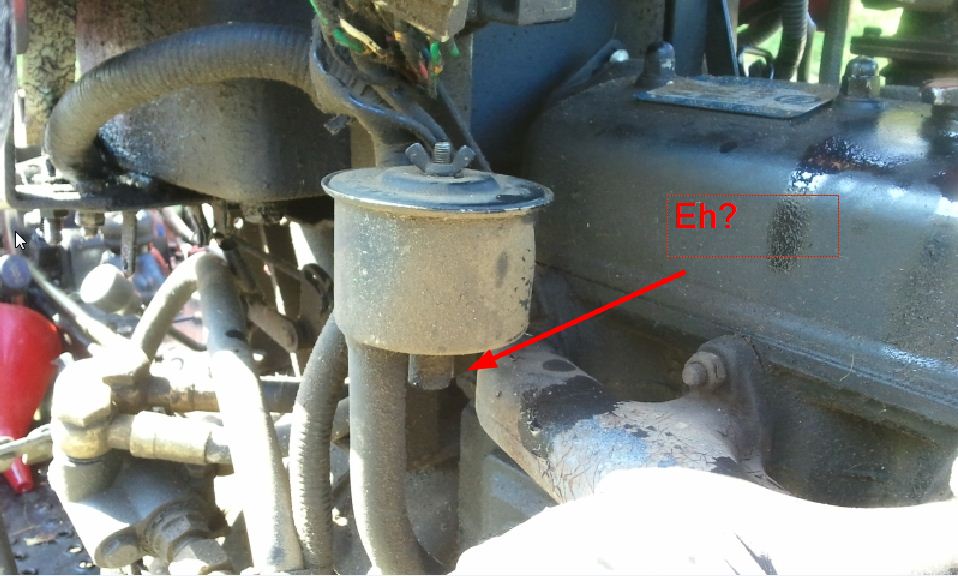

** New Problem **
(maybe I caused it)
Took it out for a moving adventure and I notice the oil pressure dropping?!
I let it cool down and check the stick..it was low:confused:
I added some more, started it, revved it a bit and notice oil DROPPING OUT of some reservoir.
So, what is this? And, why is it dropping oil? Is something supposed to be connected it here?

The first pic looks like a crank case breather to me.
Second pic looks like a puddle of oil on the ground.
Check your coolant and hydraulic oil levels.
   / Look what I got for $1700 #48
If it's spewing oil out the crankcase breather (what it looks like to me), then you've most likely got combustion gases getting into the crankcase from a blown head gasket or busted piston rings or some such.
Check the radiator for oil in the water, check the crankcase for water in the oil, etc. Check the hydraulic fluid because Bob said to. :)
Let us know what you discover.

Hold on, let's not get the cart too far in front of the horses here. Sometimes a dirty crankcase breather will do the same thing. The idea is that the mesh inside the breather separates the oil from the crankcase vapors; the vapors going out the hole at the bottom, and the oil draining back into the crankcase via the metal tube.
Spin that thumbscrew off the breather cover, and pull out the steel mesh. Give it a good bath in diesel fuel or kerosene, clean out the breather housing, put the mesh back in and the top back on. I cleaned mine at least once a year. Then get a section of some kind of flexible tubing that's designed for contact with petroleum products. How long a piece is up to you. Attach one end to the vapor exhaust sticking out of the breather, run the other end where ever you want it. I had one about six feet long that I ran under the tractor far enough to discharge behind the seat.
