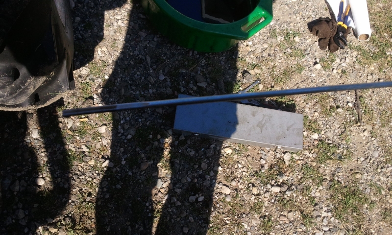

When the tractor was cold, I replaced the newly cleaned brillo pad filter in the breather. I also cleaned out the bottom plate and made it spic and span.
I checked the fluid levels and saw that I had too much oil. This is most likely due to when I refilled it after the breather dumped oil on the ground. It didnt look like any cross contamination, but its new oil so it didnt show so well on the dip stick.

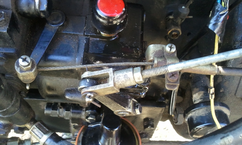

I also checked the fuel pump oil which I already changed. It leaked a bit from the top filler screw.:confused: I added about a few tablespoons more which made it dribble out of the level screw hole again and tightened it back up.

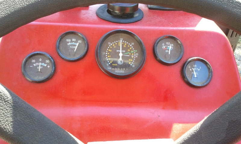

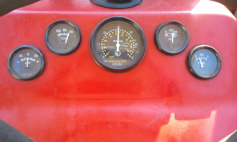

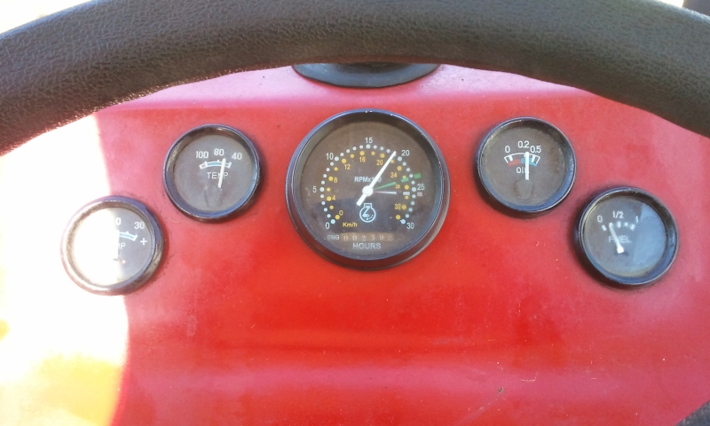

Started it, let it sit for 5 minutes (picture coldengine.jpg). I then shut it down and checked the fluid levels. All the levels stayed the same :D *whew (picture "5minutesafter.jpg"). I then took it for 30 minutes of mowing at 2000 rpm. I watched the gauges fervently. The oil pressure dropped from .5 to about to about .3 (picture "30minutesofmowing.jpg"). I stopped it, checked the fuel levels..They were about the same. :thumbsup:

The fuel pump oil filler did leak some more (picture fuelpumpleak.jpg), then it stopped. Could I have overfilled it? Maybe it needs bleeding or something? Whatever the case, I'm sure elated that I don't have to change any major gaskets or seals (yet).

I want to clarify one thing, though. If you check the hydraulic fluid level by screwing the dipstick back in, that will result in UNDER filling the sump, rather than in overfilling it. When the dipstick is screwed in, it goes deeper into the sump - thus, a lower oil level will read full than it would if the stick was merely rested on the top of the hole, which holds the stick up higher. Does this make a big, important difference? I doubt it. The important thing is to do it the same way all the time and pay attention to what seems to work well for your machine.
Overfilling the hydraulic sump usually results in the oil dumping out of the breather cap/dipstick when the tractor is going up steep inclines. After a certain level is reached, this problem cures itself, obviously. However, that level may not be the optimum level for proper operation of the hydraulic system. If you go up a lot of steel hills (thus losing fluid), you may want to extend the hydraulic filler/breather by modifying it to take a piece of clear vinyl tubing that can be zip-tied to one of the ROPS arms so you don't lose fluid on hills. Your own experiences will dictate what is right in your particular circumstances.
That's a bit high actually, but the electrical oil pressure gauges are not known for accuracy. Those numbers represent MegaPascals by the way:
0.1 MPa = 14 psi
0.2 MPa = 29 psi
0.3 MPa = 43 psi
0.4 MPa = 58 psi
0.5 MPa = 72 psi
But I'm wondering if someone fooled with the pressure adjust on the filter head. I say that because many owners - presumably with correctly adjusted filter heads - report cold oil pressures of up to 0.4 which then settle between 0.2 and 0.3 when warmed up and under load. Hot idle pressure as low as 0.05 can still be considered safe. If you're unsure whether or not to trust the gauge, I recommend borrowing a mechanical gauge for comparison.
Doesn't look significant. I'm going to speculate that - as the pump heated up - air in the sump expanded. There's mesh inside the vent cap similar to that in the engine oil breather. The expanding air took the path of least resistance, and pushed out what little oil that may have been in the vent cap
//greg//
Thats exactly what mine did. It went to .4 on a cold engine then settled down after it warmed up.
Thanks for advice. I'll keep an eye on the pump. It didn't lose much after the first fillup. I put a few teaspoons in it and it started to dribble from the level screw hole again.
