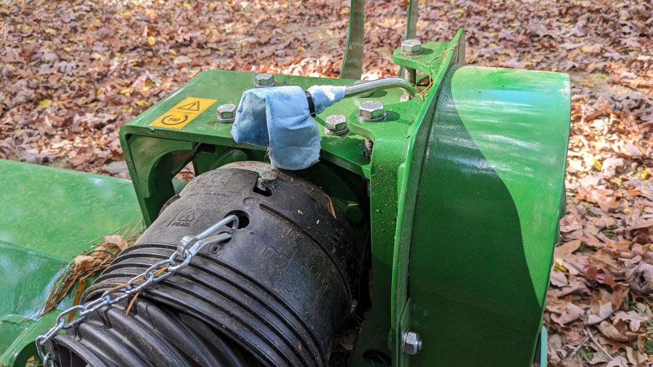

Before starting I ziptied a shop towel over the gearbox vent.
After two hours mowing flat & vertical, no new grease on the housing, just a collection in the towel, suggesting what I had seen earlier came from the vent following orientation changes.
