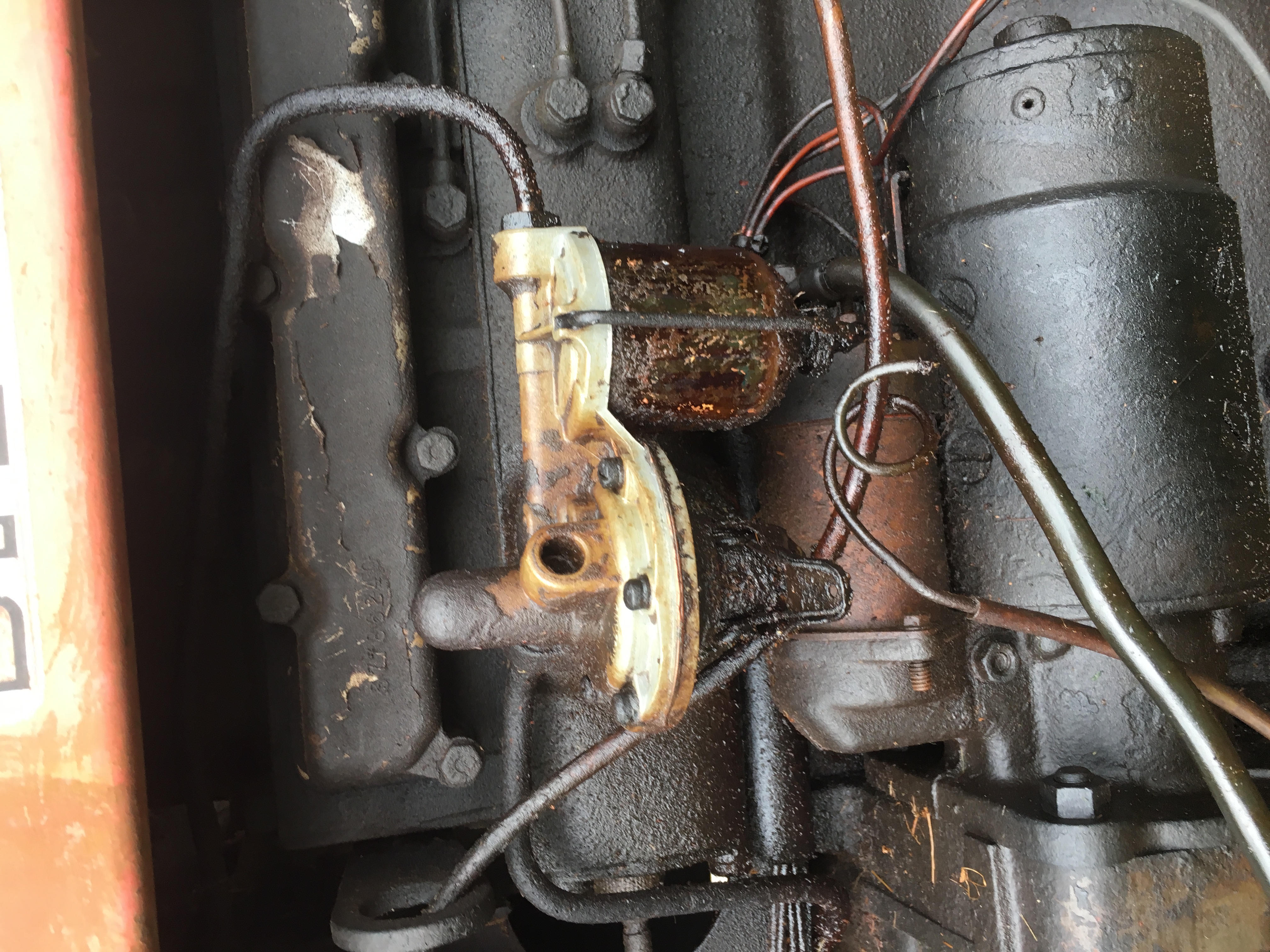

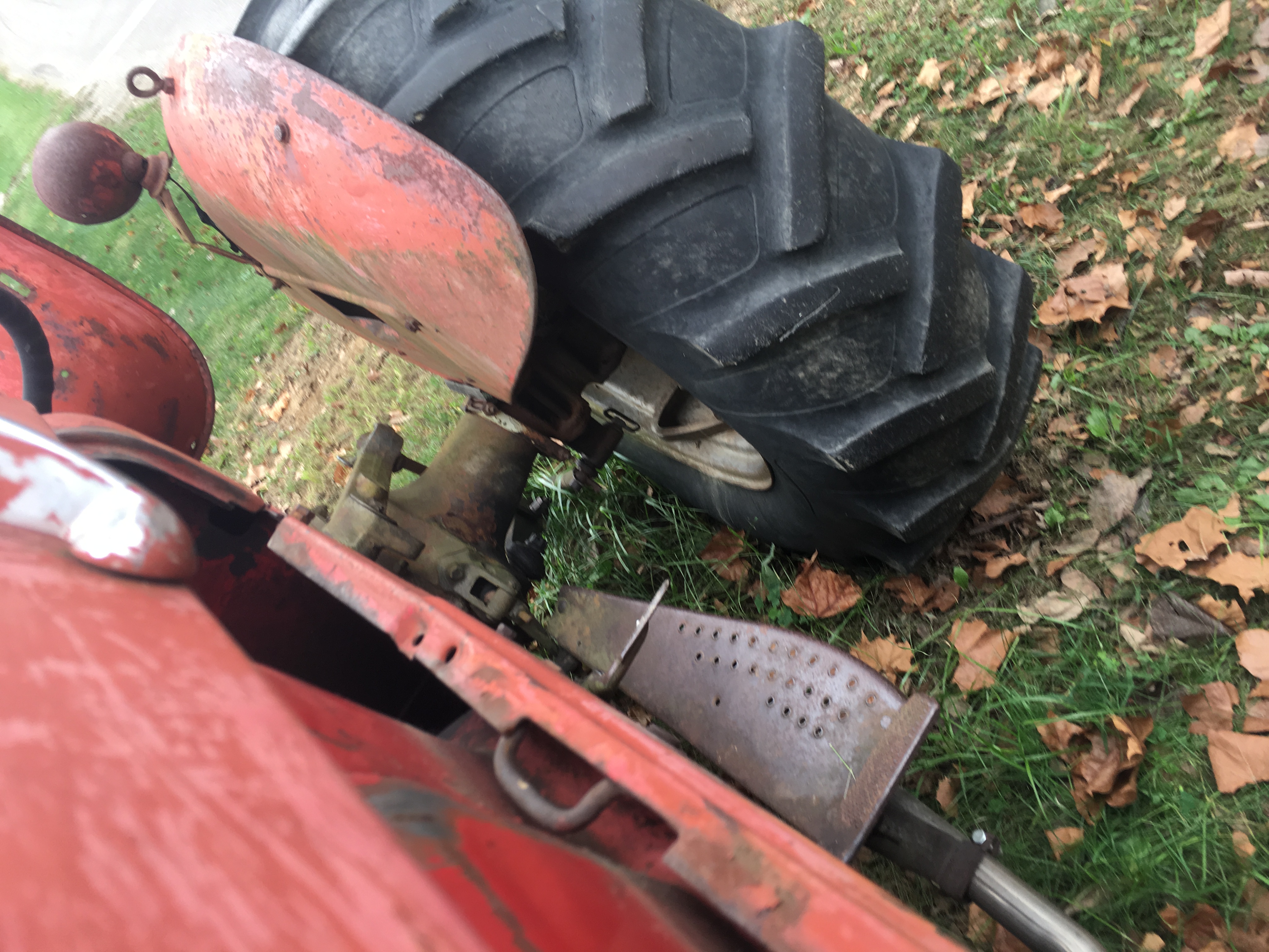

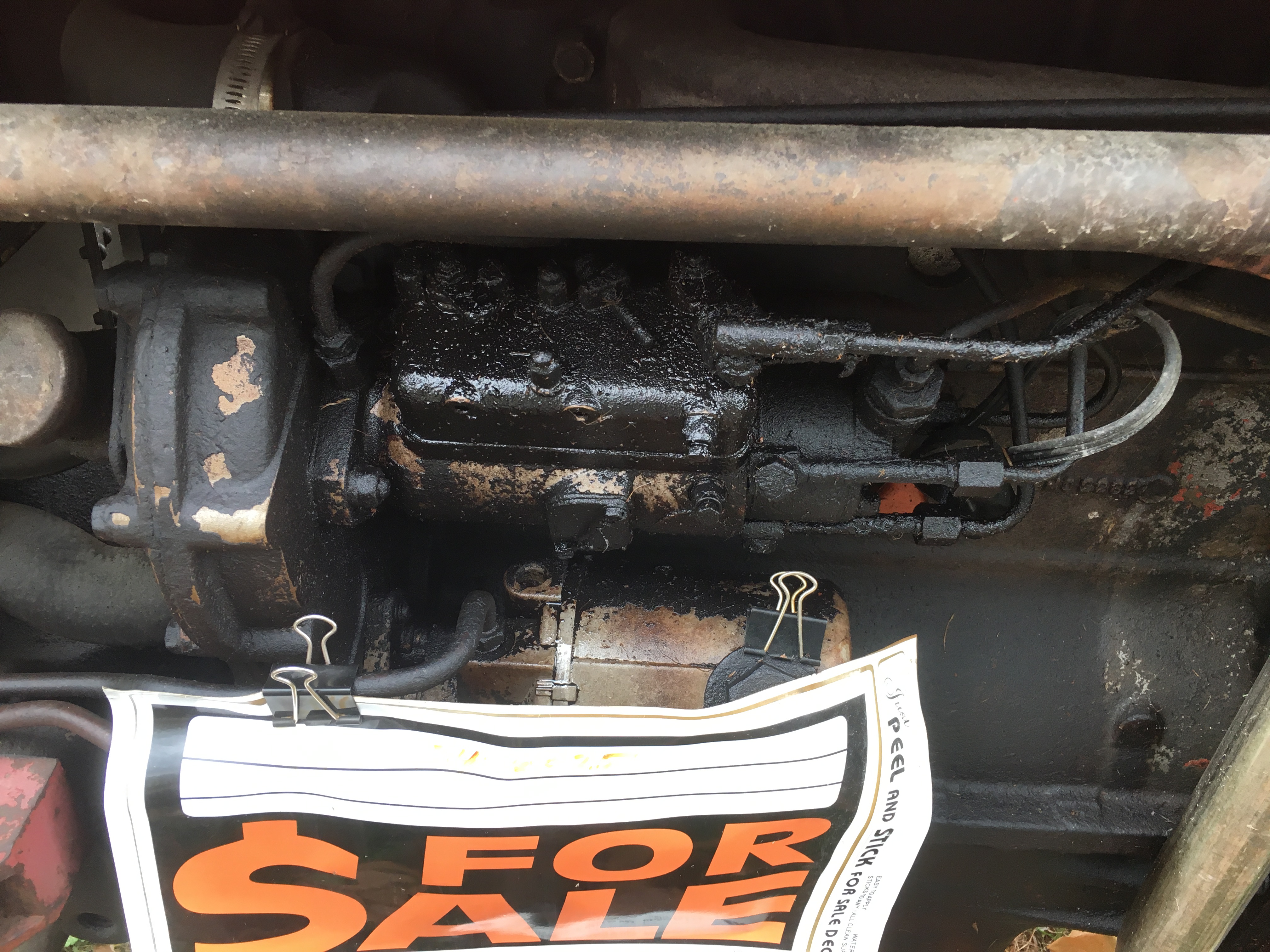

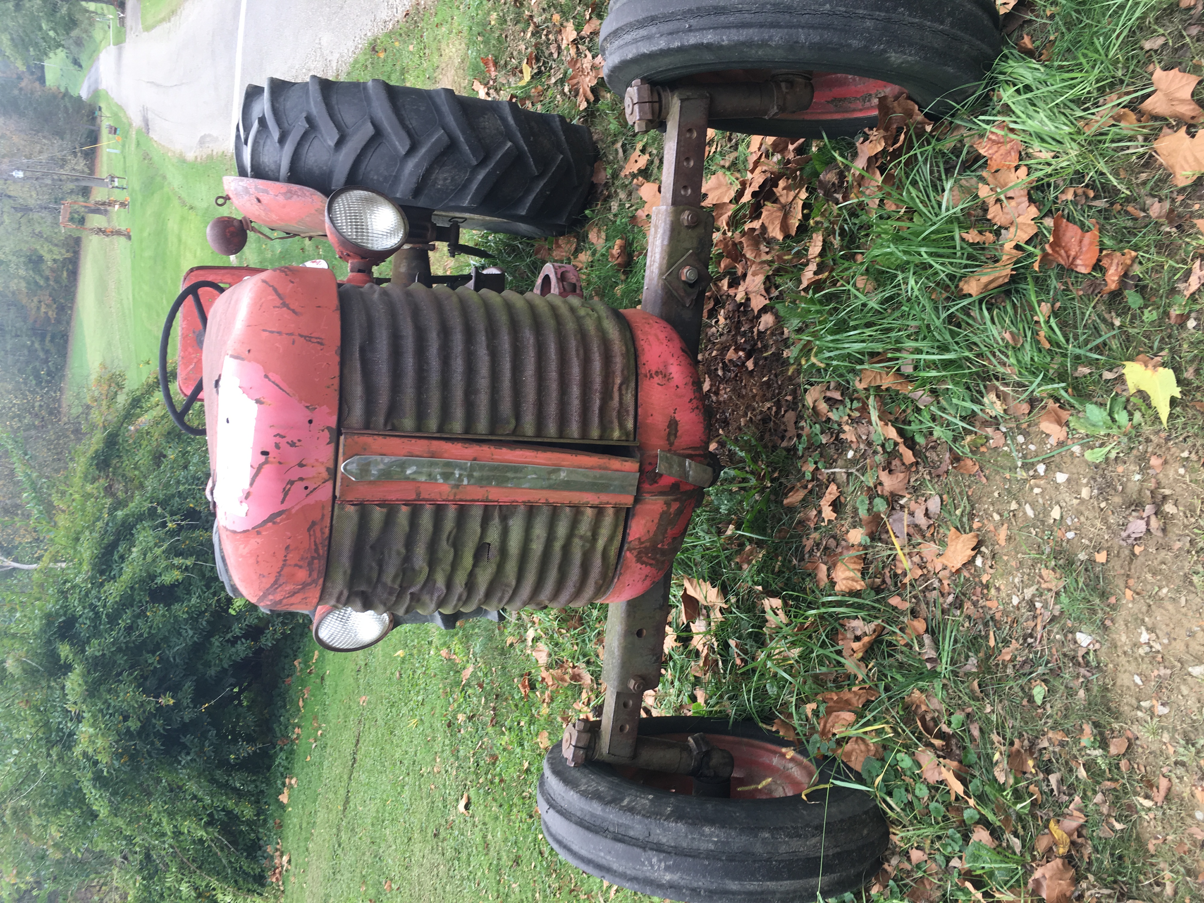

Hey everyone, Im looking at picking up a MF 65 for bush hogging and pulling a 3-4 bottom plow. Metal looks good to me, and the machine looks like its mostly original. not sure of the hours, and tires look to be OK, with some cracks in the treads but still holding air well. Serial number is SDNW, 688XXX, which makes be think its a perkins 203 direct injection. There is a constant drip of fuel form the injector pump, and the bowl looks to be leaking as well. I haven't seen the machine run yet, but I will this weekend. I am told the PS doesn't work, but the owner doesn't know why. It appears he didn't fix anything that didn't effect the machine running. Owner stated the machine runs great despite fuel leak from injector pump.
Do you all have any advice about this machine? anything to look for, or should I stay away? any help is appreciated. Price as is is $1200, and i think i can get it for 900-1000.

Thousand bucks for a running 40 hp(ish) diesel tractor? Sounds like a good old machine to me and a good deal. Fuel leaks are cheap, easy fixes.

ya, i wouldnt shy away from it, even if it needed a new pump they are cheap. I would jump on it. A little work to get it in better shape, but its alot of horse power for cheap. IF this was for sale down the road from my house, i would jump on it. As i think it would make a good hay tractor. I would keep it at 3 bottom plow, 4 i think would be pushing it with this unit.

Tough and powerful tractor. I've used different 65MF and 800 Fords since they came out in late 60s and the 65s are noticeably more powerful than 800s. Unless rear wheels have ballast,you can't tax the engine.
