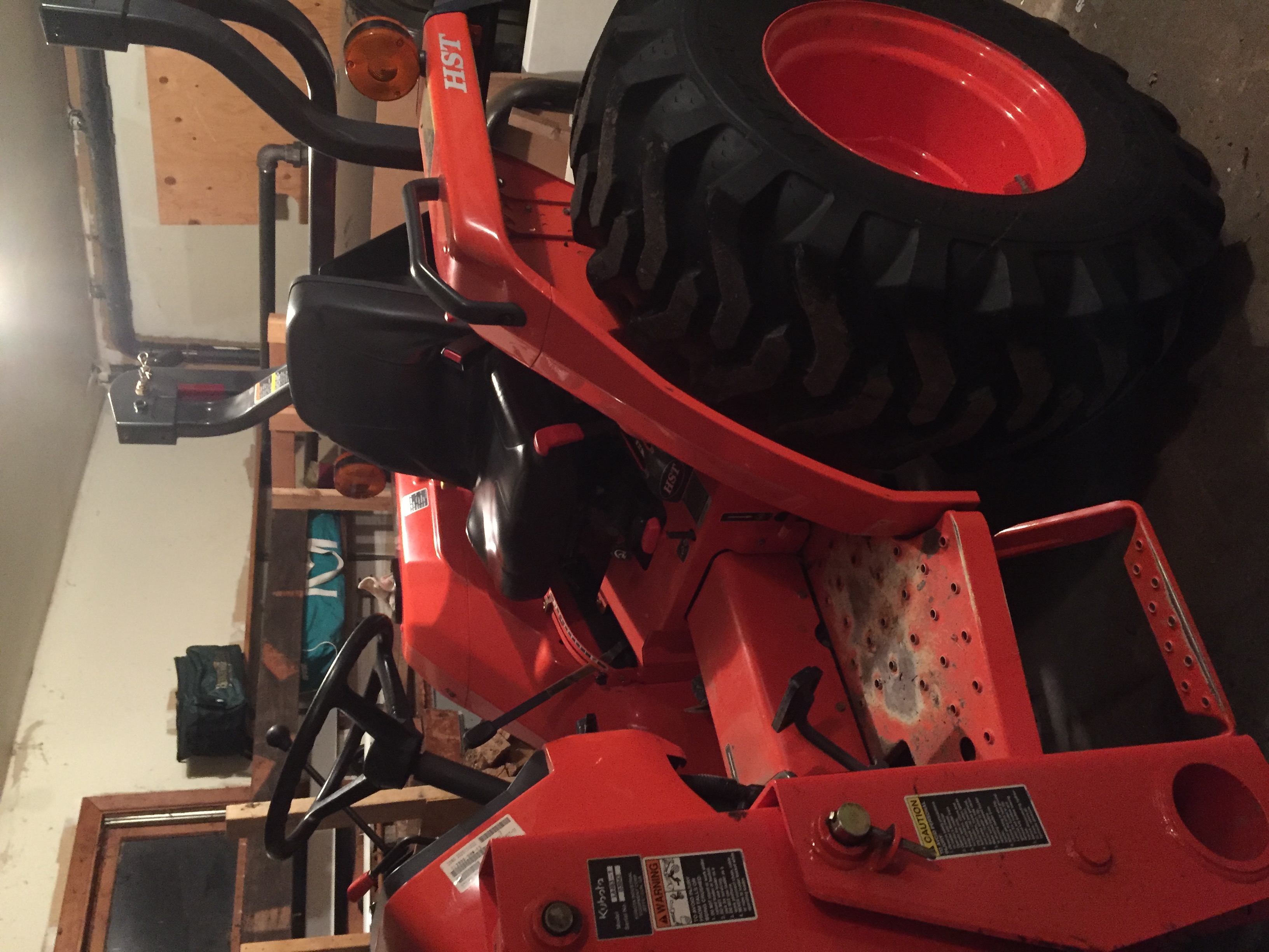

Can anyone tell by this photo if the 4wd control lever is in the 4 or 2 wd position?
The 2 biggest concerns: The badly rusted rear valve stems. From what
I saw the rims look fine, but the stems are badly corroded.
And the fact that the owner stated that the machine ran in full time 4wd. He did not
know that there was a control lever. Thusly the tractor may have run for 216 hours
in continuous 4 wd.

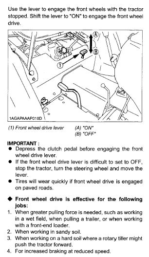

It looks to me that the lever is probably in the UP position. So, yes the Front wheel assist would be on. (4wd). But the only way to tell for sure would be to depress the lever..

The position of the lever appears to be in the 4WD position. If it were me, I would not be at all concerned that it ran 200 hours in 4WD (Unless he ran it at hi-speeds on the road). Mine has been in 4 WD 98% of the time.

Looks like it is in 4 wheel drive. If he didn't spend all of his time driving on pavement, it is probably not a problem. On mine that lever is fairly stiff and hard to push down. What did he use the tractor for? How does the wear on the front tires compare to the rear? k0ua's picture sums it up well.

Can anyone tell by this photo if the 4wd control lever is in the 4 or 2 wd position?...
My guess is that it's in 4x4 Look at blue circle. The blue arrow is where the sight glass is...
Most of these tractor run 4x4 ALL THE TIME. It's a non-issue. I have 660 hours, 95% in 4x4. There is a reason why kubota does NOT sell R4 industrial tires on 2 wheel drive only tractors. I have taken my tractor out of 4x4 only to find out how bad R4 tires are for "traction".
