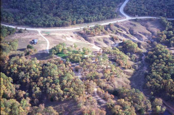

Kyle, the ponds I want to do are for me (see before/after attachments). I might do some work for neighbors, but will not transport the loader. If I can't drive to it, I won't do it. The only time the equipment would be hauled is when I buy it and when I sell it.
As Eddie suggests, I've thought of buying a dump truck to use for hauling, but a rubber tire loader might get me by in my limited area. I would never consider trying to do all of this with only a dozer or any tracked eqiuipment without a dump truck. The nice thing is this is all easy digging with very little timber to deal with. The hardest part is designing all the terraces so that drainage goes into the ponds as I want it to. My total area for the three ponds and access is about 6-1/2 acres. I think the rubber tire loader could handle transport since most of the digging has already been done by mother nature.:rolleyes:
