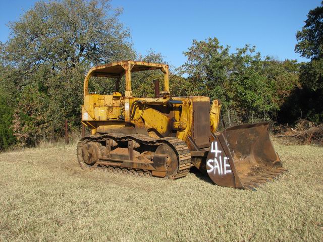

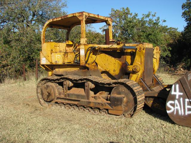

I was A dealer for I.H.C. for 20 years. The 250C was a good loader but 1 weak spot was the liner packing on the engine. I would get an oil sample done just to make sure no glycol is in the engine oil. Cold weather and sitting was the worst, we used to crack the drain plug and get 1-2 quarts of antifreeze and put it back in the rad. Also to get undercarrige for it is getting scarce as they are no longer built. Most other parts are still avaliable in used.

Thanks fordman6442 and dawoodwa. Your comments make a lot of sense. I was worried about the engine in the 250C because I looked at the dozer and realized the farmer who owned it didn't do much maintenance. I noticed glycol green antifreeze looking fluid around the radiator cap and wondered if antifreeze had been recently added. I was also thinking that if that engine had wet sleeves (probably did) then they were most likely pitted and ready to leak into the crankcase. It was just too much risk.
