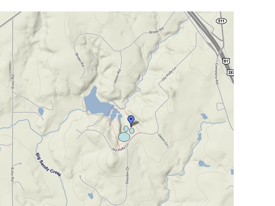

... The hardest part is designing all the terraces so that drainage goes into the ponds as I want it to. My total area for the three ponds and access is about 6-1/2 acres...

My concern is that if you build these ponds, will the bottom pond get any water? or will the upper ponds catch it all???
Eddie, you have to live here through a very wet year to appreciate what I'm trying to do. Both of my existing small ponds get overwhelmed with water when there are rain storms dropping 3" or more. Several storms over a week can really put a lot of water through my two ponds because of the drainage. I've included a topo map attachment that shows basically where I want to build ponds and catch some of the drainage. My 22 acres is outlined in red.
The largest pond I'm planning is fed by the surrounding hillsides and the only pond I'm worried about keeping full is the highest pond that would be fed by drainage from the hillside right around my house. That one will have to have terraces to redirect water flow. It would also be the easier one to fill in if it won't hold enough water. There's also a natural basin very close to where your dad parked his motorhome that could be easily converted to a pond. I wanted to fill it and make it a garden, but I'm having more and more trouble deciding how to do that as I begin planning.
As I find out how much dirt I have available, I'm sure I'll make some changes, but right now I'm more worried about the highest pond than the lower ones.
