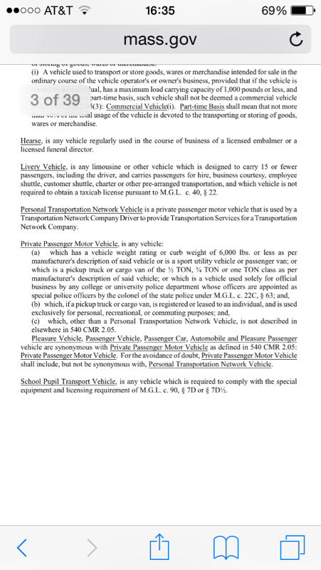

The GM trucks will do all that the others will do. Sheesh. The 2500s are limited in payload by trying to keep under the 10,000 weight limit. Some states require commercial plates at that point. In MA you need a waiver to register an F350 with personal plates now. The 3500 is nearly same, just with rear overload springs. Ride is the same. I think axle choices and trim packages are limited though. Get the 3500. You'll be happy you did.
That's news to me. A duelly in MA needs commercial plates due to the definition of commercial vehicles in MA. More than 4 tires touching the ground is commercial (there is more to it) . A single rear wheel one ton does not meet that definition so it should not need to be registered commercial. Unless there was a change in the law that I'm not aware of. Some of the inspection stations will try to scam the more expensive inspection for vehicles over 10K, but if it is not registered commercial it should be $35.
