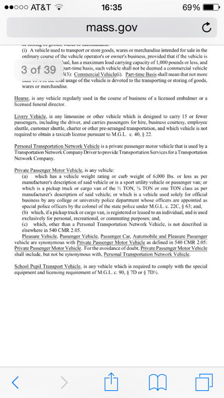

That's news to me. A duelly in MA needs commercial plates due to the definition of commercial vehicles in MA. More than 4 tires touching the ground is commercial (there is more to it) . A single rear wheel one ton does not meet that definition so it should not need to be registered commercial. Unless there was a change in the law that I'm not aware of. Some of the inspection stations will try to scam the more expensive inspection for vehicles over 10K, but if it is not registered commercial it should be $35.
Thanks for the reference. This contradicts what I've been told at the registry though. My dually 87 dump in my avatar was registered with personal plates, where as my friends newer SRW F350 pick-up had to be commercial. The registry told the both of us that is was based on the manufactures rated GVWR. May truck was rated 10K lbs and his was over. I registered mine in Wilmington I think. The registry in Springfield made him get a notarized statement indicating that it would not be used for commercial purposes.
This was about 5 or 6 years ago though, so it may have changed. I wish it was more clear cut.
I should also state that I heard that GM GVWR thing from a dealer, so that could be total malarkey. Should have prefixed my post above with: "A rumor I once heard..."
