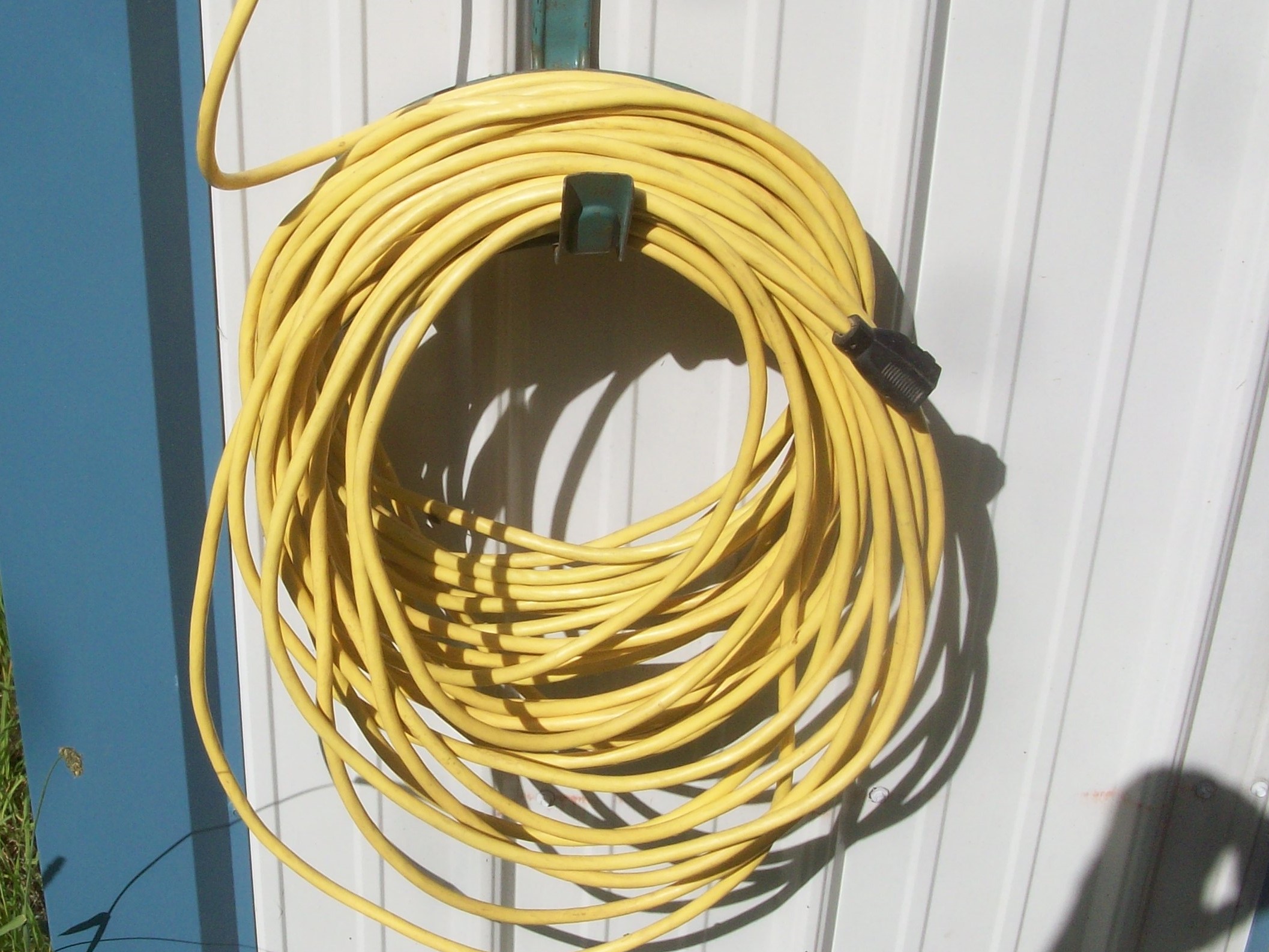

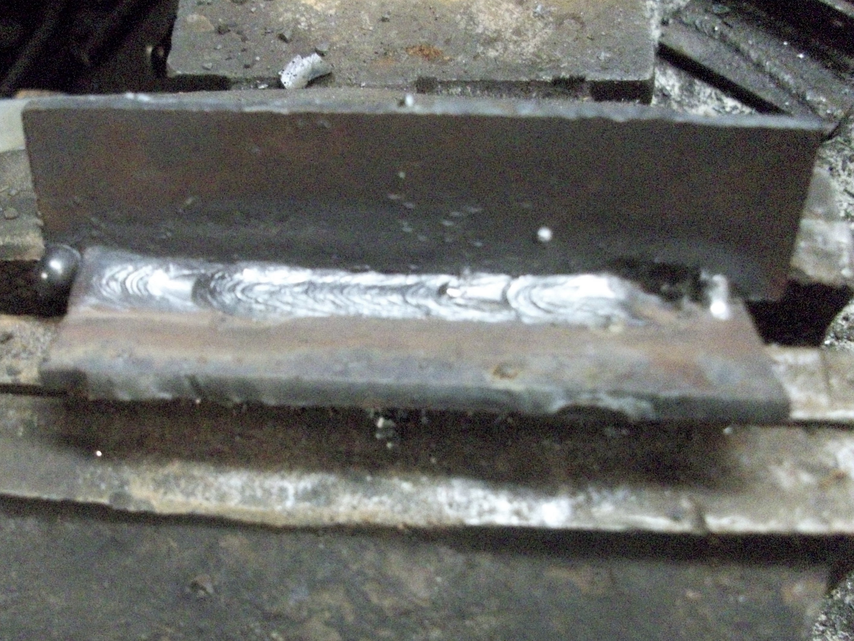

The extension cord of 100 feet being used and welding with 1/8 7018 got me wondering...if my Lotos plasma/tig/stick would be able to stick weld the same as posted.
So I tried it with my 14 gauge? 100 foot extension cord on 120 VAC using 1/8 7018 and it did weld but the arc seemed to drop out a couple times on the short weld. Also had to turn up the amps to full power to.
Camera needs charged and haven't found the charger yet will post a pic if I find it.
Got a pic,
100_8546 (2).JPG and cord
can see where I had to restart the arc (middle left) and then where it dropped out the second time on right and that's where I left it.
With a better 100 foot cord, think it would definitely hold the arc better. no problem when welding at 240v

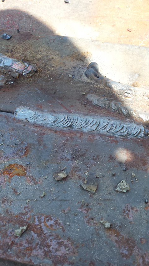

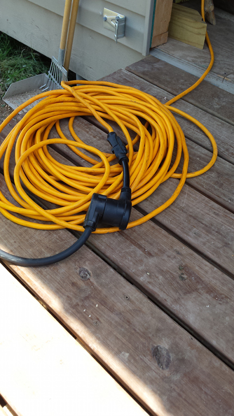

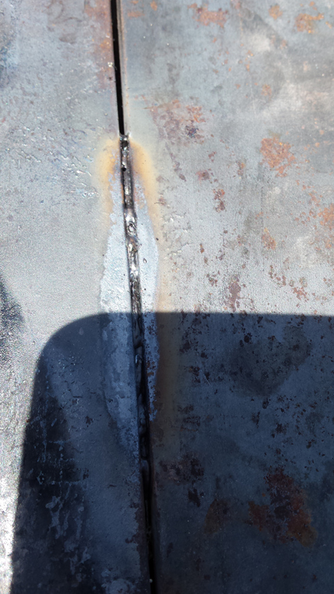

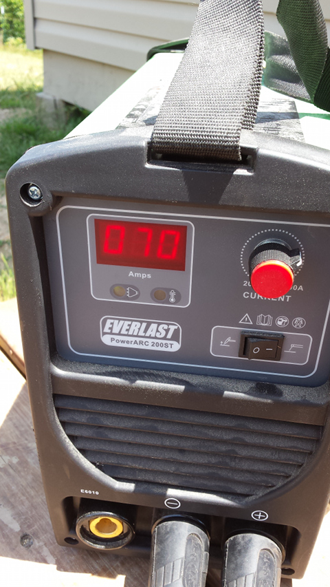

Just in from welding. I could not weld and read clamp on amp meter. So will have to do without that bit. Used a phone to take the pictures. then had to resize. Hope they came out all right.20180607_143228.jpg20180607_142928.jpg20180607_143258.jpg20180607_143303.jpg20180607_143258.jpg
Welder setting DCEN
Extension cord with 120Vdongle
Weld 1/8" Hobart 7018. No rod oven, stored inside the house, ac running
Back side of 1/4" plates.
This was done on a 20amp dedicated circuit outside my shed.
Hope this is enough info. Please excuse my welding skills. I did not clean or prep the plates.
