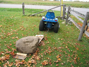

Good pic on link below, takes less tractor with a stone boat than to move it with a loader. Work the corners with leverage to shift it.
View attachment 431118View attachment 431119
http://www.mytractorforum.com/71-ford-post-1990-new-holland/153532-homemade-stone-boat.html
A very good method and one that I'd recommend.
