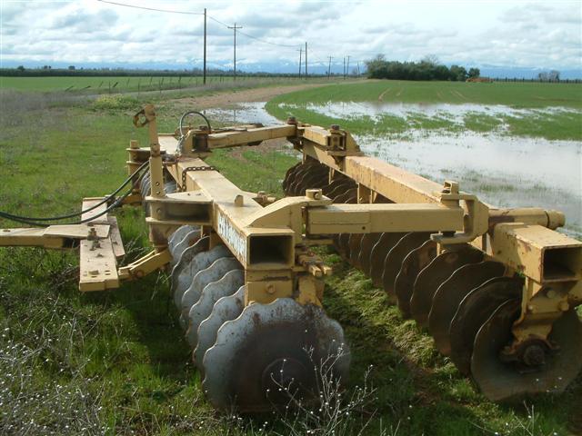

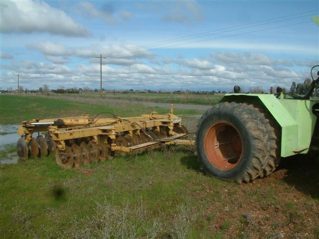

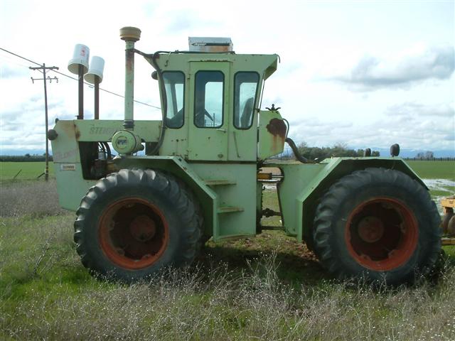

Is that 200 acres of hay? If so, I would think that the M7040 is on the small side. My neighbor farms about 200 acres of hayfield using 100-175 hp tractors including this 165 hp Steiger Super Wildcat.
You need lotsa horsepower to handle 20+ ft-wide implements you'll need to efficiently farm that much acreage.
Like a lot of farmers, haying is my neighbor's 2nd shift and weekend job. So he needs large equipment to get the planting and harvesting jobs done quickly and efficiently. Harvesting hay can be especially time-critical because of variable weather conditions so speed is essential.
