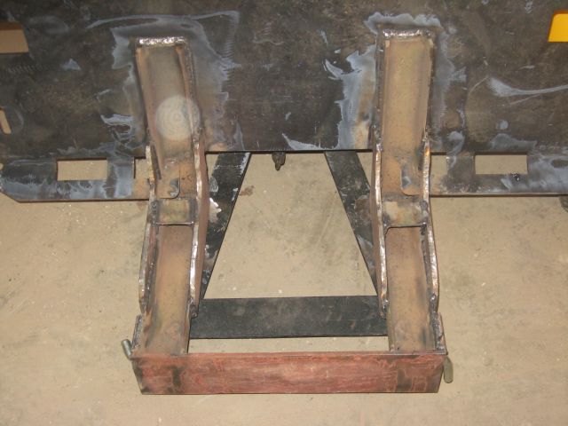

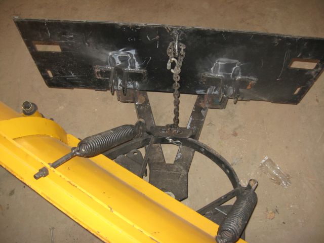

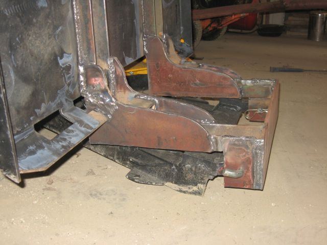

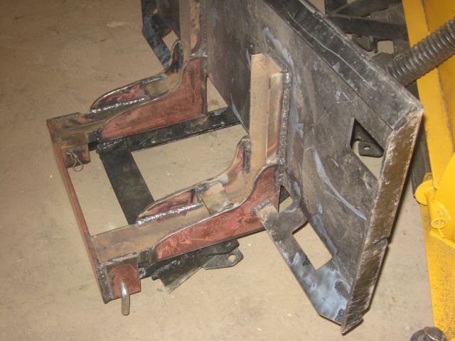

Just started mine today also. I bought mine with mounts on the front of the QA adapter plate but am changing to a rear mount so the plow doesn't stick out so far. I was able to move it back about 14" behind the plate. I'll post some pics if I finish it this weekend.
Here's a pic before mods

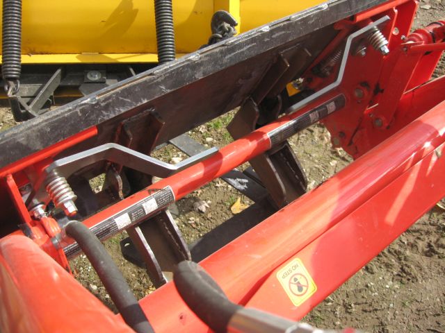

Any problem getting the Quickatach to work if the plowframe is mounted under it?
   / Looking for fisher snowplow adapter #13
Hi.

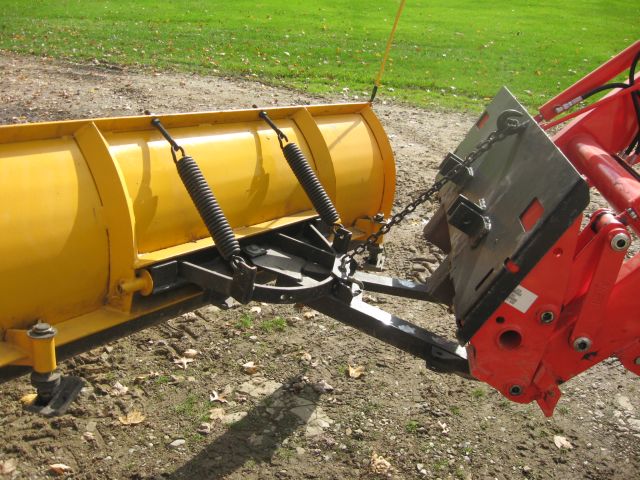

No problem at all. I just finished welding it up and it goes on and off easy. I just have to paint and I'll be ready for snow.
Jeff

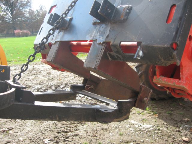

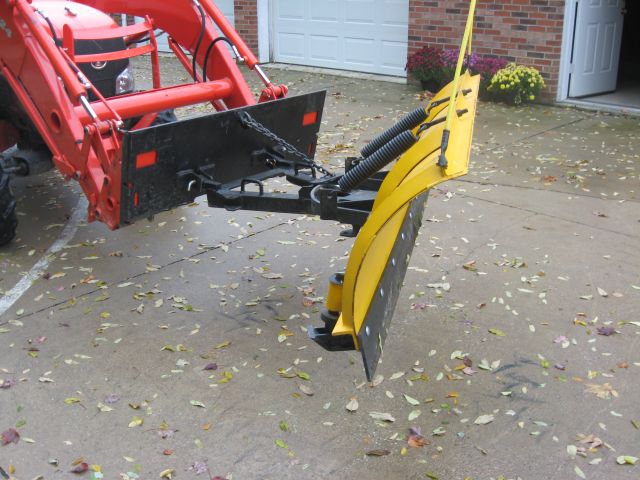

Some more pics. With the bar on the loader I had to drop it down 5" and then back 15". I could have gone back more and still have full angle but I was worried thar would stress it too much. That bar makes it harder.
Jeff

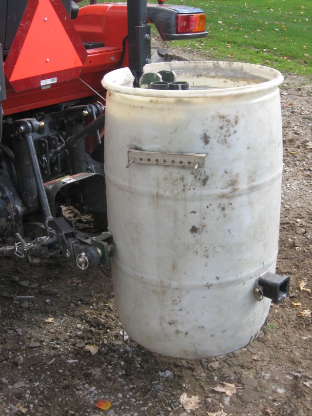

I also made a ballast barrel. It has a receiver hitch and a place for a chainsaw scabbard. I left the concrete 4" so I can put gas and oil and chains on top. Also put in plastic pipe for shovels,rakes or whatever. Should make the plowing easier.
Jeff
