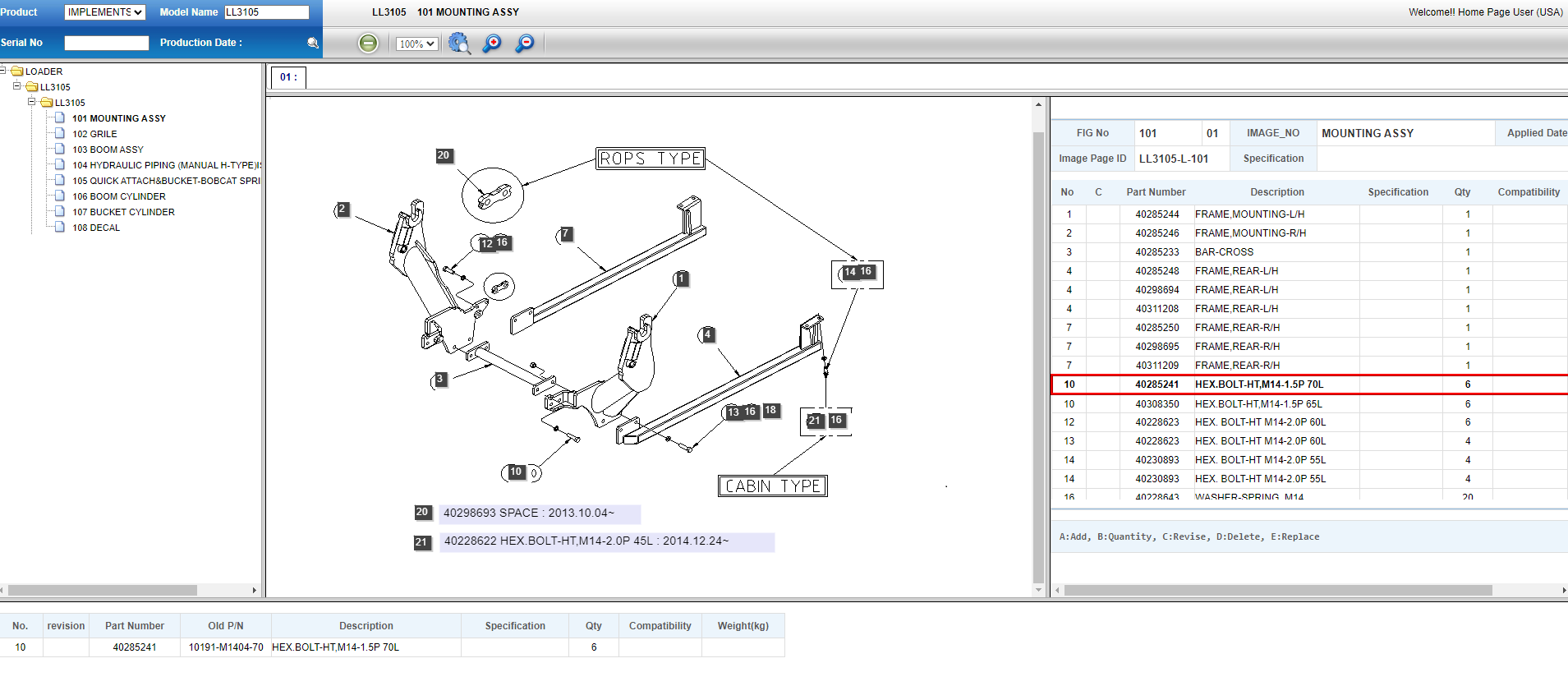

You may want to triple check your bolt thread pitch.
I checked the parts catalog and they list M14x1.5 which it a lot easier to find. M14x1.25 is pretty much an odd size and most likely a specialty thread of some sorts.
Quoting my own post for the picture.
I still think it's a better idea to confirm the thread pitch first before going crazy on re-tapping something that may not even need it. It's highly unlikely that the thread is M14x1.25 but rather M14x1.5. Even the parts catalog says it.
Tapping a 1.5 thread pitch on top of a 1.25, will only result on stripped threads. The only option is going a size bigger to M16x1.5.
