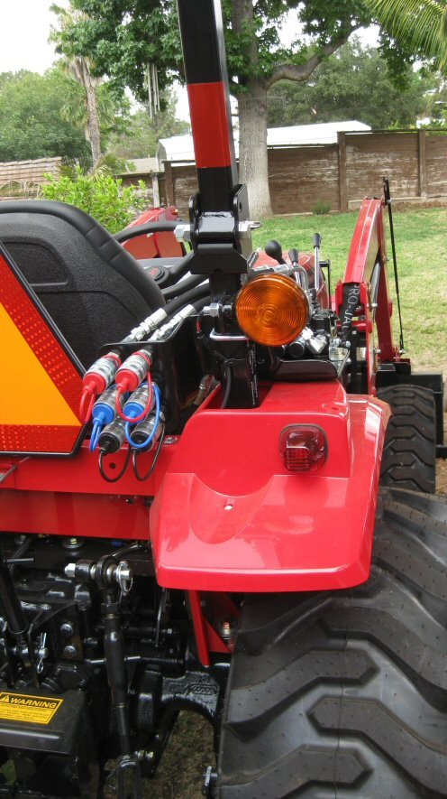

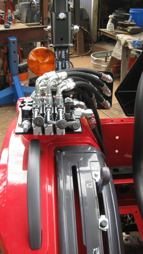

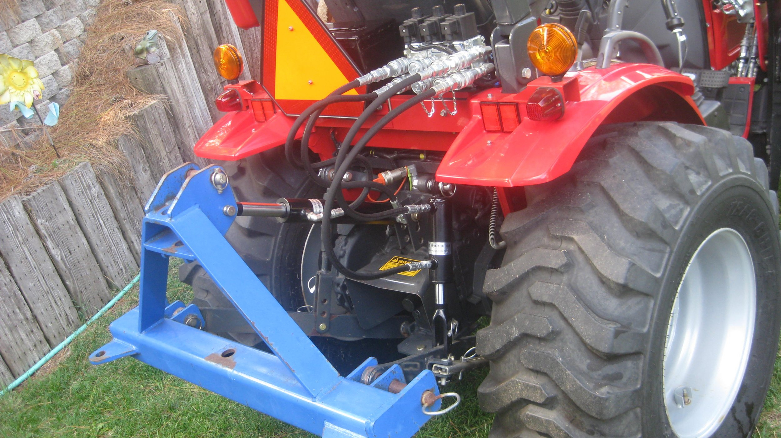

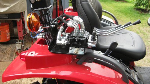

Well, add a top & tilt set and that will get you a lot of adjustment at your finger tips. :cool: Between the side link adjustment and the rear blade, you can get a pretty steep angle.
You can start spending some money though to get all those hydraulic adjustments, but they sure are nice.
I have to be honest though, not a single time while out operating my machines have I ever even thought about what the cost was, never enters my mind. :)
