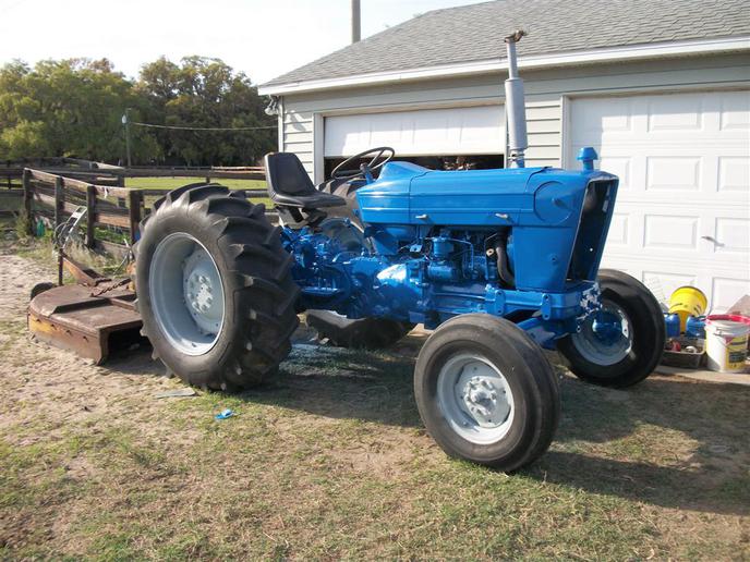

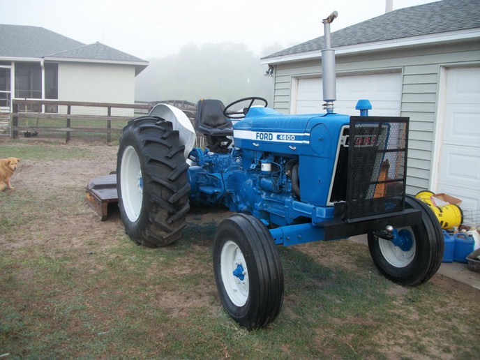

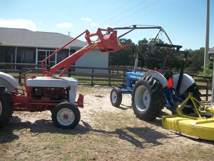

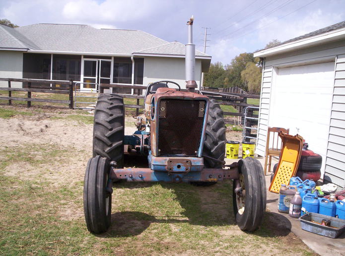

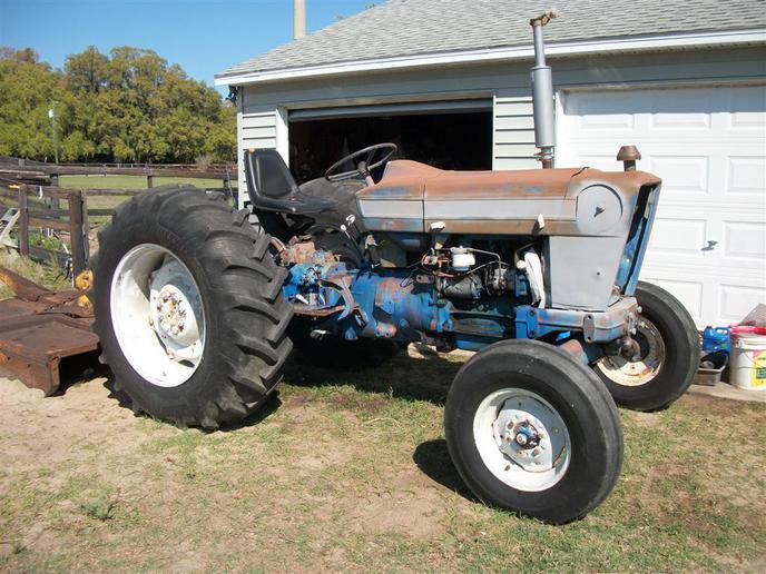

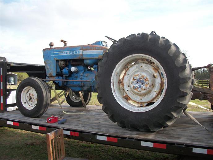

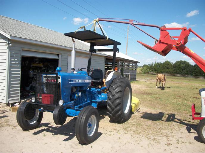

Get a ford 4000 or better yet.. a 4600.. plenty of hp for a 6' cutter. 8spd trans... ind pto, wet brakes.. get the diesel.. the 3 cyl jobs were virtually bulletproof.
3900$ got me a 4600 and beater 6' mower.
I put a lil time and money into fixing both up, including rops and paint. probably didn't put in 2 weeks worth of real work, and probably not more than 700$ either, including rops, paint and oil change / small parts repair and a front grill.
mower just needed welding an greasing and a coat of leftover paint.
thus a few hundred less than 5000$ from zero to hero...

VERY nice job you did on that tractor! heck i would have been happy with it like it was when you brought it home! i'm keeping my eyes open for a good older Ford but they sure are tough to come by in my area, and by the time you hear about one it's been sold. i'd sure be proud to own that tractor though! before and after the work was done to it!
   / Looking to buy a tractor strictly for bush hogging #14

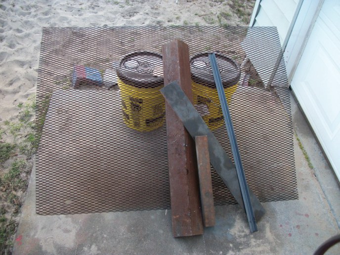

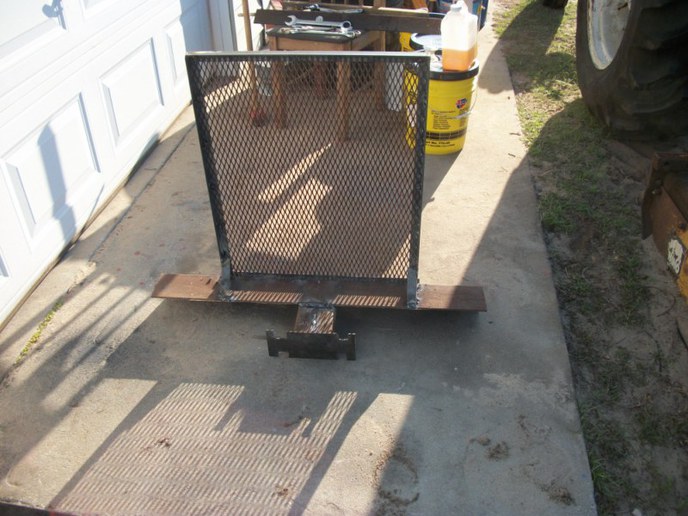

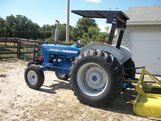

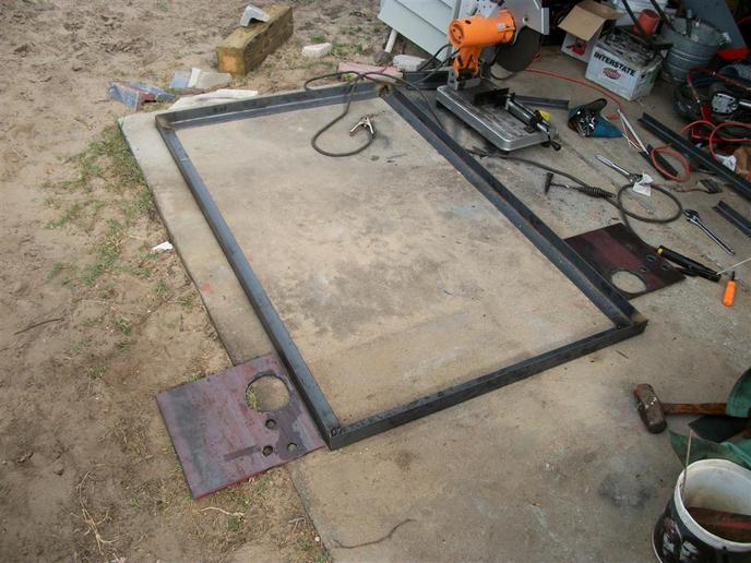

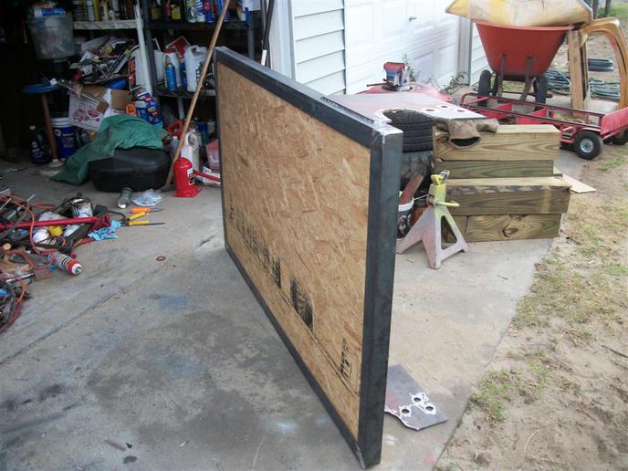

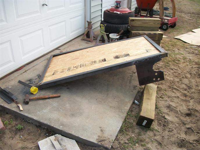

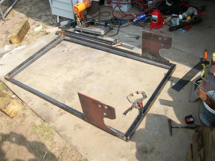

I even built that topper too.. patterned it off a ford topper on my 5000 and then buzzed and chopped it outta scrap, marine plywood, and heavy rubber matting.
that front bumper and grill guard started out as scrap too. rescued from the pile at work, to protect that new 50$ grill, and radiator from trree limbs.
keep an eye out... look on Clist.. and at dealers for trade-ins.. that's what this was.. and I came alog at the right time..
