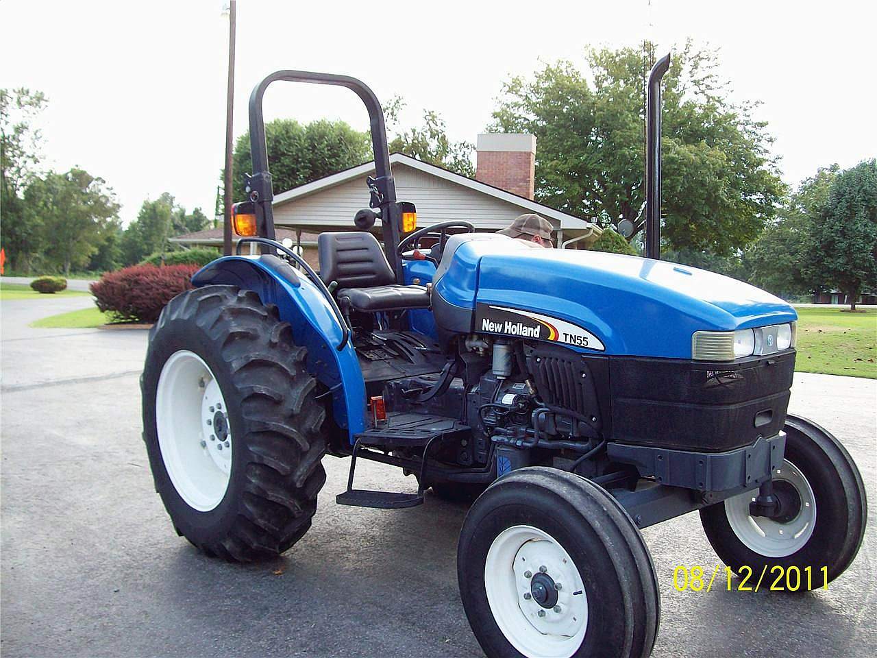

newholland.jpg 2002 TN55,161HRS,$10,000

I have thought about buying a tractor for the same purpose, just to brush chop with it. I had this idea of buying a FWA tractor in the 50-60 horse range and build up a forestry type cage around it as well as skid plates and such to protect any vulnerable parts. We have a lot of ground we maintain and each year it seems were either clearing a new piece of ground or clearing back the brush thats leaning in so a cage would be ideal for us. But I just want a nice tractor that I can drive into the red brush without worry, something I can set the wheels wide on it and leave it.
I would think for your price range you can look at fairly new 2wd tractors. A 2wd New Holland TN65 only cost around $15k 10 years ago so you should be able to expand your years to include the early 2000's.
