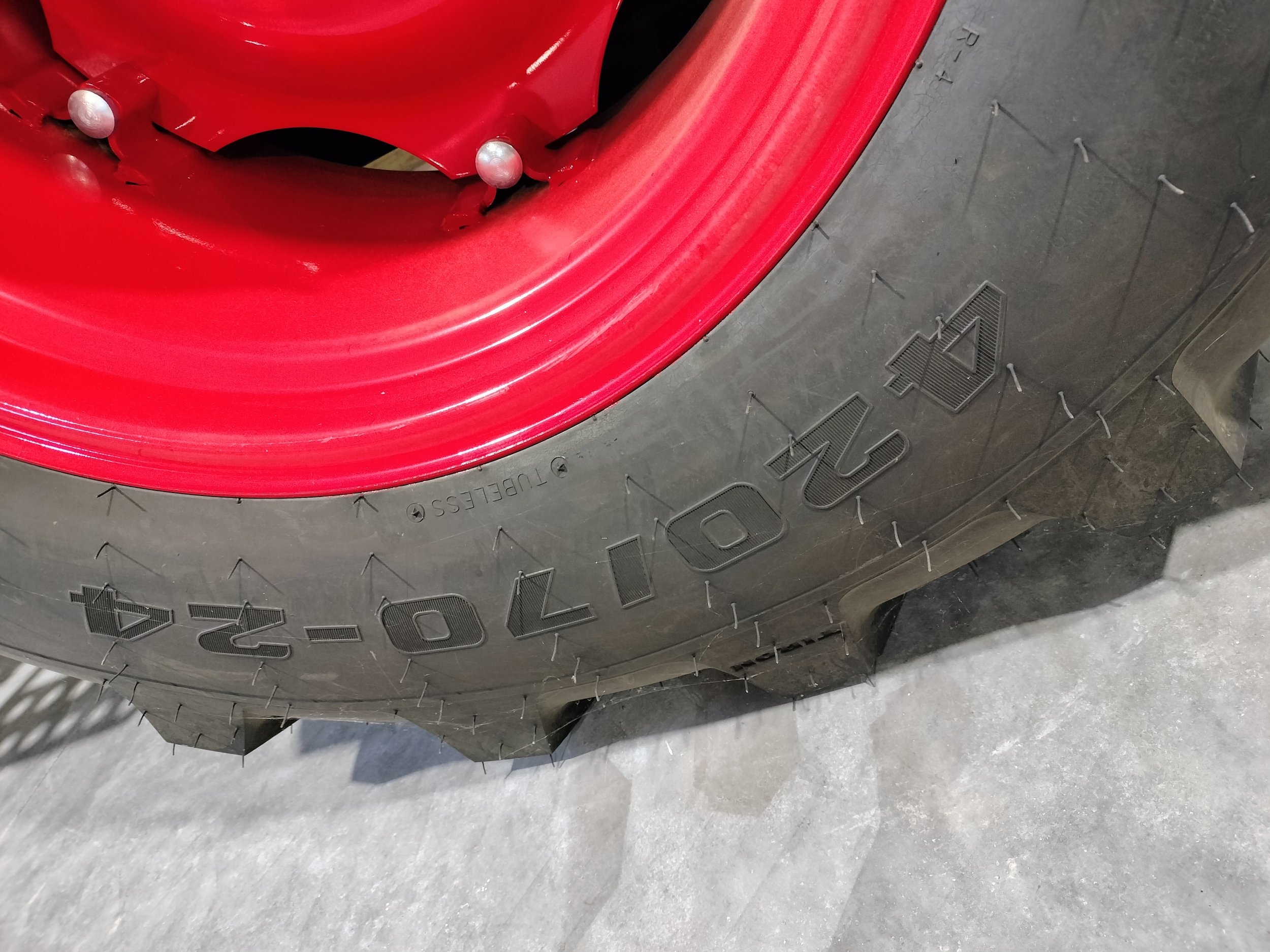

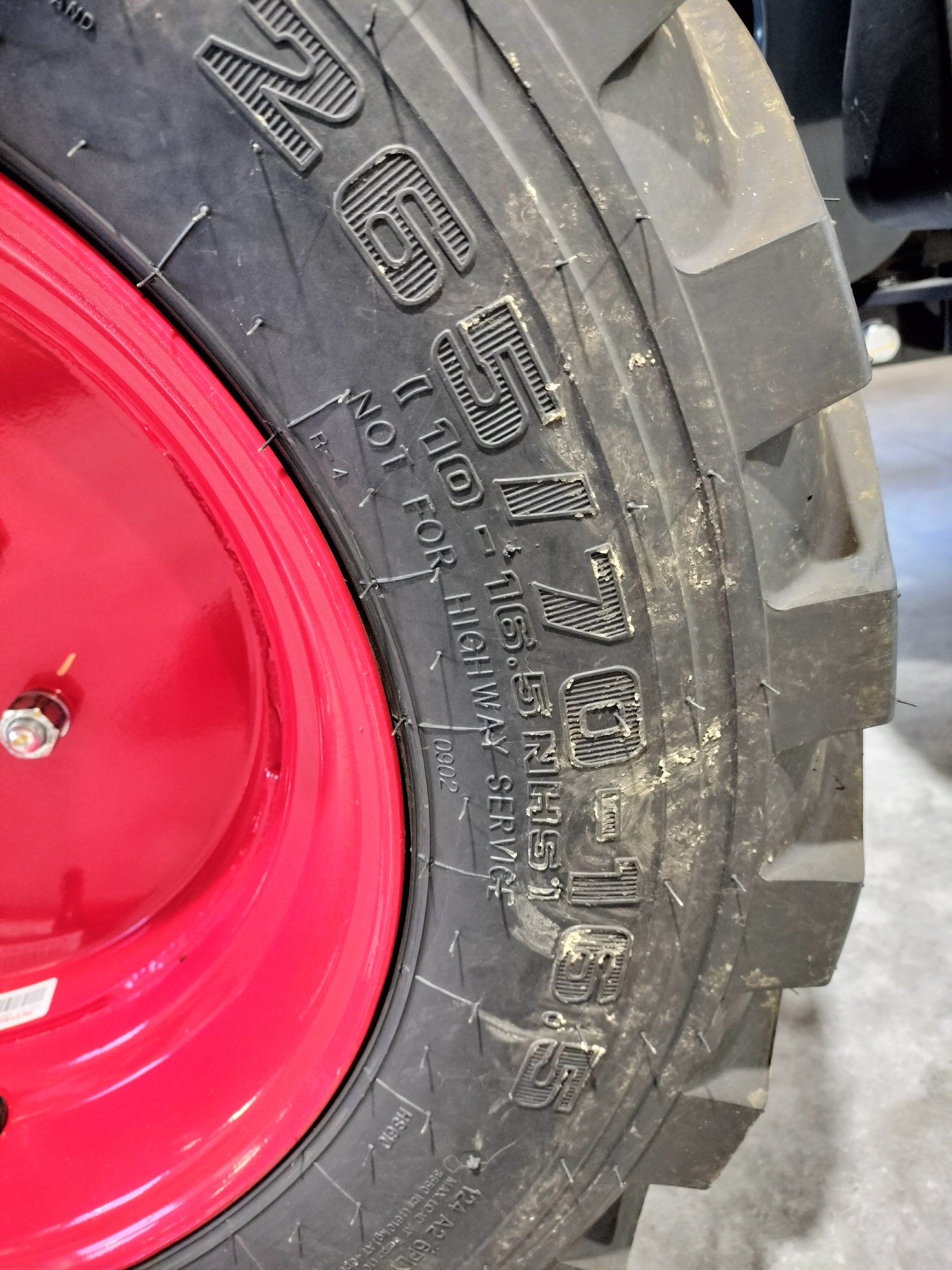

The dealer cannot get it with R1s? Odd
No, its his only Branson / TYM with that tire size unfortunately. I am now leaning towards a 494 now as I have a closer dealer that has them, I just wanted the all steel and heavier rear end of the Branson.
   / Looking to pull the trigger on a 4820H but... #9
That is strange. You should be able to get R4 or R1 (or even R3) on any TYM in that series.
I got the R4 on my 574 because I mostly have forest and over 50% is FEL related work. If it is that muddy, I don't want to tear up my property and fortunately, I'm not making a living from my property. I just postpone the work.
I would personally only get R1 if I could get the radials like @ptsg mentioned. Different applications call for different tires.
I wish I could find out the specs on their AG tires, cant seem to find anything other than size.
Pretty sure they are Titan but dont know ply and sidewall info.
