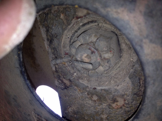

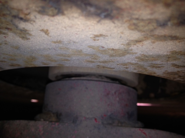

I have a bushhog sq 60. This weekend i when i engaged the PTO my tractor (kubota 3130) would shake really bad. I searched the forums for a possible reason and i checked the blades which seemed to be in good condition and moving well. But i did notice that the stump jumper was loose and it could be easily moved by just holding one of the blades and moving it back and forth. I haven't ever done much of my own maintenance but i really need to cut grass this weekend and if i take it to the dealer it will be a couple of weeks before i get it back.
I took a look under it and noticed it has a castle nut and cotter. Would i just need to pull the cotter pin and turn the nut? I have owned the cutter for 5 years now, so typically are they hard to turn?
I have attached a couple of pics. I am assuming the gap in the picture i attached shouldn't be there. I guess it is between the bottom of the gearbox housing and the top of the blade bar.
Any suggestions would be great!!!

After you first engaged the PTO and got the vibration...did it smooth out after 5 seconds or so?
After checking to see if the blades pivoted, did you try to run the cutter again?
I'm going to suggest you try your cutter again, before making any adjustments. You may have just had one blade locked up or jammed.
Normally, a castellated nut is tightened snug, then a bit more until the cross hole in the bolt and the nut are aligned to get a cotter pin in. But I suggest you check the manual (if you don't have it, here's a link: Manuals)
Unlike most nuts, a castellated nut cannot loosen unless the cotter pin breaks.
As far as the gap between the the gearbox and rotating components...doesn't look excessive.

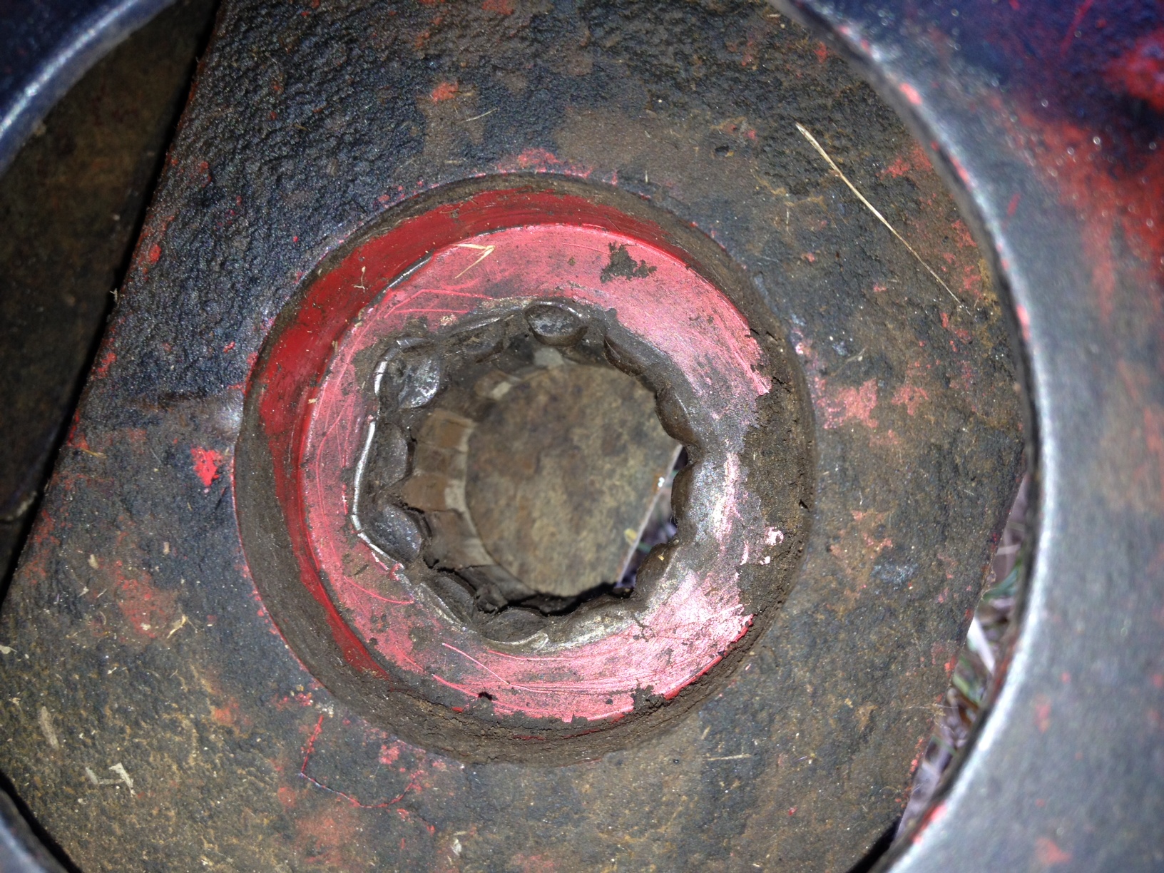

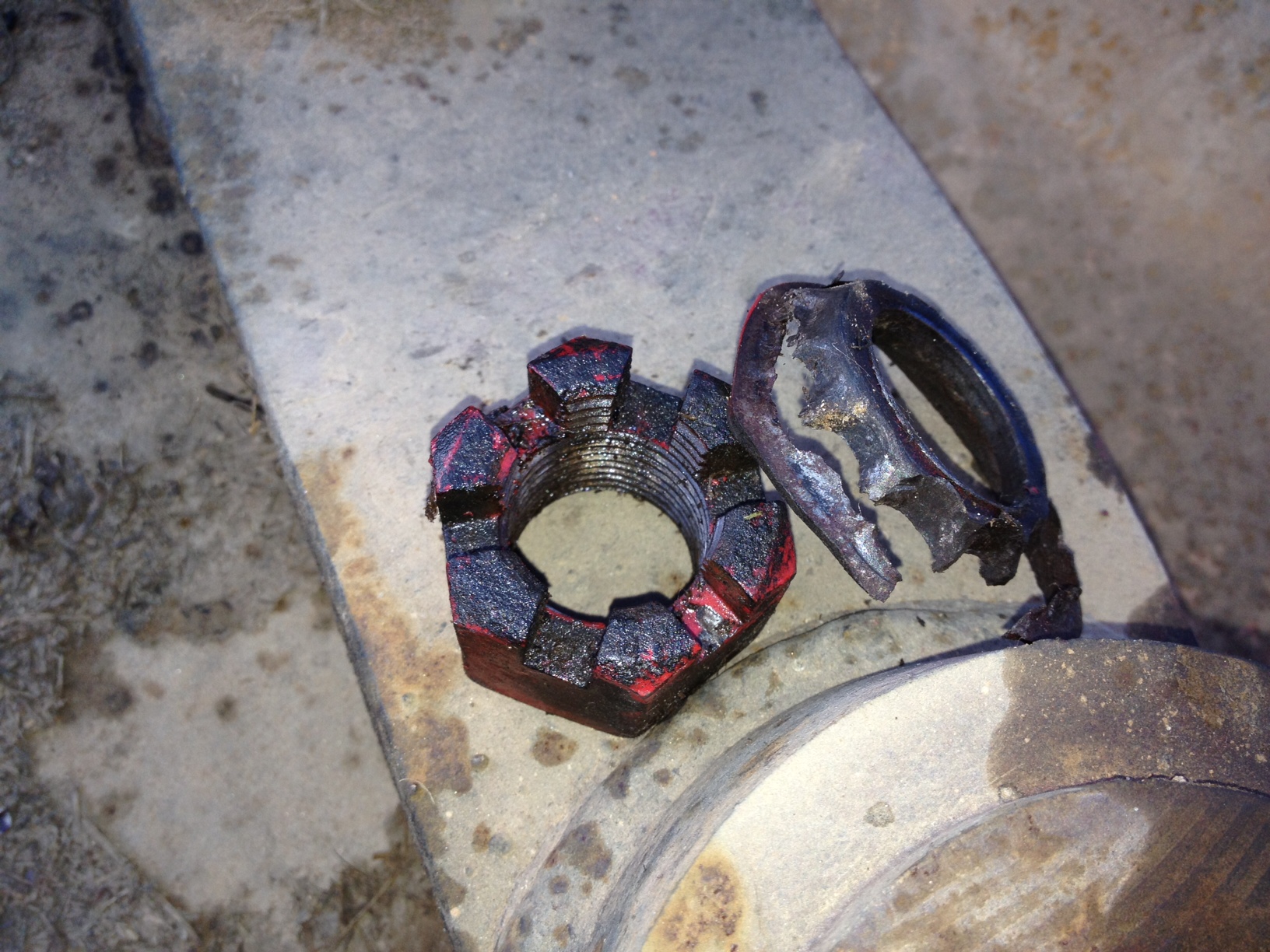

I went ahead and removed the stump jumper to see if anything stood out. Seems like the bolt washer had gotten mangled. The castle nut must not have been snug up against it. I will get replacements and see if it tightens it up.
Do you think i will need to get a file out and work on the splines?

Those splines could definitely use some work since you have it off. Be glad you have splines to file. Mine were gone altogether.
Those dings on the end of the splines make me think someone has been fooling with it already. Does the male spline have a taper? The one on a Howse BH does. If so, and the splines are there enuf to engage, probably replacing that washer and tightening the nut tight with a good impact wrench will assure that the joint stops moving and destroying the splines. Use a high strength washer. Regular low strength steel will crush and render looseness.
larry
/ loose stump jumper #10
larry
Almost looks like somebody has been in there with a welder. It is hard to tell from the photo, but a SQ60 is likely to NOT have a tapered spline. My SQ 72 has straight splines. With a little wear in the shaft/blade bar splines it is hard to get all the vibration out regardless of nut torque if there is no taper to work with.
