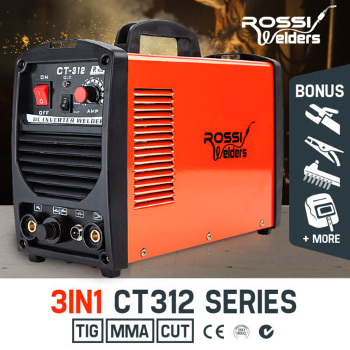

I recently bought this thing on Ebay. 'Rossi CT 312'.
30 amp cutting and 120 amp welding. $339 over here, complete with welding cables, plasma torch, tig torch, and air regulator.
I've seen virtually identical machines in different colors with different brand names so you probably have the same ones over there. At this price I didnt expect much but my first impression is very good. Actually, to be honest I'm thrilled with it. After 15 years struggling with a $90 AC welder this is heaven. And the plasma cutter just plain makes me smile. Its only 30 amp but I'm cutting 6 mm easily (but slowly). More importantly for me it sails through 3mm stuff. The only real negative so far is that the welding cables are very short. The earth is only 1 metre and the electrode holder is 1.5 metres. If this gets too annoying I'll buy some longer cable. (The plasma cable is already at least 2 metres).
I don't know how long it will last. Thats always a gamble with Chinese stuff, but I'm feeling positive. Its only for backyard stuff, not continuous work.
I'll be modifying a sack truck to carry this and a 30 litre compressor together.

If you look at enough of them you start to see parts that are the same, just different colors. And specs that are near identical (same inverter/psu etc.) so its obvious the same factory is supplying all these guys. I guess it comes down to support, quality standards and availability of parts or you can just toss and get another one for that price!

I've read the MOSFET thing but can't touch the other type on cost. I see Everlast's cheapest unit is MOSFET and is $600. I do like the idea of being able to run it out away from my house on 110v but having more power when needed. The Rossi unit looks good but only if the seller will guarantee it for awhile and be in the US. Hutchman is correct on many of them looking identical. I'd like to try TIG but that would mean more stuff to buy to make it work.
