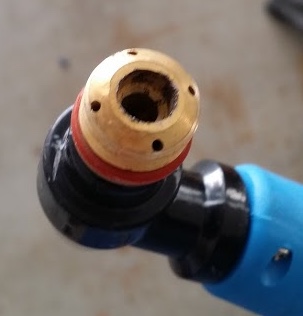

I ended up ordering the Lotos and it showed up on Wednesday. I had a $40 Amazon credit, so I took a shot at getting one for $200. I had a chance to quickly try it out and it works. No air leaks and it actually worked right out of the box. It cut through some sheet metal easily on 120v.

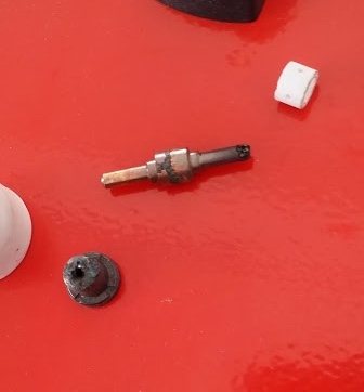

I definitely see the advantage of Pilot arc. The torch tip gets pretty messed up quickly having to be in contact with the metal being cut in order to start the plasma. I'll definitely need to keep the grinder handy to clean up the metal surface before cutting it and keep a good supply of consumables around.

Is it a push start with a spring loaded tip, or just contact start? You can prolong electrode life by holding the tip at an angle til it starts and rotate it down near perpendicular to the surface. I use 1/4" Masonite (get free from furniture movers) to make my guides. You only need to clean the first inch or so of your cut after that the arc will pierce most coatings.

It is contact start, no spring.

Yes it does if your settings are correct and you keep that torch slowly moving steadily along. I've been using the same Masonite straight edge for over a month. I also cut lots of circles that way to make fire wall sleeves.
Edit to add: Don't know if your manual covers it, but on anything less than 3/8" let the tip stay on the metal. Your tips will last longer and you won't burn your guides.
