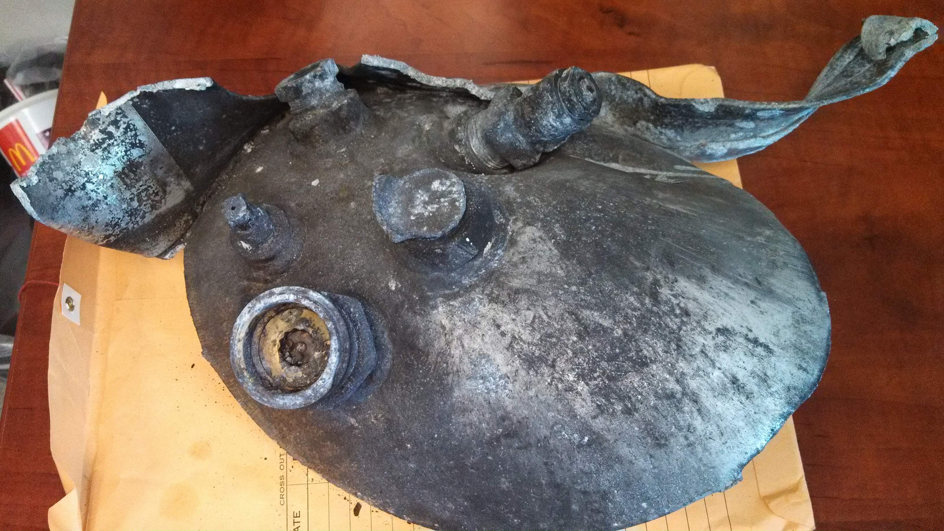

   / LP tank destruction #28
During the fire in 2011 at our dealership, there were lots of tanks that let loose, of course this wasn't your
average housefire. Investigators put temps well over 1600, and in some places 2100 degrees.
here's a souvineer i found a couple weeks after the fire, it was found about 200' behind the building,
so i picked it up and it sits in my office now. this was one of the tanks for the propane forklift,
not sure how many popped, but this one sure did!
   / LP tank destruction #29
That's a excellent picture of the results of a BLEVE (boiling liquid expanding vapor explosion). The heat from your building fire heats the liquid in the tank to boiling, excessive vapor is produced, internal pressure reaches the relief valve set point and the relief valve opens. If the tank is not sufficiently cooled, the rate of vapor production exceeds the relief valve's ability to release excess pressure. At some point the container fails, usually at one of the ends, as seen in the picture. If the contents of the tank are flammable (like your propane) it is pretty spectacular when it does fail. Pieces of larger tanks have been found more than a half mile away.
