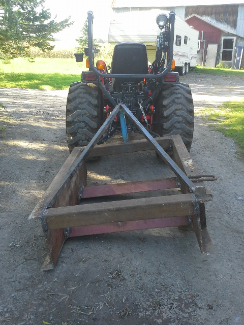

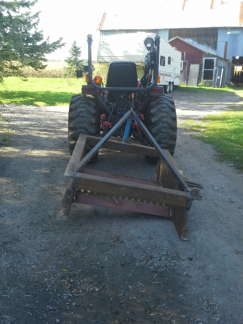

Good picture, but I hope you didn't weld them on that end!
   / LPGS build
#22
Uh, no. Needed the flat surface to jig them. Upright for the top link is in the way on the front. They will be welded on the front edge of the 4x4 not the top anyway

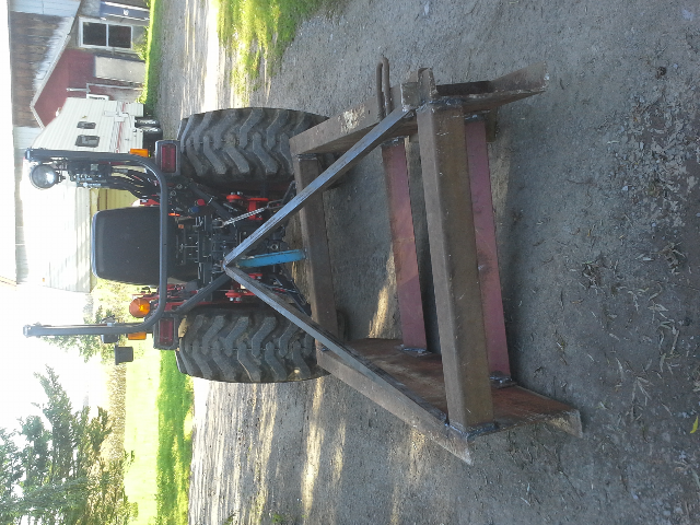

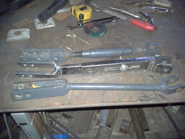

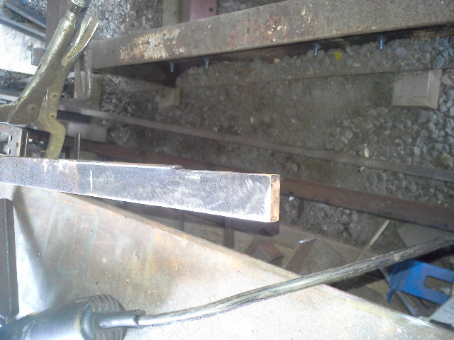

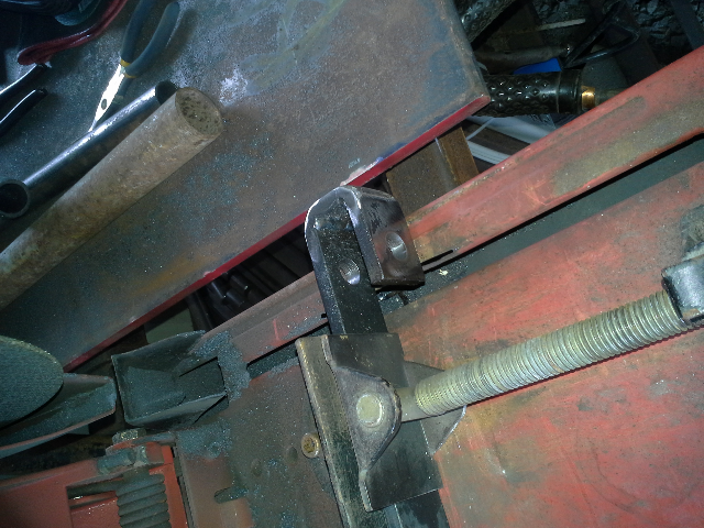

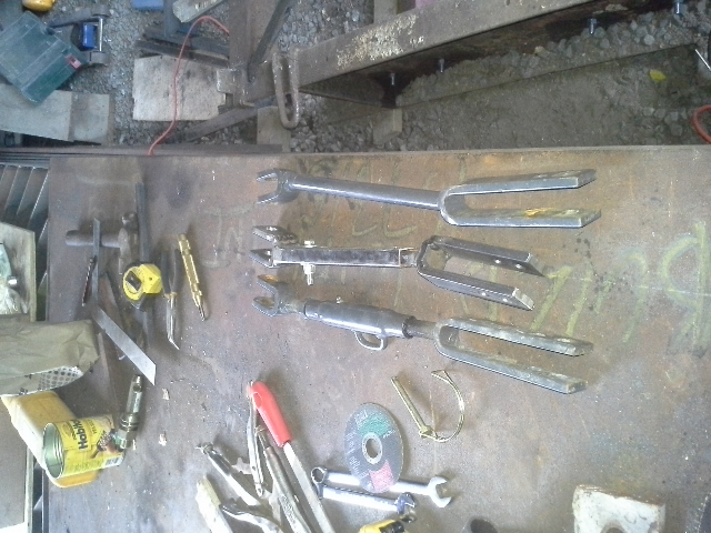

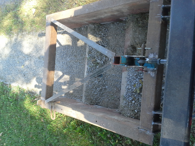

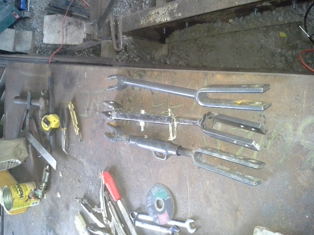

Life has been so busy lately that I haven't been able to update this until now. Stood the thing up on its end to make welding the hitch brackets easier as I'm not the greatest at vertical welding with the stick. The 4" of travel in my flex link translates into about 15" total articulation of the LP.
   / LPGS build
#24
8x8 block used to test the flex
Sorry for the sideways pics, I can't seem to get them to rotate upright on my phone

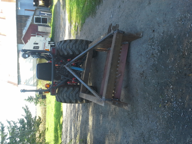

The first day I got to try it, the ground was too dry to be effective but I gave it a whirl anyway .
I've made about a dozen passes total so far over 3 different days. It certainly does the intended job nicely of allowing me to work the tracks without disturbing the center grass strip. There are a few things that aren't working as well as I'd have hoped....
There is a bit of spillage off both sides leaving a small ridge of gravel that I hadn't expected.
While the finished product looks nice, the potholes seem to return quickly.
At right around 600 lbs, the tractor definitely knows it's there when lifted but it feels too light while its working. More weight is easy to add to see how it goes and might improve the pothole removal. The interesting thing is that when I look up specs of commercially available ones, I'm at nearly double the weigh per foot of cutting edge by comparison. I can't imagine having one with half the weight and still getting decent results

You are comparing light to medium units. A heavy duty unit will run at 200lb per foot width. Another thing is if the ground is hard enough, even the 200lbs per foot is not enough. Some of it has to do with pitch that the blades are at, how far below the runners, not just the weight. Weight is great, but everything has to work together to be able to get the best possible results.
Try using it a day or so after some rain, then see how it works for you. Lots of things factor in as to how well an implement of any kind will work.
Good luck with yours. ;)

Now with frost well set in for the winter, this will be parked till spring until I can play with it further. I did have one chance to try it with some extra weight. I added about 200lbs of concrete slabs. It made a difference but I still want to try it heavier. In the spring, I'm going to load it down as much as the 3pt hitch will lift and see how it works. I expect to have to load weight on the front to keep it down while pulling it

Finally got around to grading my lane for the first time this spring about 4 weeks later than I wanted. Instead of the extra concrete weight I had on last fall, I added the 250 lbs slab of steel that I use for extra weight in the back of the truck for the winter. That puts it right at 850 lbs for a 3' wide cut. I also lowered the front blade to its lower setting, now at 2.5" below the runners. I'll likely still add some more weight to see what I think. Weight is definitely your friend with one of these, the more the better.
About 8 passes over the lane and I was able to get most of the potholes worked out for now. I expect them to come back but with it now out of winter storage, it will be easier to grade again. I know my lane wasn't built properly to begin with so its an ongoing battle.
