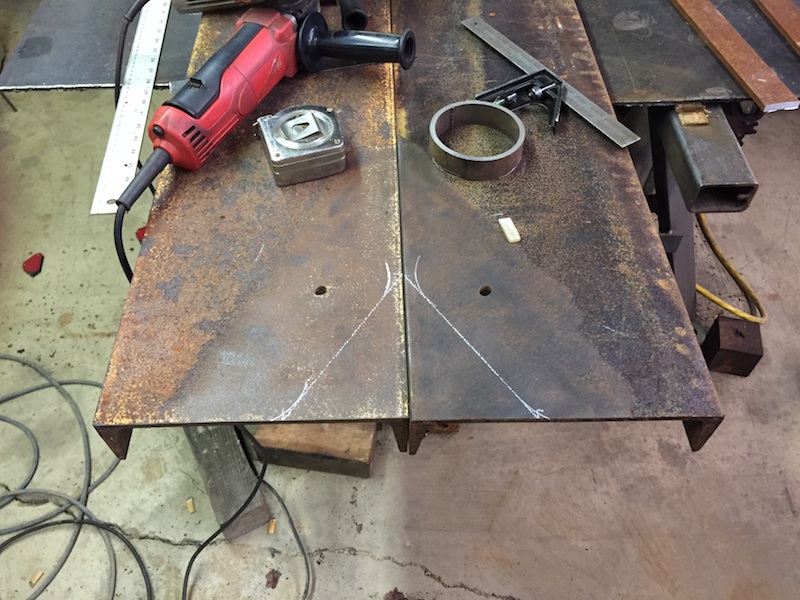

Executive decision:
6' wide x 4' overall, with 3' in length on the ground.
That will allow me to use the two 3' drops from the side plates for the tailgate and its stop.
   / LPGS For Kubota B2910 #14
Keep in mind the length is what gives the tool the ability to plane.
   / LPGS For Kubota B2910 #15
I would make the c/e adjustable, even if you had to do it with a series of holes and r&r some bolts. Not being able to do any "cutting" would be just silly unless you never expect to do anything but dragging around whatever loose material was on the surface. I guess I should have asked what you want to do with it.
I think your 10" chan. sounds good and as you said, the longer the better but you have to consider the weight waaaay out behing you! Charge up your camera:thumbsup:
   / LPGS For Kubota B2910 #16
Also, since the LPGS is wider than the tractor the sides can extend forward to keep the weight closer to the tractor to help in lifting it.
#19
Yeah ... rethinking this:
Executive decision:
6' wide x 4' overall, with 3' in length on the ground. ...
I'll keep the 4' length on the ground, and rather than cutting the side plates to achieve the upward angles at front and rear, I'll use some bar stock to form the runners and then plate them in ... less useless waste that way.
#20
As long as there is some portion of the ground above (and within) the plane formed by the four corner points of the skids/runners, it will always be capable of "cutting" ... even if the blades are mounted flush.
Of course, that ultimately might not be as aggressive as I'd want it ... so it just might be a good idea to make the blades adjustable ... ;)
Just have to figure out how I want to do it.
Yup ...
Took out the digital calipers while I was up there and checked it ... looks like it's only C10 x 15.3 so that's not quite as bad ... but using 6' of channel and cutting edge as the tailgate will add some weight to the rear ... along with the stop for the tailgate itself.
Actually had it on the charger in the shop while I was up there ... if I had remembered to bring the cord back down with me I'd be posting pictures right now.
Doh ! ... just remembered I can email it to myself from the phone and then collect it on the desktop ... so here ya go ... :D:
