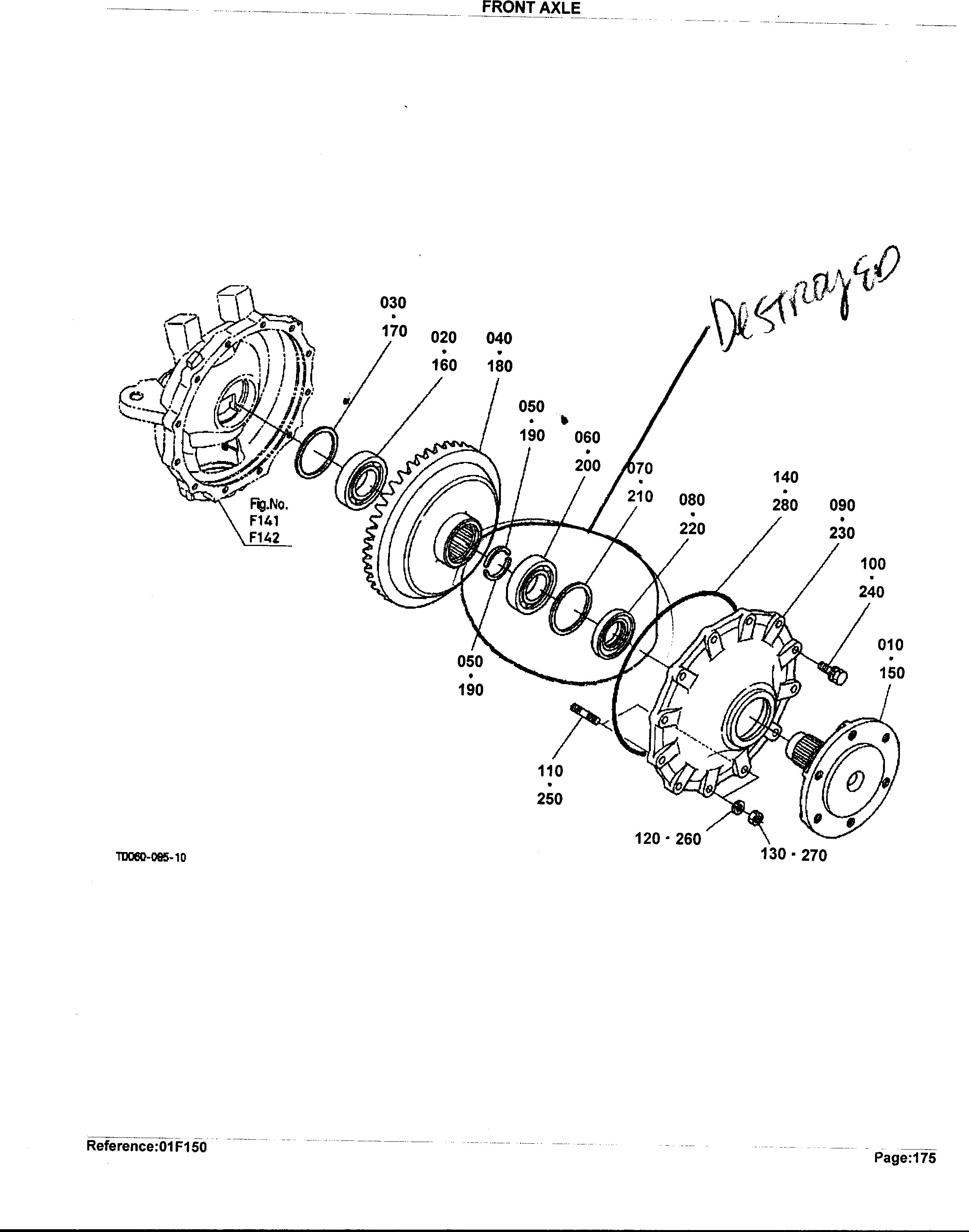

I blew out my front left seals. I was using my backhoe to manuver tractor. This put way to much pressure on front end! I need diagram of front wheel seals I cannot seem to find it online so far. Can any body help?

OK so I got the diagram from tractorsmart. Haven't gone out to tractor yet.
Will take pictures and post as project develops.

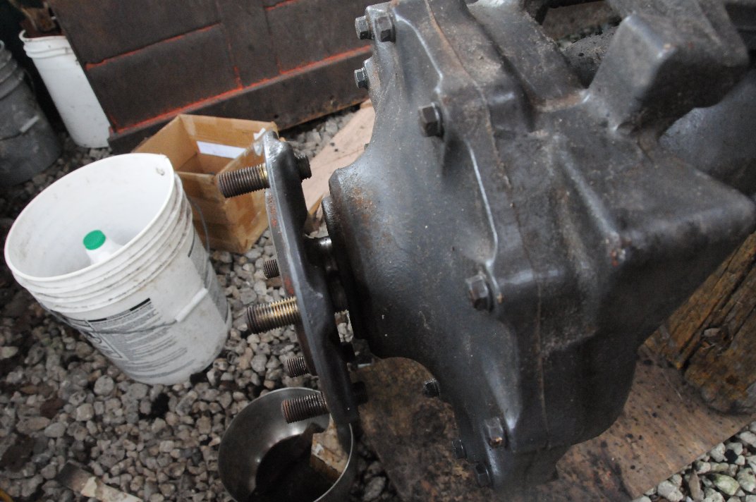

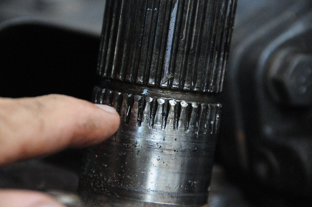

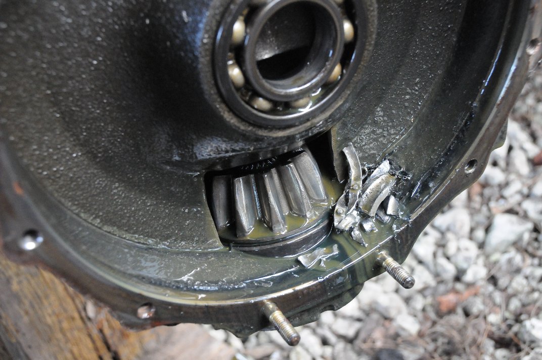

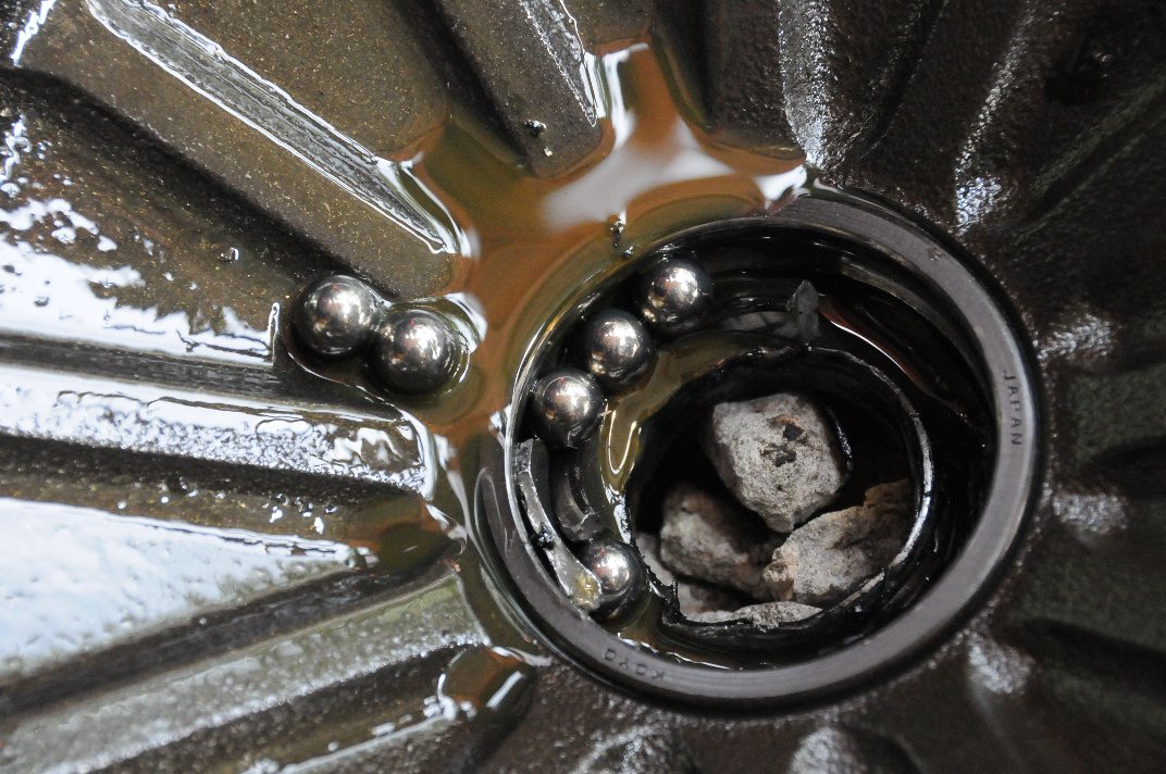

I opened it up today and bearing was destroyed. very little oil left in unit.
Tractorsmart has sent me the wrong parts list diagram I see now they sent me for a different model.
I will try and load pictures. Some minor damage to spline hub shaft. Finger pointing at. I hope I can by with this. a couple of very minor knicks on lower gear.
Now can I replace this bearing seal etc. myself or should I just take the parts into the Kubota dealer and have them press the bearing in? If I can do it myself I am going to get tractor smart to send me another pdf and order up.

Get the parts first. If you get stuck, see a pro. but I to not think it will be
difficult. With Kubota, gears are Expensive, but shafts not too bad. Bearings
can be purchased at alternatve places for about half, if imprinted with a
standard code.
Pix of the damage are always appreciated here.

This is my third try to load pictures I reduced them from size.
Worked this time
first diagram showing destroyed parts.
second cleaned up ready to take apart
3rddamage to spline hub
last two destroyed bearing and shredded parts.

......minor damage to spline hub shaft. Finger pointing at. I hope I can by with this. a couple of very minor knicks on lower gear......... can I replace this bearing seal etc. myself .....? .
I've found a couple things about Kubota parts - usually the bearings are NOT pressed in place - they fit very close but you can remove/install with light force. Kubota prices on ball bearings are usually quite low - no need to shop for generic bearings. Ronnie Bowman at Tractorsmart (Keller Brothers) is extremely thorough if he has your exact model designation. Sometimes, factory design changes require the serial number of your machine to get the right part.
The lower pinion in 4th picture has tapered-down tooth crowns - do they look like they were made that way or are they worn? How does the mating gear look? The splined shaft looks ok to use if the snap ring still seats in the groove.
