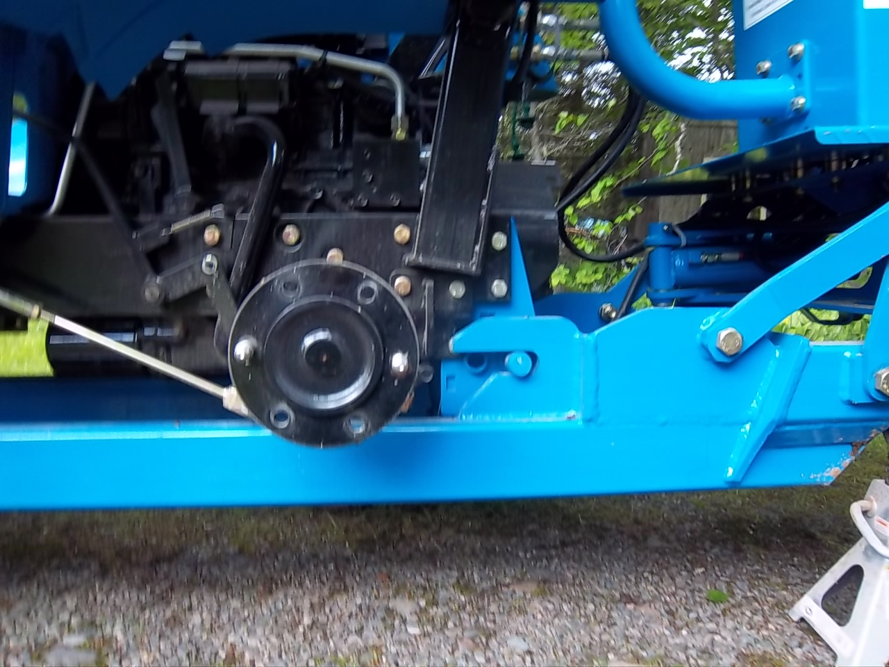

I'm trying to figure out a backhoe for my R3039.
Could those of you who have the LS backhoe post pictures of the subframe mount?
Do you have to remove the 3 point lift arms or stabilizer arms when backhoe is hooked up?
I'm not sure I can swing cost of new LS unit so I would like to see how the LS subframe attaches (hopefuly it is 4 point style) so can figure out if i can modify a subframe mount that is a close fit or fabricate one that I can then attach a used Woods BH7500 or similar backhoe.
I don't think I can buy just the LS subframe mount. I called around and it sounds like they are only sold with the backhoe.
Thanks for helping me figure out options.

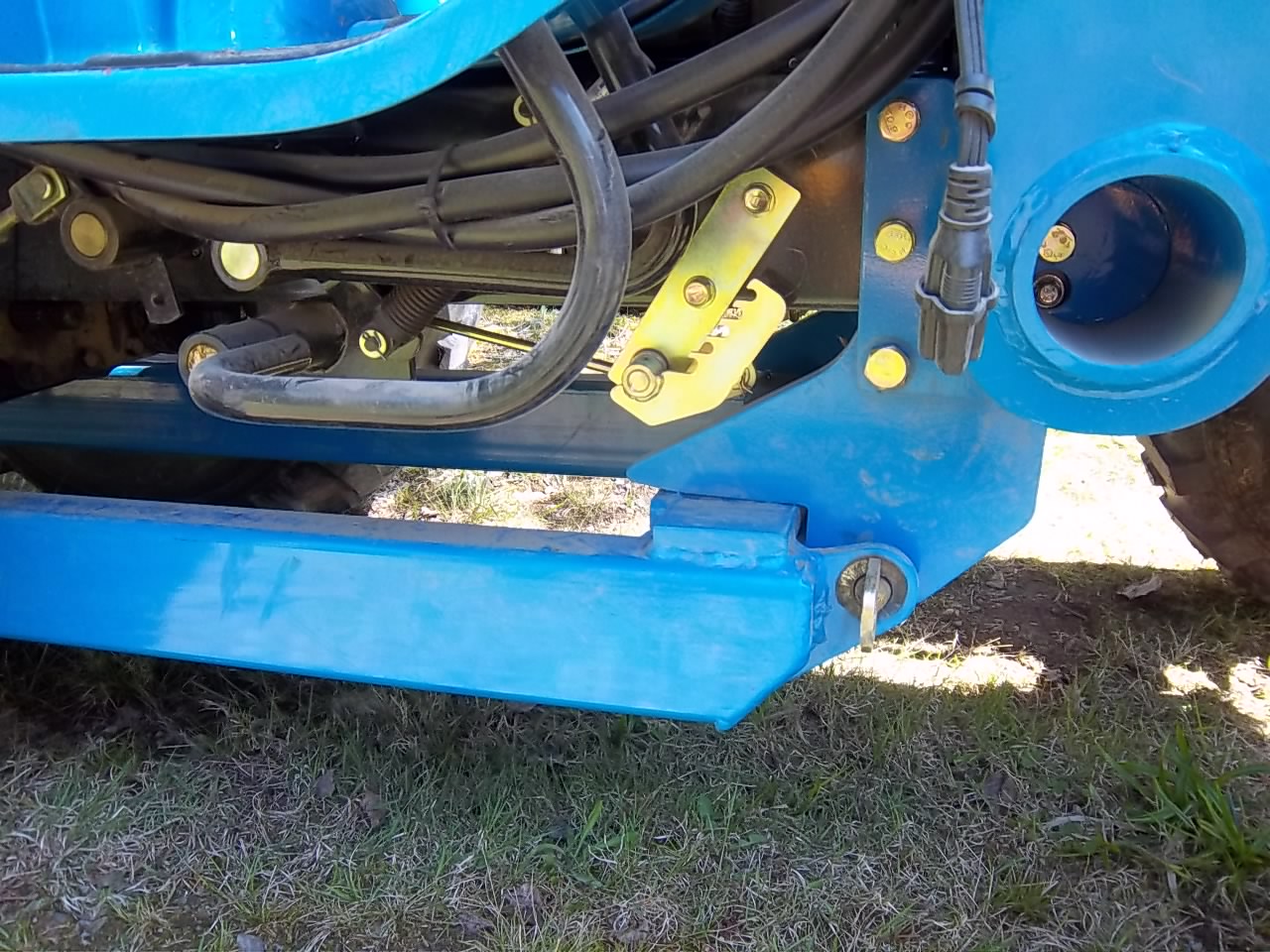

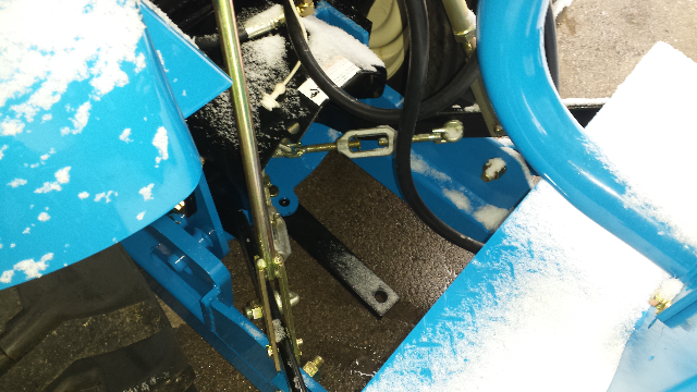

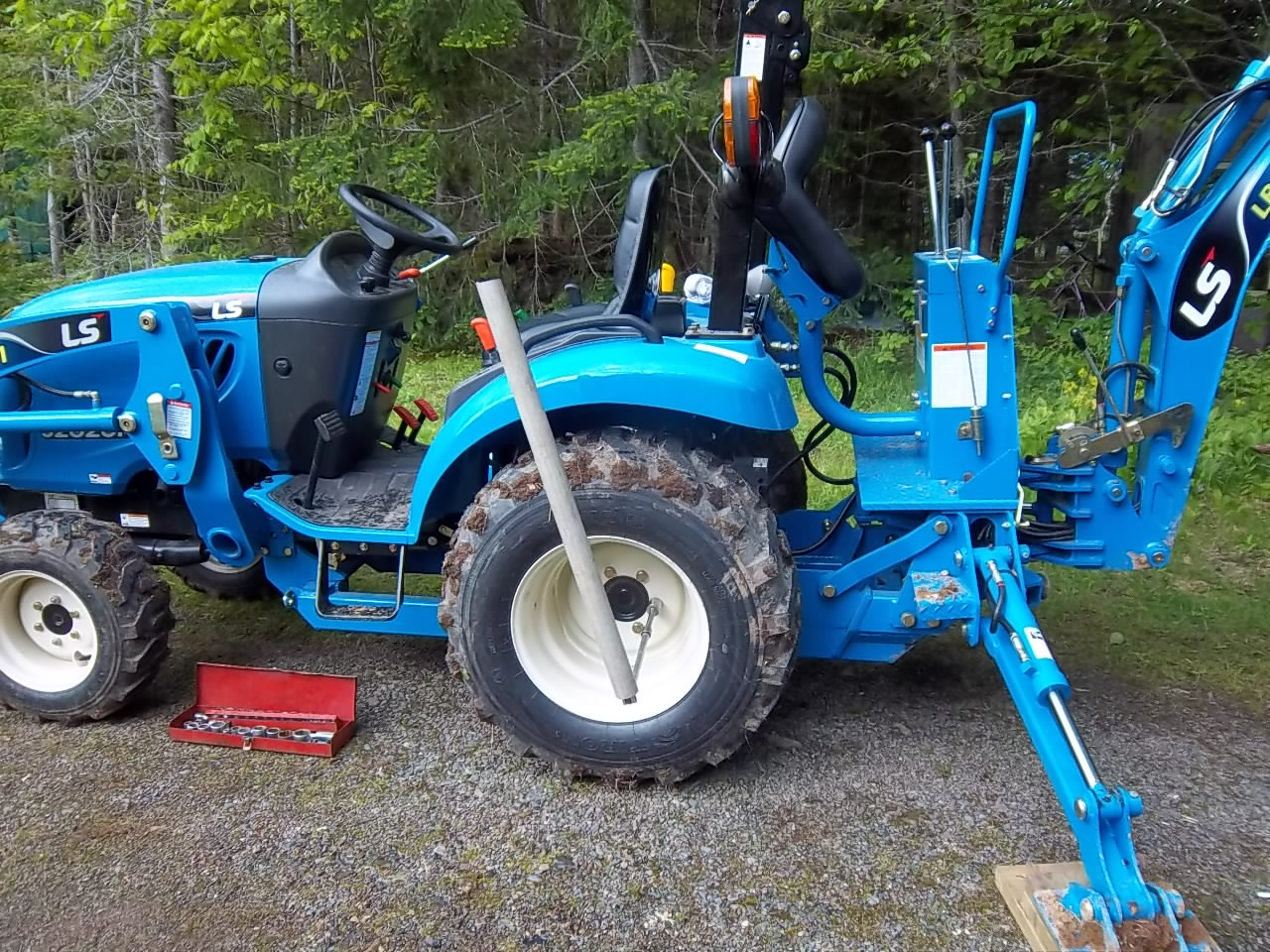

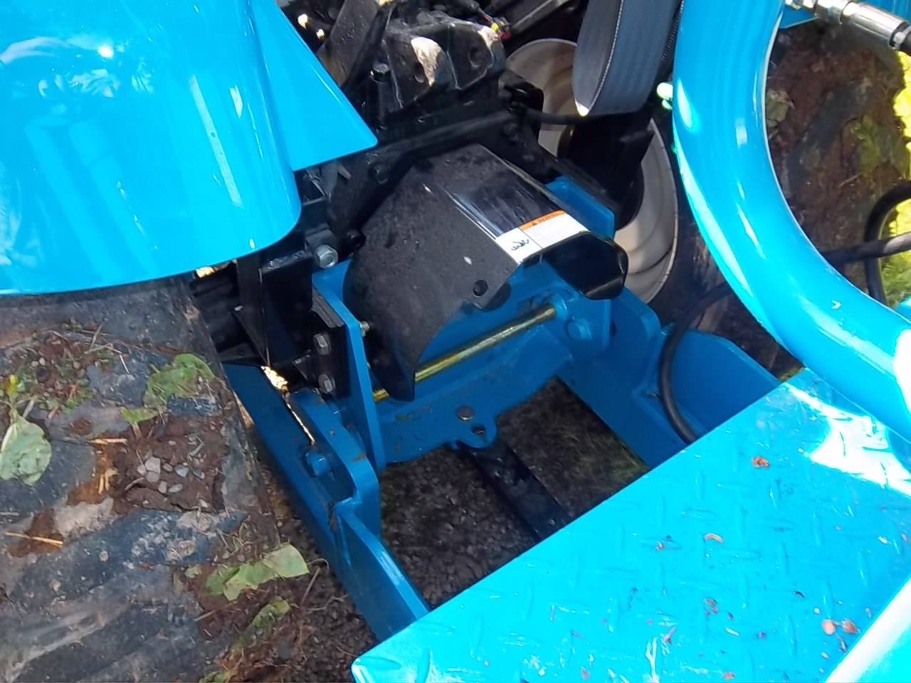

Cool! Thanks. That looks like the ladder style. Is there no ridigid top link used in that style?
Looks like the lift arms and stabilizers have to come off or was that only because you were installing it for the first time?
I assume it ties into the loader mount in the front somehow. Do you have a picture of that?
Thanks again! Good stuff!

Heres the front hookup.
Here's backhoe with lift arms and stabilizers on.
No top link needed.
Hope this helps.

What are the dimensions of the rectangle tube the subframe rail is made from?
In the front, is that some kind of a pin that runs thru to the other side to hold the front of the subframe to the FEL undercarriage?
No top link needed.
Hope this helps.

f
FRAME IS APPROXIMATELY 4inx2in
rear remote with indent kit
2 pins are used.
first 4 pics are front
last 3 are rear
Cheers
