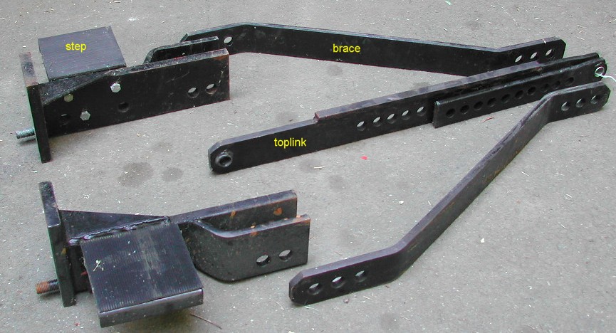

It looks like you could hook it up to 3pt. hitch directly ( or should i say traditionaly) but the extra 3pt. mount thing that usually comes on it adds a margin of safety to the tractor so the down sides (breaking castings) are minimised as much as possible.
   / LS backhoe questions. please post pics of subframe mount. #92
The extra parts you get with these hoes for mounting on the 3PH consist of a stronger toplink and 2 braces
between the toplink and the lower arms. The latter parts keep the whole hoe from rising independently of the
tractor when you put the outriggers down. Or dig in a way that puts upward force on the hoe.
It is unsafe to operate a hoe on the 3PH without the braces, as the operator can get squished
between the hoe and the tractor when upward force is applied.
I have a bunch of extras from all the Prairie Dogs that I bought in years past.

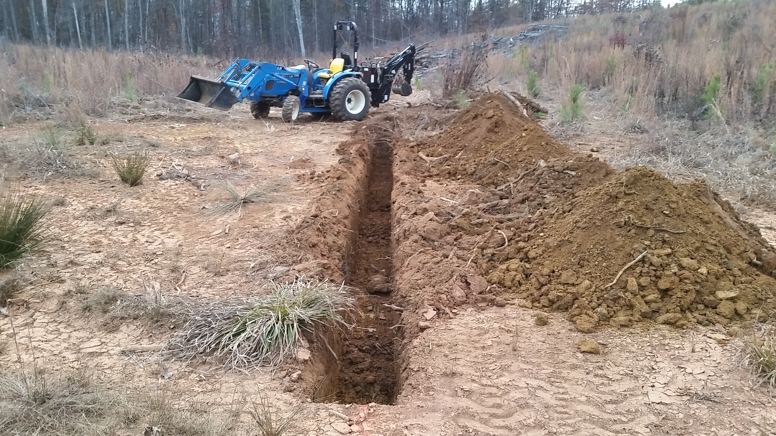

Just an update. So far the backhoe subframe mount I made is holding up well. I have well over 10hrs of solid digging time on it.

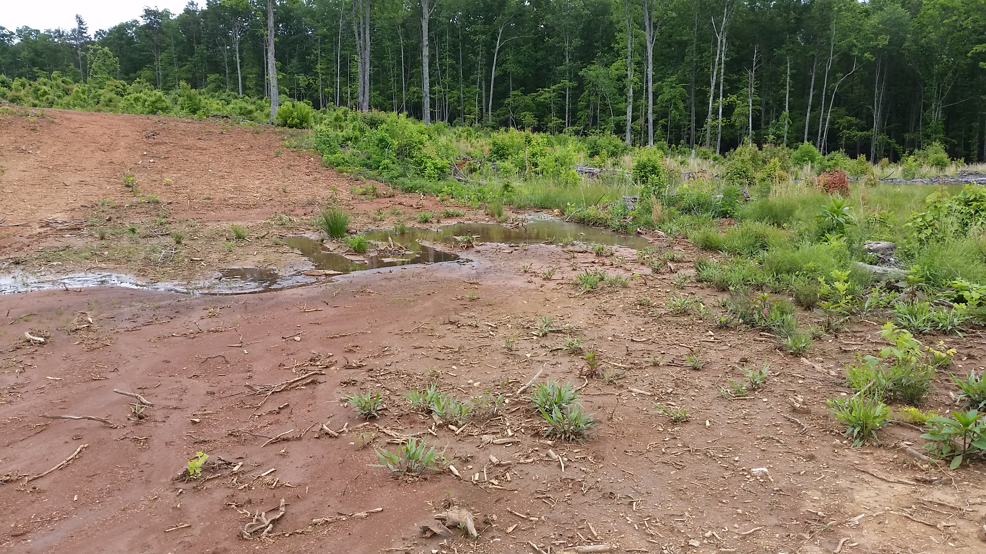

I had a low spot that would back up with water due to the skidder trail pic in the previous post ... it would get worse than this:
... some will remember that's the same spot my dump truck got stuck and had to be pulled out by a track loader!

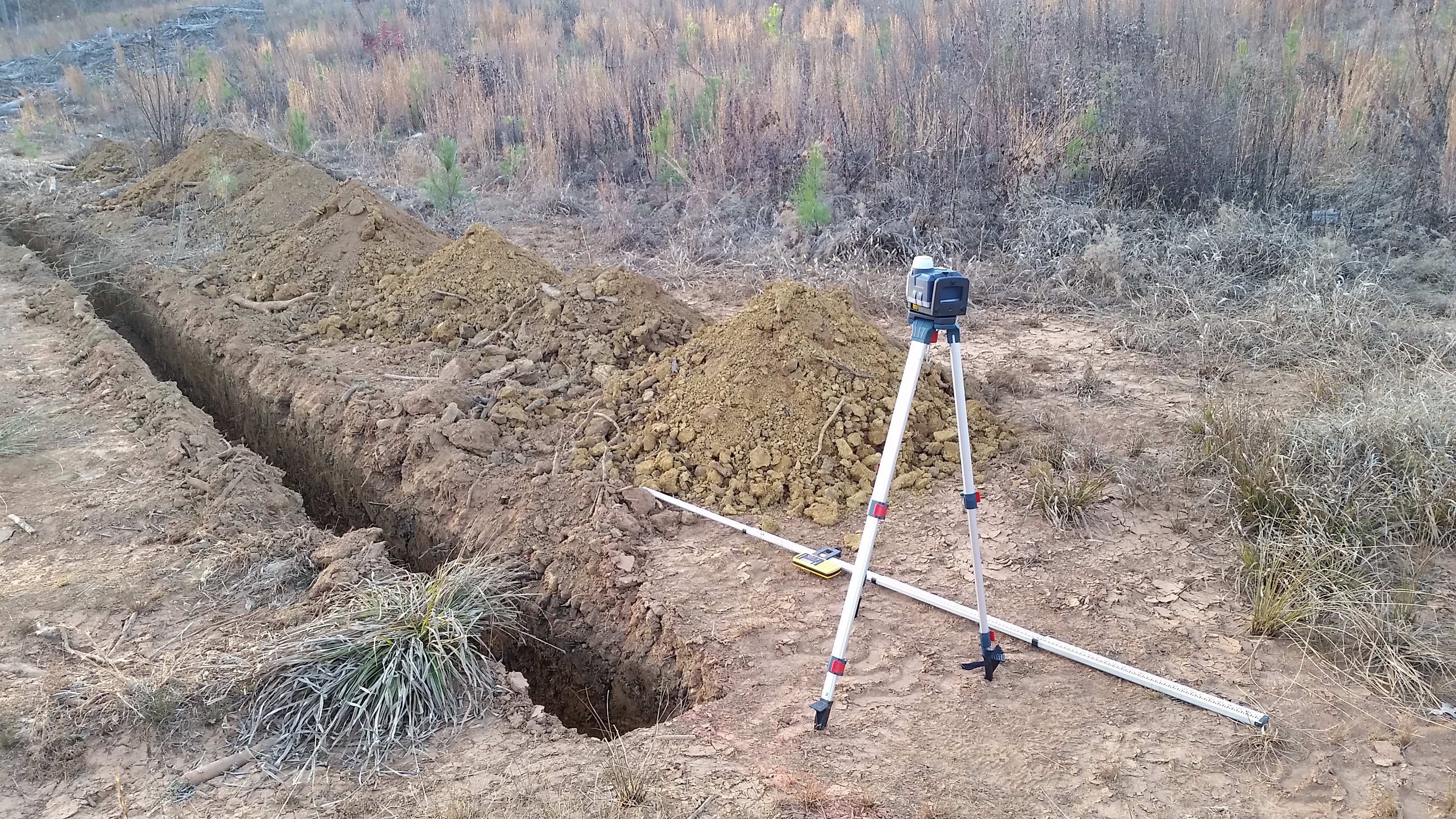

Got the log jam cleared and dug an outlet ditch for a culvert that eventually just runs out on top of the ground at a lower grade:

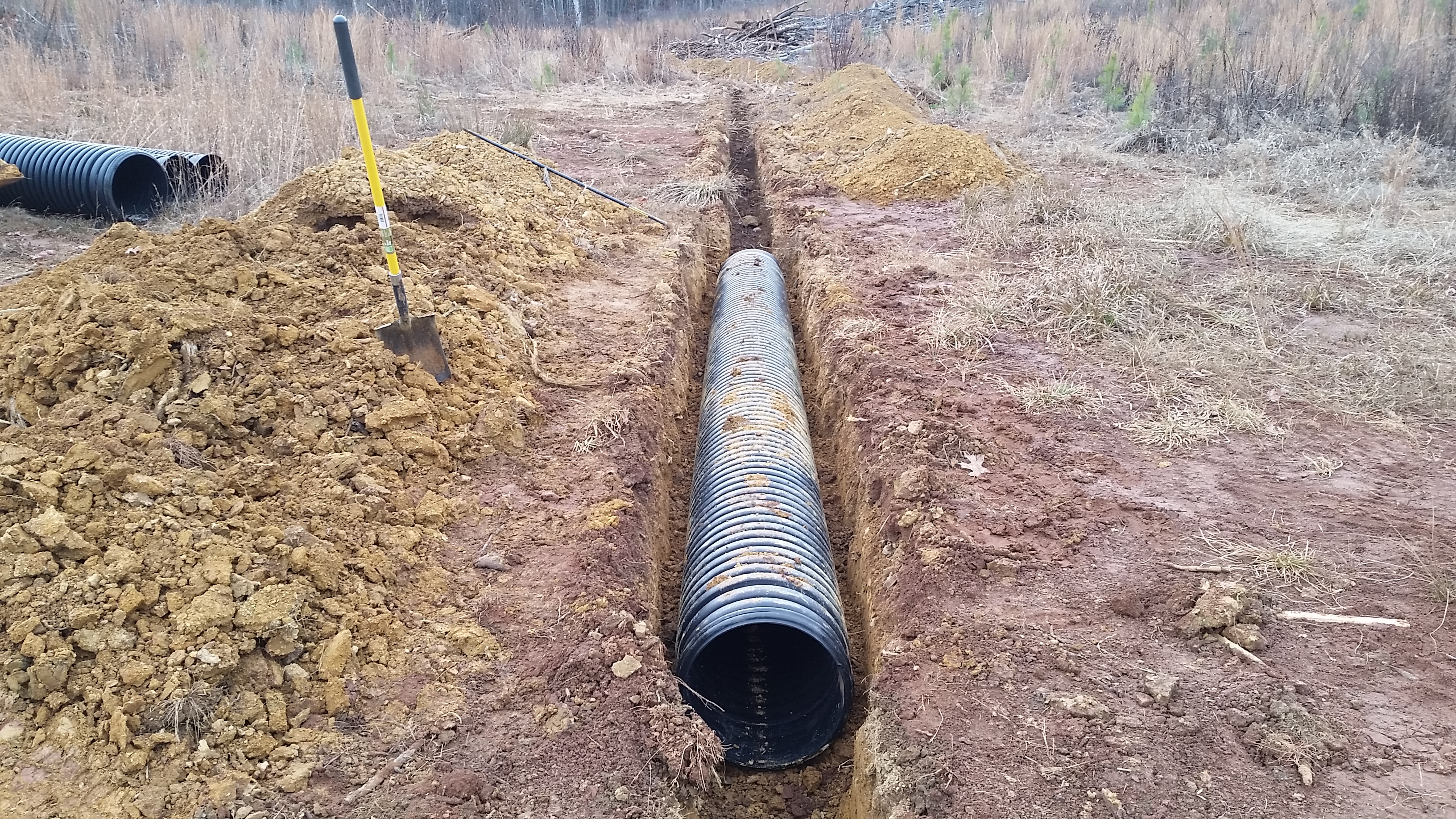

On the 18" culvert, I hand shovelled loose dirt and tamped it in layers 1/2 way up the pipe and then back filled it (until I broke my curl function on FEL :( ).
Oh, that's a fiberglass handled Harbor Freight shovel that doesn't suck in the last pic. All of my old inherited shovels were short so I picked up the long handled one spur of the moment while getting tow chains during the red tag sale.

Is that gonna be enough cover for a plastic culvert, HUTCH?
#98
It's hard to tell from pic but it's about 6" on one side and almost a foot on the other (the slope of the pipe isn't that great though ... it's only like 10% or something ... so the outlet is about 4" lower from inlet - it's a smooth pipe on the inside). When I'm finished building up that area (when loader gets fixed) I'll have more than 1ft. on top and everything I've been told and read says 1ft. of fill on top will handle pretty much anything. I tend to over do stuff so I'll have more than what I was told on it.
Going to armour the inlet side bottom and sides with riprap and the outlet bottom with riprap too. This is totally overkill as water isn't normally in this area unless it really rains good. I built it to handle worse case like a hurricane that dumps 5-7" in an hour (hey, it's happened here before). I don't want to get cut off if/when something like that happens.
anything.
I have never worked with plastic culvert myself; only steel and concrete. They all required a minimum of
12" cover. I figured plastic would require more cover, esp for larger pipes and heavy traffic.
