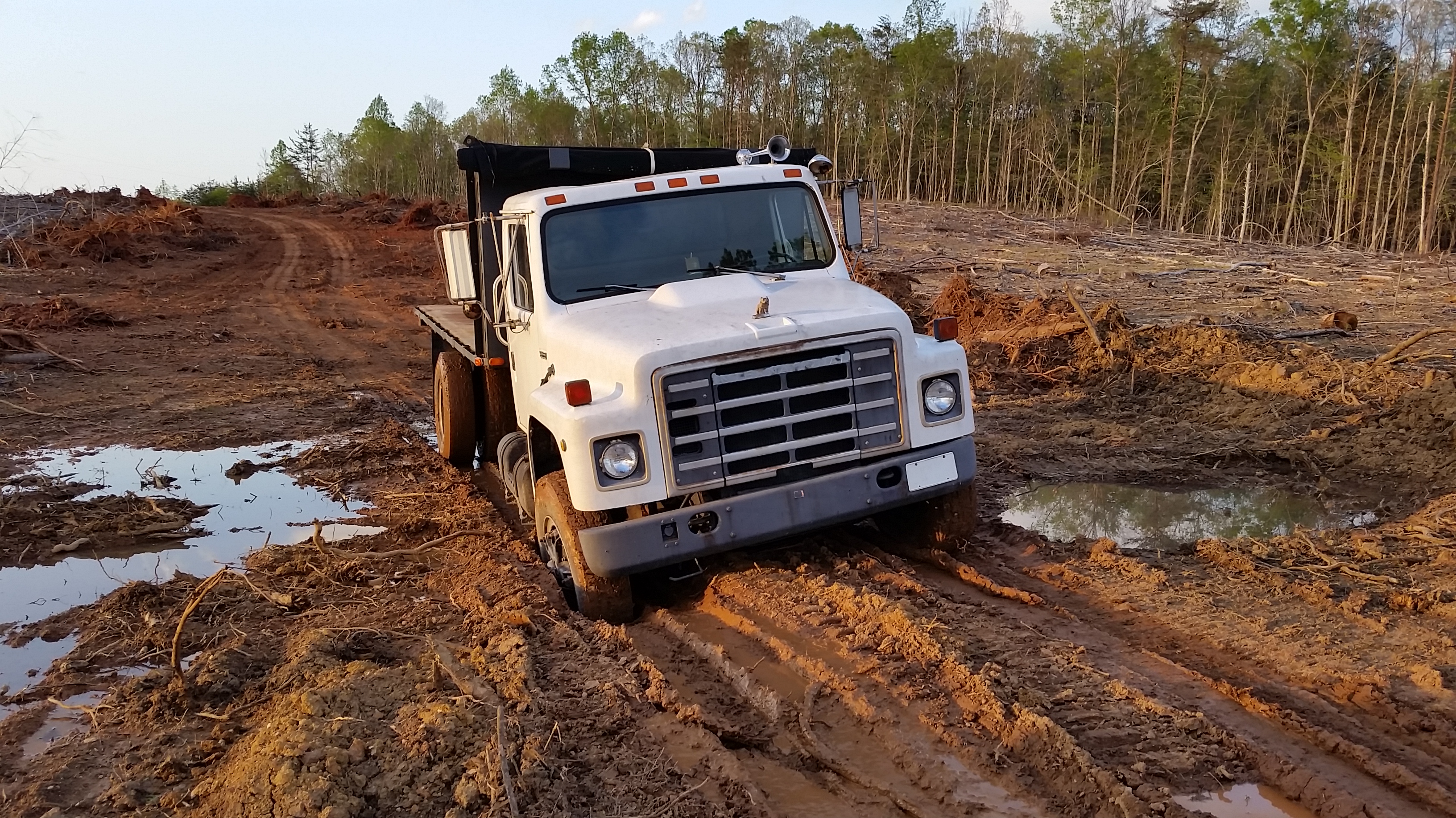

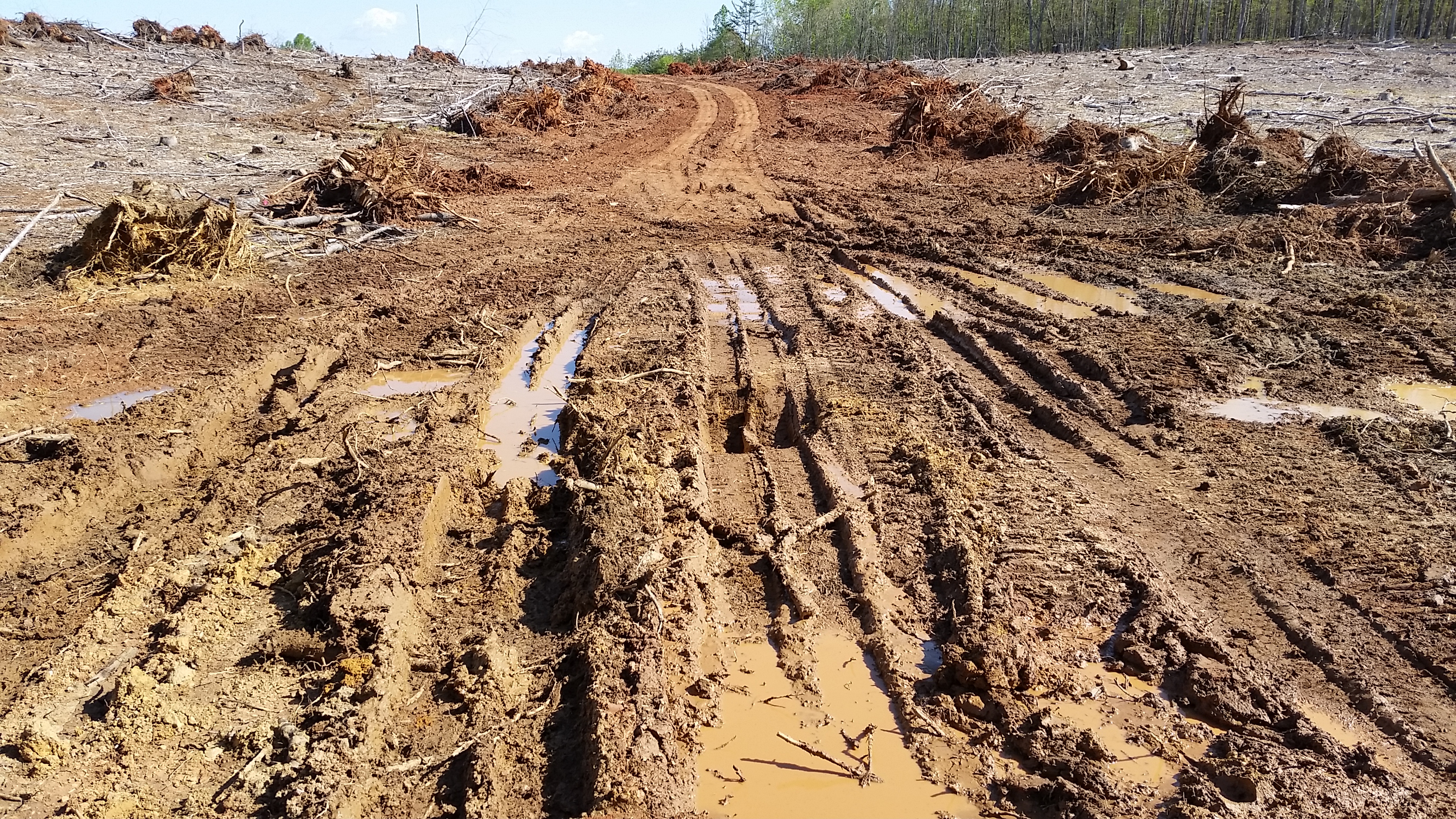

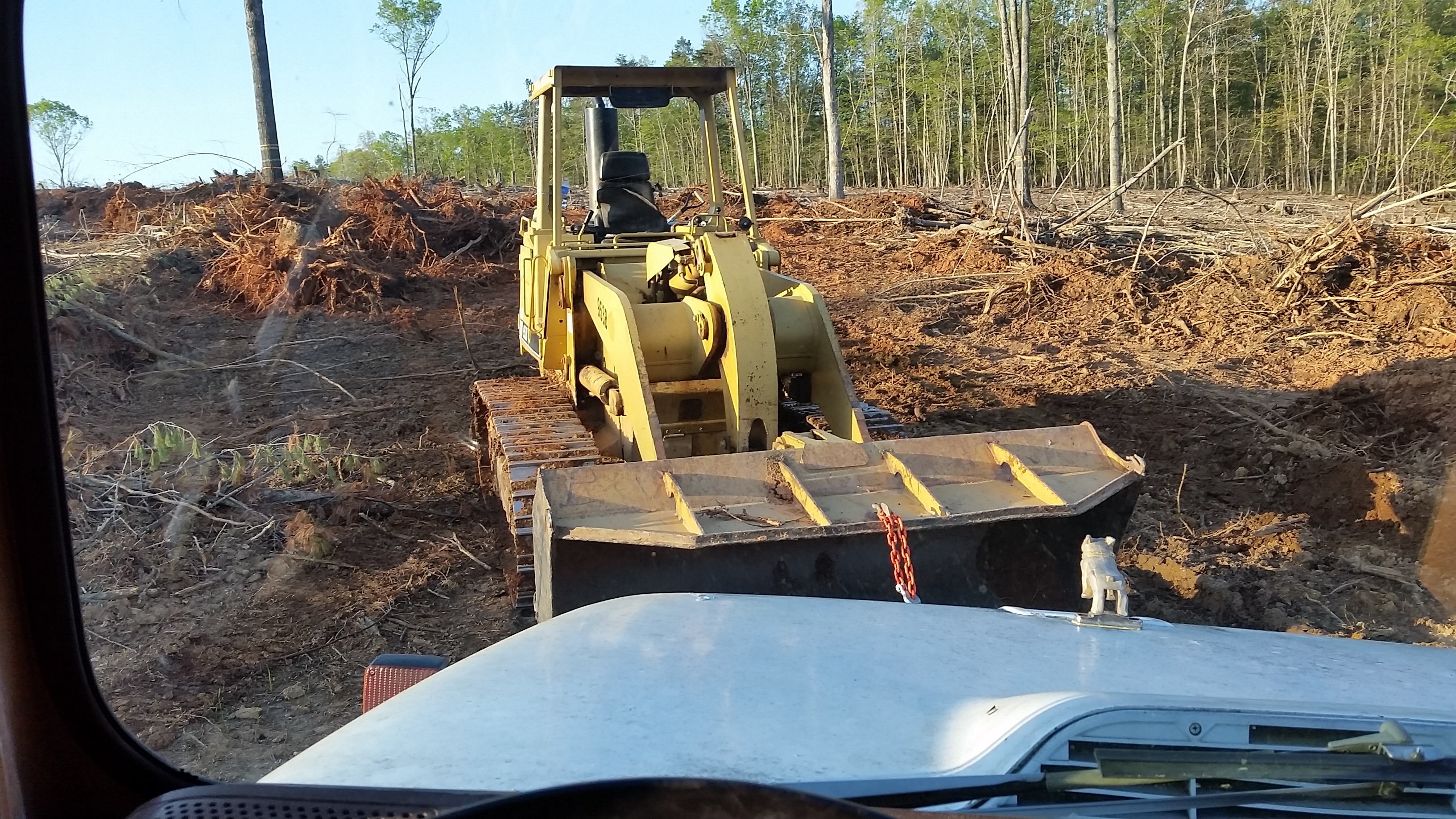

Really need a culvert here bad!!! I sunk my dump truck in that hole. I was working with excavator last year and he has a much bigger dump truck than me ... he stuck his in that hole first. Then I miss it but couldn't make it up the hill due to my tires being clogged up with clay so I backed up to try and get another run at it and when I did I fell into the hole he made then he had to come pull me out with the CAT.
