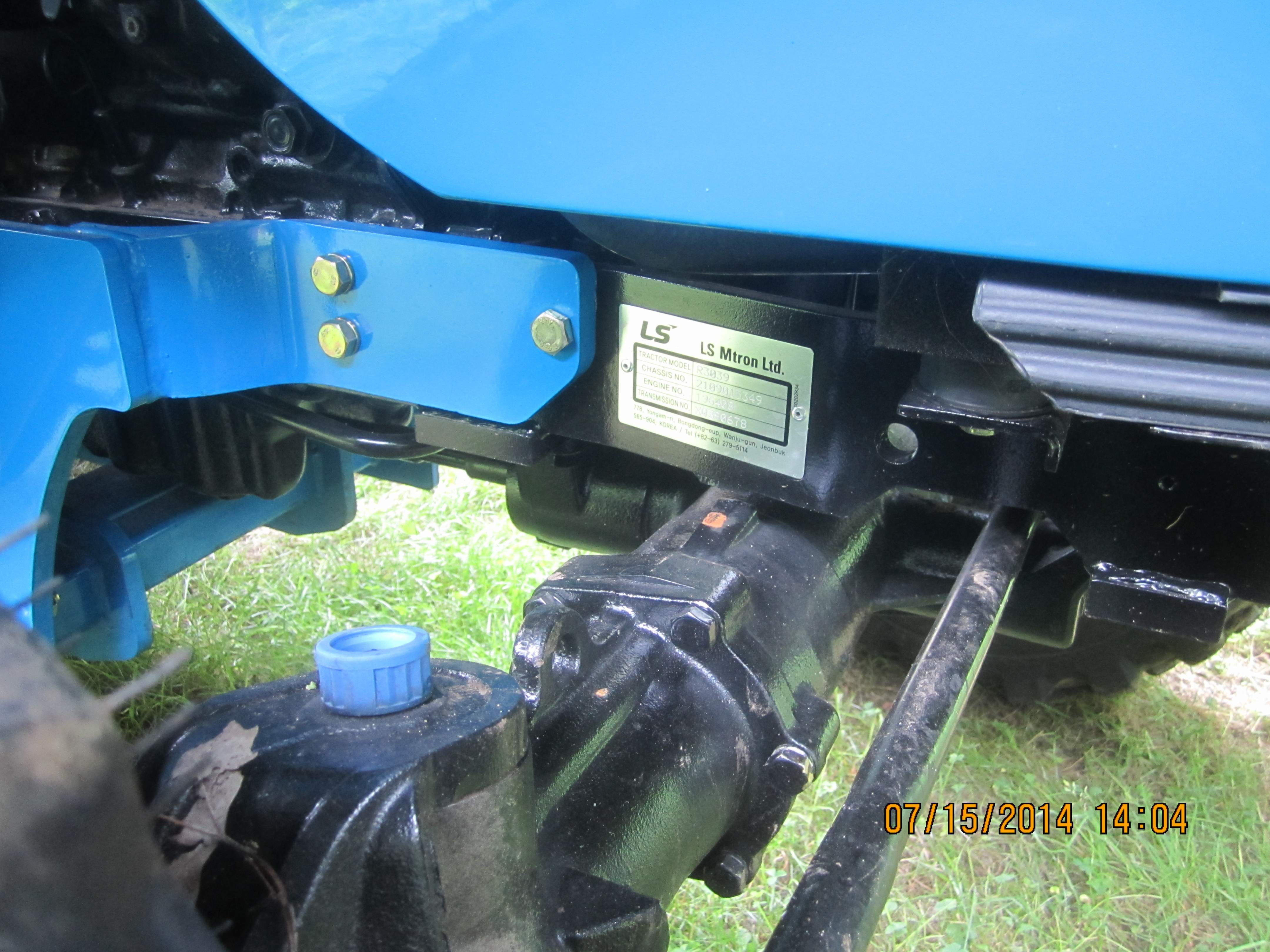

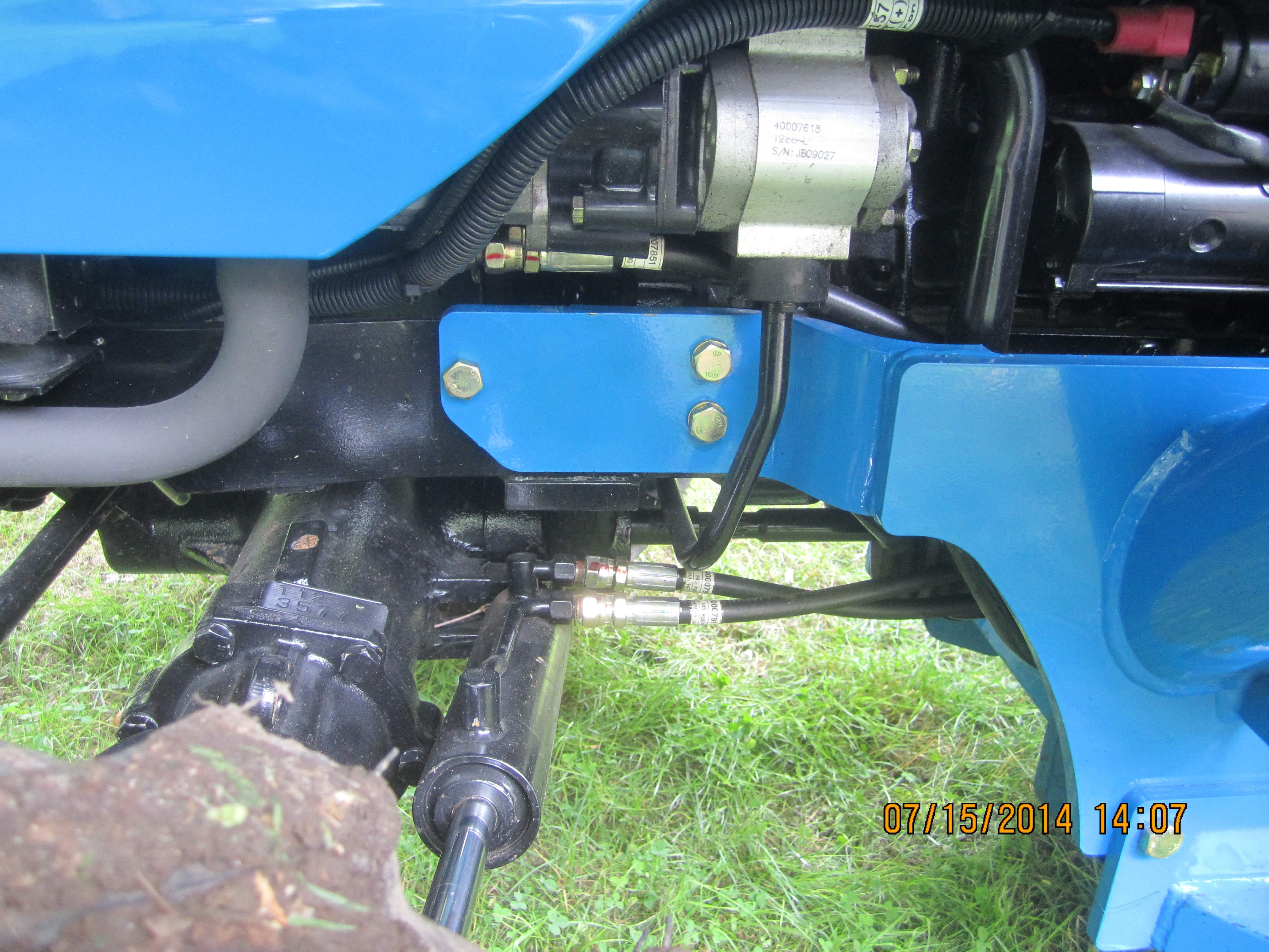

IMG_1940.jpgIMG_1939.jpg It appears that the one I just purchased has had the same procedure done to it. I hope the pictures come out.
I was comparing to the pictures of magnus580. I think like some one else mentioned the loader puts a lot of stress on that area and it needs beefing up. Now that I am looking closer, it looks like mine is a little different. But same idea. I am confident the redesign/ repair will resolve the problem.
Also I know it is a frame, but to me it is about 1/4 flat stock tying the front end together as a reinforcement. Some tractors don't have that and there is no frame / reinforcement, just the components bolted together. But I am no expert.
My feeling is it was a design flaw and the redesign of the loader brackets will solve the problem however I am going to be watching this closely.

I'm about to purchase a 3039 today. Is there an easy way I can verify if the upgrade has already been done? I've tried to study the photos but it's confusing.
   / LS Frame Issue Video #120
The pictures are of the frame area just above the front axle. The blue loader frame originally ended with the the two bolts you see in the pictures (one bolt on top with another just under it in line). The new loader frames or tractors that have the reinforce kit have a thick blue plate (or solid metal in the case of the new loader frame) that runs beyond the two inline bolts and ends with a single bolt. Hopefully that explains the pictures a bit better.
I guess another easy way to say it is if there is not 6-8 inches of blue metal between the top/bottom bolts and the data plate on the frame, you don't have the fix.
